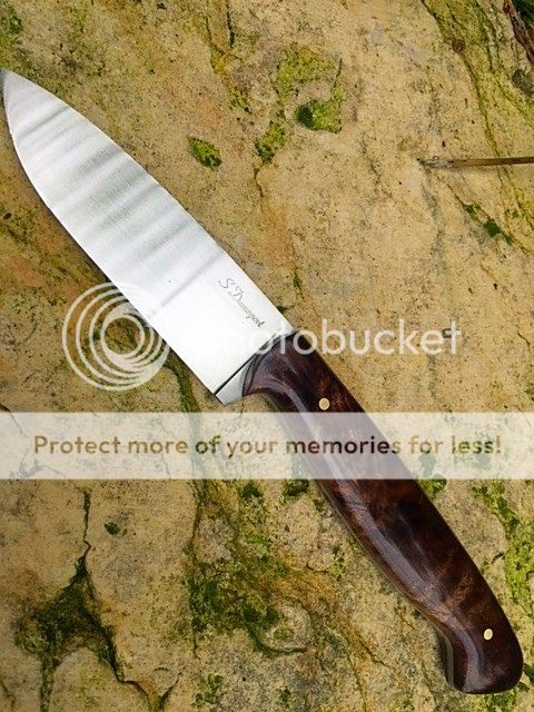

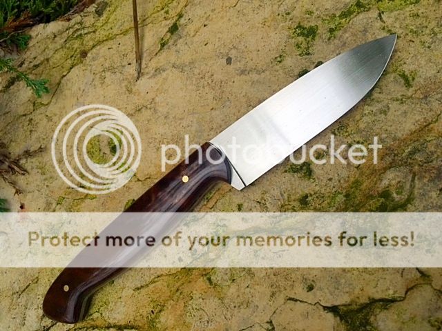

Now THIS one I am very excited to post for sale here on Bladeforums! The grind on this one is just superb, especially towards the business end of the knife.....the edge! Think apple seed or tear drop shape. But not heavily convexed. I'll even tell you how this was achieved! First, pre heat treat edge was taken to .020"...a safe enough thickness for carbon steel in an oil quench. Post heat treat, the edge was sharpened at an extremely low angle. I have no idea what it was, but the spine was just off the stone. That edge bevel was taken all the way to apex, to where edge on there was almost no light reflecting back. Then I blended the shoulder that was created by that low angle sharpening into the blade flats during the post heat treat finish grind/polish. The final edge bevel was put on at around 30° inclusive (15° per side), and you can barely make out the actual edge bevel! It took no time at all to create that edge, and I started on a 600 grit stone, alternating sides every stroke, minimal burr formation. Final grit was 8000 JIS. The knife is just incredibly sharp...and very thin towards the cutting edge. This is NOT the hunting knife that will double as a camp knife, for sure. This is the kind of hunter you use in the kitchen to scare the daylights out of a tomato! Ever seen one of those thin edge grind that when you touch it, the edge sort of "rings"? Yeah...that's this one!
OAL: 8.5"
Blade: 3.5"

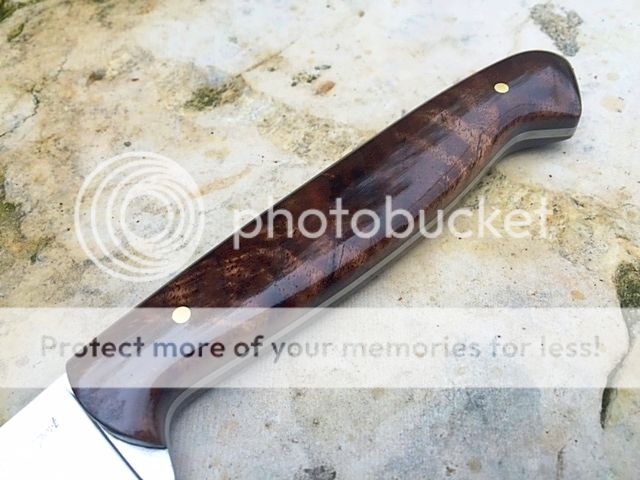

Handle: 5" Crotch Walnut, Tru Oil (pores filled), went with a "gloss" finish this time
Steel thickness at ricasso: .105", tapered to tip
Edge: 15° per side, 8000 grit waterstone
Sheath: basic kydex with chicago screws for tear down/clean up​
It started drizzling on me during the photo shoot, so you might see a few tiny rain drops. I do apologize.
Yours for one low payment of only SOLD, including shipping and handling to the lower 48 states. If you live elsewhere, just let me know and we'll figure out shipping charges. Kydex sheath included, of course. Thanks for looking!

Wow. Beautiful slicer. Especially great finish on that walnut.

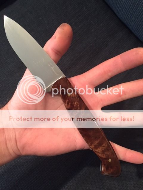

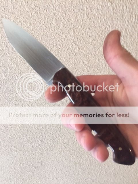

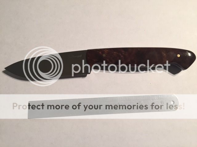

Is it possible to see a picture with a reference for scale? Or perhaps an in-hand shot?
This knife is really beautiful.
Cheers,
Andy
Please excuse the crummy quick photos and the grimy hands. My fingertips are always chewed up like that from sharpening knives and testing sharpness. Hopefully this gives a better perspective on the actual size of the knife. The handle is made to accommodate a gloved hand. A manly hand....not girly one!
Walnut is spectacular. Really. WOW.
Blade looks phenomenal, too. Can't wait to test mine out on the first deer, this year.
