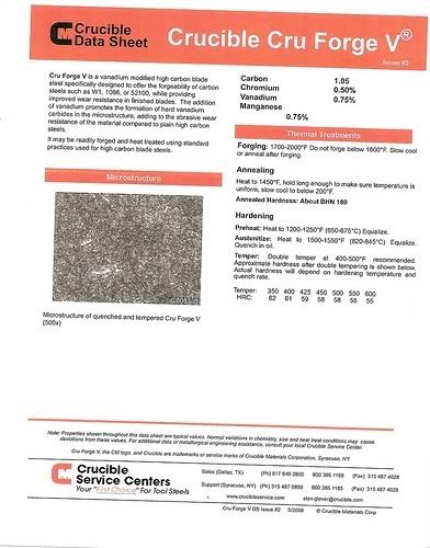

I bought some Cruforge V from Knife and Gun finishing supplies but when I went to heat treat it it hardened to HRC 66-67 instead of 62 as the data sheet suggests it will and the hardness/tempering temperature relationship is very different (i.e. HRC 63 at 500F instead of 58. . .). Of course this is better than expected, but I'm questioning if it really is Cruforge V. It deep hardens and works like I would expect. From the alloy composition (1.05% Carbon, .75% V, .75% manganese, .5% Chromium) I would expect it to reach mid/high 60's HRC like it did and not top out at HRC 62. Have any of you who have worked it noticed this, or does it tend to stick to the Datasheet relationships?
I did a 10 minute soak at 1500F and quenched in oil.

I have made quite a few knives from Cru forge and what i have found is that because of the V content you really have to experiment to what works for you in your shop. I personally soak for 5 to 10 minutes at 1475 (depending on blade thickness) and quench. Then the first temper is 1 1/2 hours at 425, do a rockwell test and then adjust from there. I typically temper Cru Forge 3 times. As quenched hardness hovers around 67 and i like it to end up at 58 to 59.

Nowhere on the spec sheet does it give an as-quenched hardness.
It does, however, recommend a double temper, and at 350, the resultant hardness is 62.
That is not as-quenched hardness.
To double temper down to 62 would suggest a higher hardness to begin with. ;)
It does not suggest a "soak" either.
It only says to: "Austenize - heat to 1500-1550. Equalize. Quench in oil."
This is what Dan Farr sent me back in 2009:
"My heat treat schedule
1 - forge to shape, heat to red and stick in vermiculite.
2 - rough grind/ mill shoulders
3 - normalize 3 times. cool to room temp between heats.
4 - heat in furnace at 1500 for 10 minutes. quench in oil.
5 - cool to room temp, put in freezer until cool then in Liquid N2 overnight.
6 - 2 hour temper at 410
7 - use torch to draw back to blue with edge in water. cool to room temp. repeat for 3 times total.
8 - 2 hour temper at 415
9 - 2 hour temper at 415-425"
Since Dan is pretty dependable, and was in on the creation of this steel, it just goes to show you how easy this steel is to get along with, as his process does not precisely follow Crucible's.
Do notice that neither he nor Crucible specify SPEED of oil - just "oil". :D
And with only enough heat to "equalize", it will give you a blade of 62RC with a 350 temper.

Oh it's awesome stuff! So easy to work it's ridiculous for its performance. I wasn't picky about the oil as I read thoroughly about the steel before I worked it, but it was warm canola and therefore quite fast. Shouldn't matter there though but I thought it might help to have a faster quench for RA reduction considering the C-content if it's not picky one way or another. I agree that they didn't publish the as-quenched data, but at 300F it didn't drop but 1-1.5 points from 67. The tester was calibrated. The grain size on it is amazing with a triple normalize after careful forging/reducing heats and quench. Beautiful stuff. It is tough enough at 63 that it will make a sick laser gyuto chef knife that doesn't have to be coddled, which is my purpose for it.
Apparently the forum doesn't like longish replies right now as I had to cut it in over half to post. The essence of the rest of what I was going to say was that I think Karl is right-on and that with no soak it must have a lower hardness value. I've experienced this with 1095 and other hypereutectoids so it would make sense. If soaked or temps are increased more carbon can come into solution.

Karl , the 10 min is the soak. Fairly short as it is it still is needed to dissolve the carbides.
