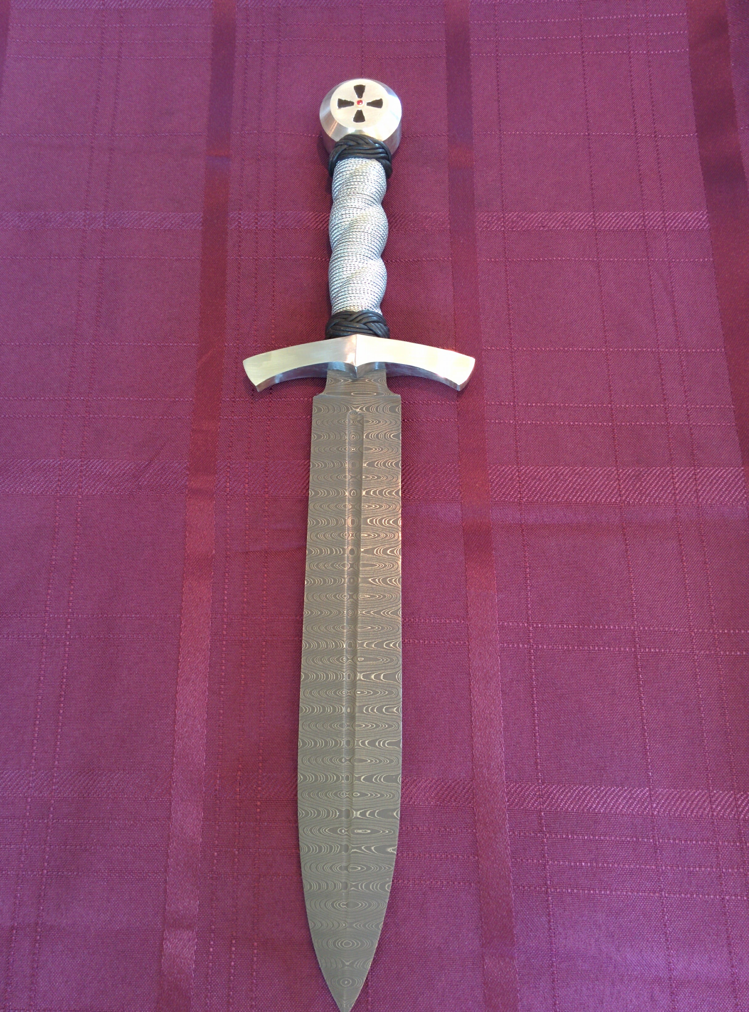

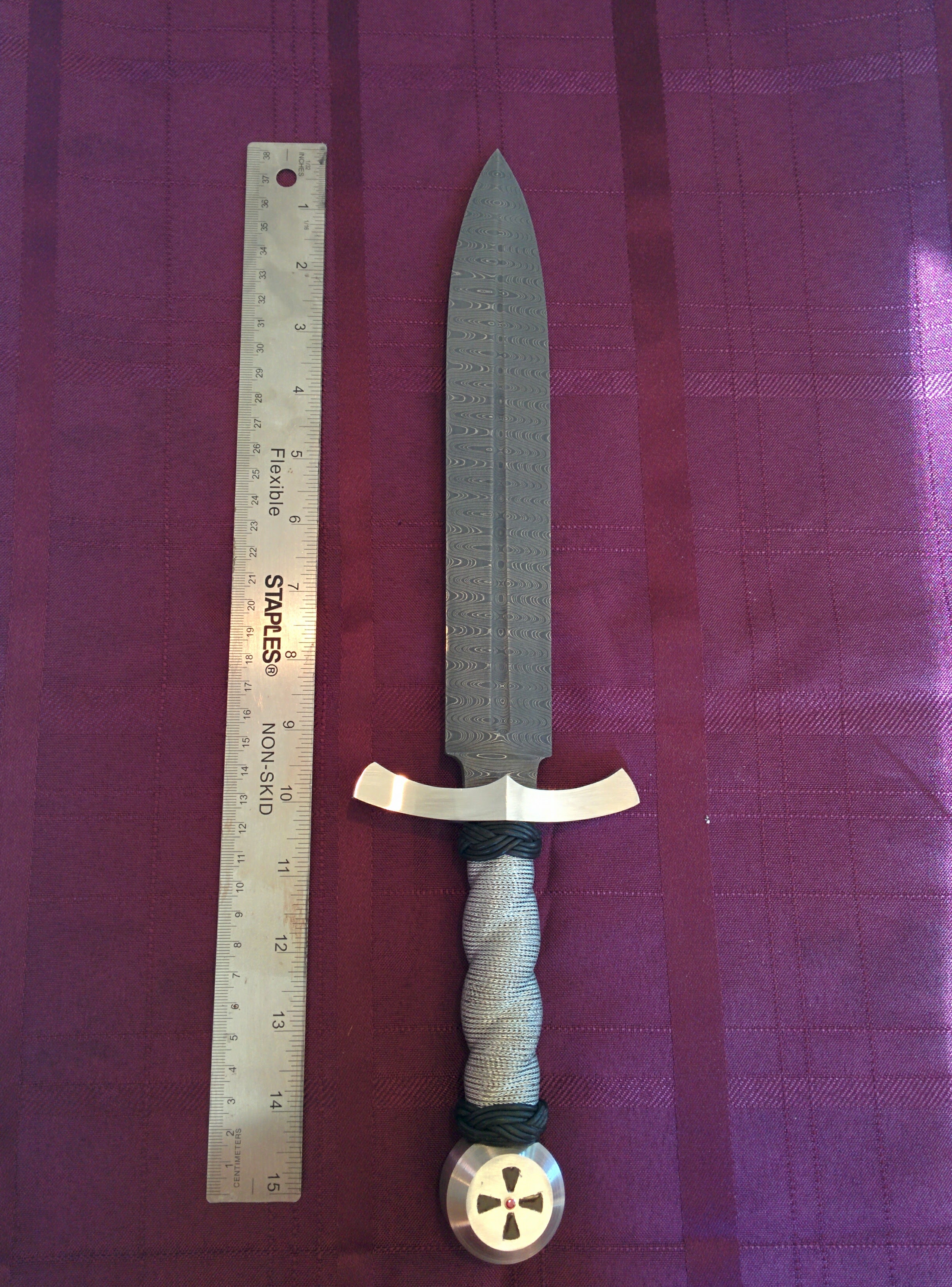

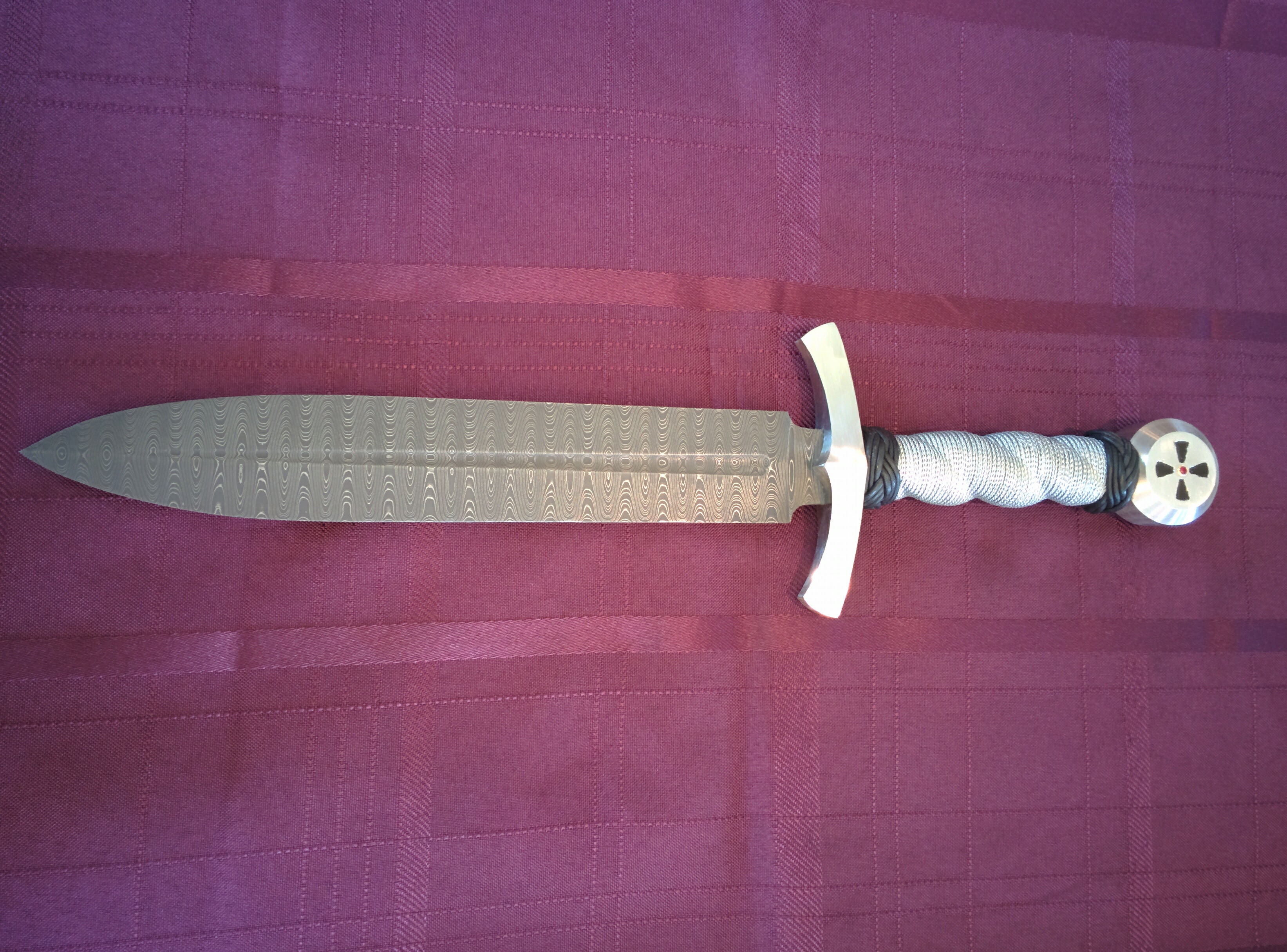

I just finished the dagger shown below and am pretty happy with it.
This is my first use of damascus (Devin Thomas ladder) and the handle was made following Salem's wire wrap tutorial. It took a while to make all the parts a few free hours at a time, but I was pleasantly surprised at how it all fit together.

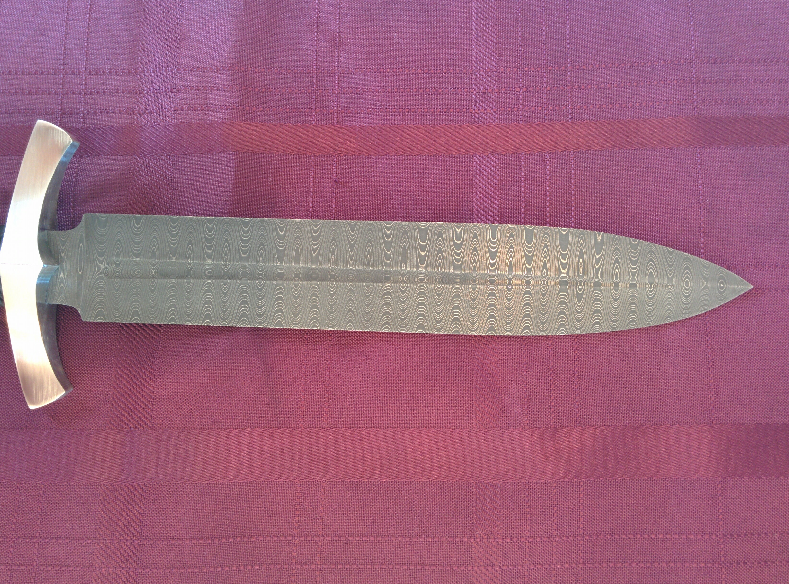

I'm not sure if I etched (FeCl3) the right amount of time as it turned out a bit darker than I expected.

After the etch, lightly sand/buff with a very fine polishing paper like the pink or mint color of 3M polishing paper. It will remove a bit of the excess oxides.

Stacy, I'll give some fine polishing a try (I think I bought some of those 3M papers based on another thread of yours about prepping surfaces for scrimshaw).
After etching for perhaps too long, I rinsed with water, then Windex. After all that I dug up an old thread by Kevin Cashen which prompted me to then boil it in baking soda for 15 minutes and apply some light oil.
I'll see how the 3M paper does.
Thanks Stacy, great tip!

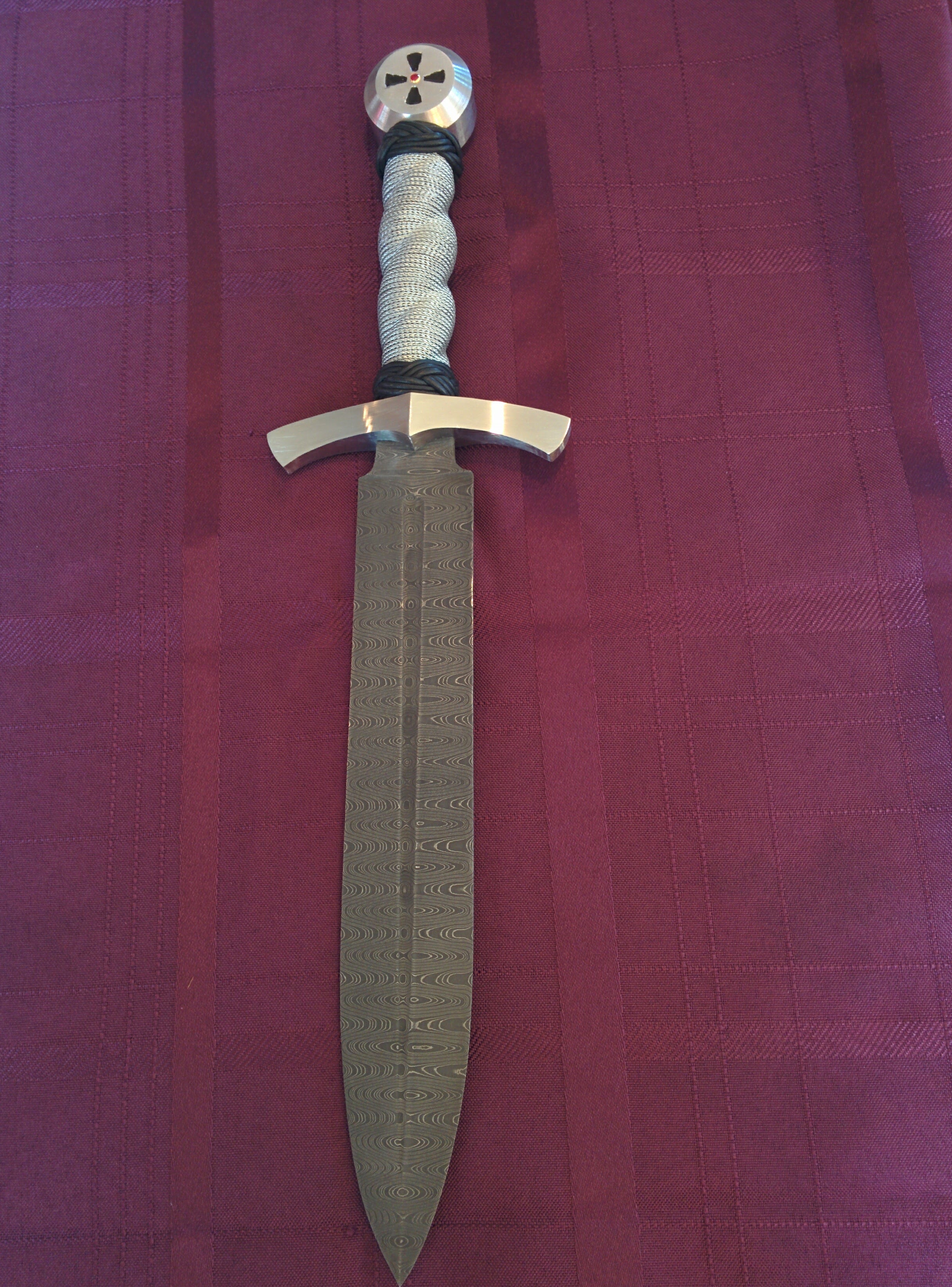

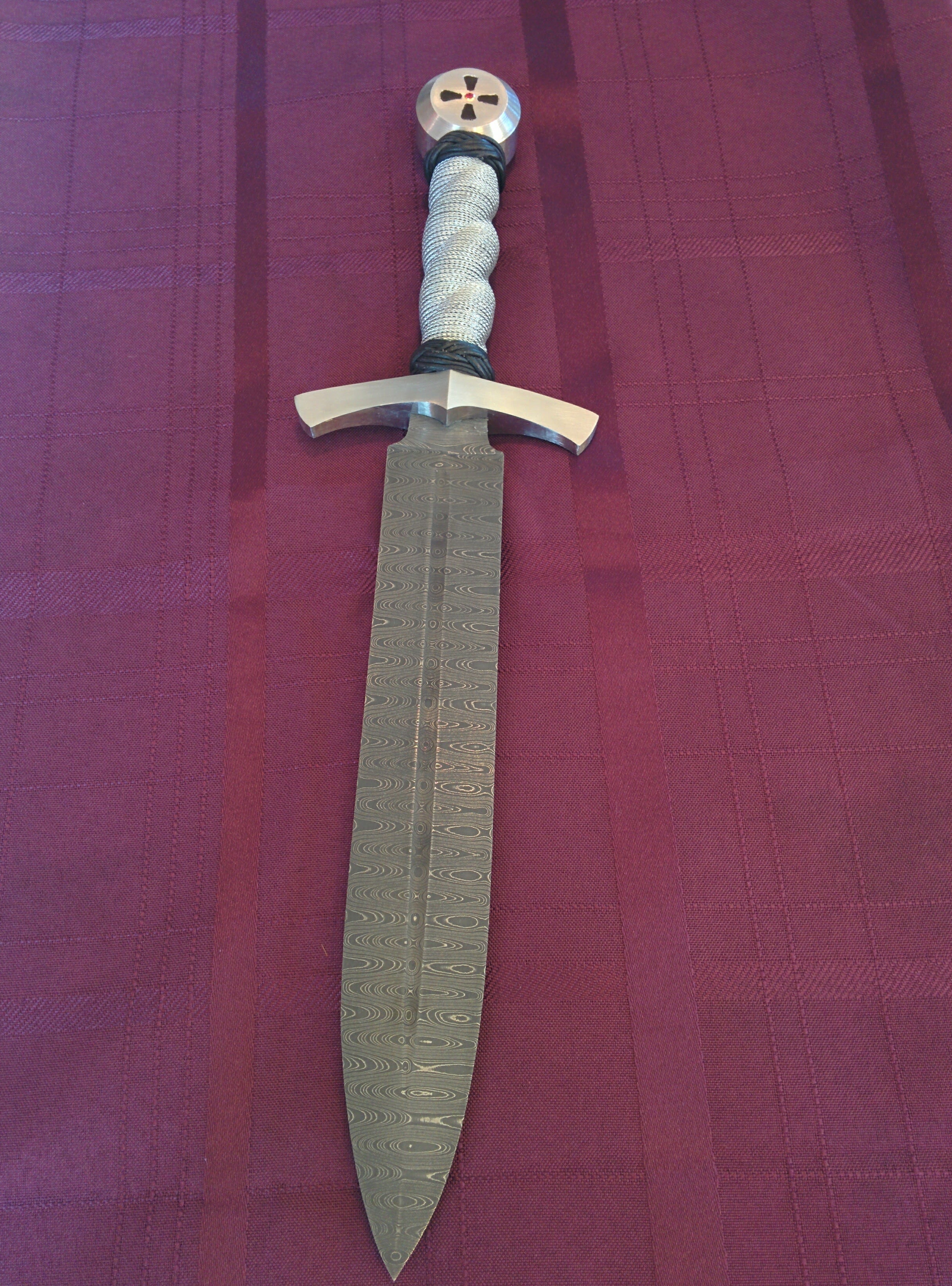

I don't know how much comes through in the new photos, but 2 mins with the pink 3M paper (4000 grit) made it really come to life.
Yep, I love those papers. Makes damascus sing without sanding away the pattern.
