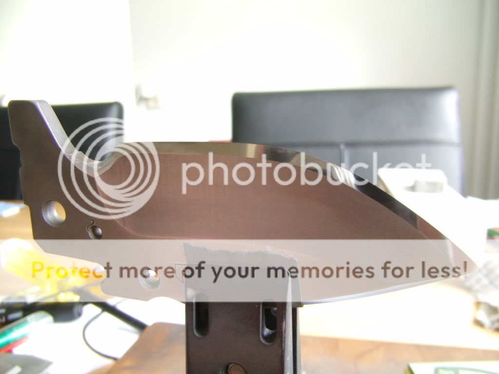

i'd like to hear how the blade performs once reprofiled, there's a pretty insane thickness overal and ,more important, behind the bevels for such a small blade. i wonder what uses can command such a blade.

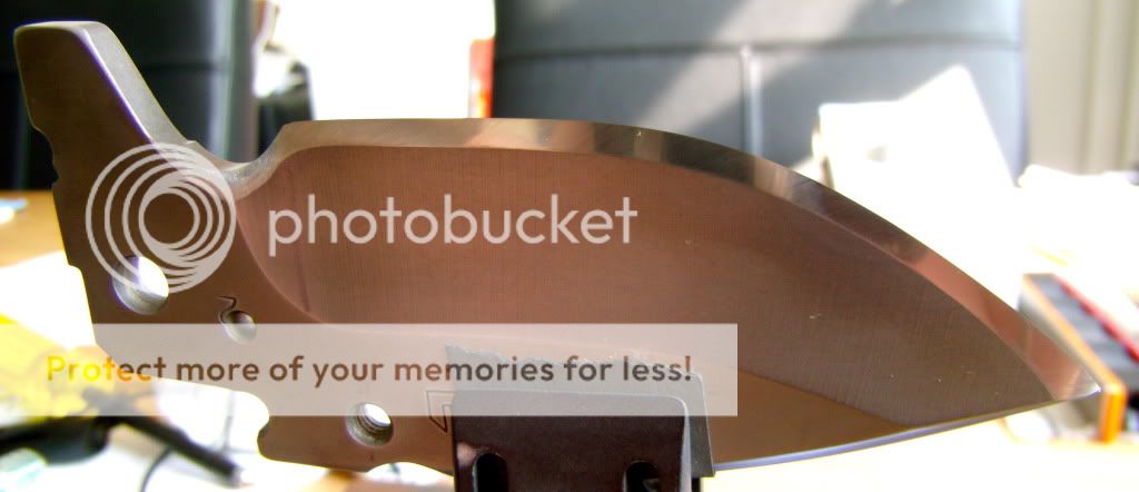

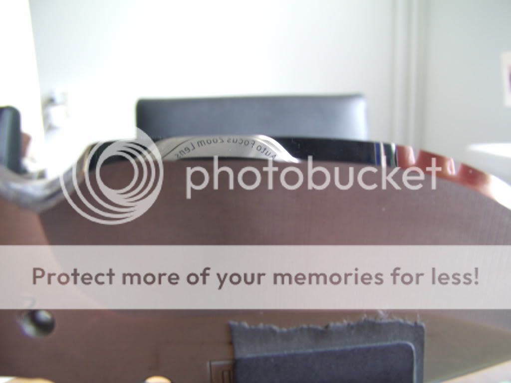

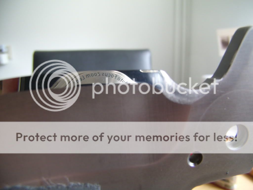

After the 1500 grit wet & dry paper taped to the stones;

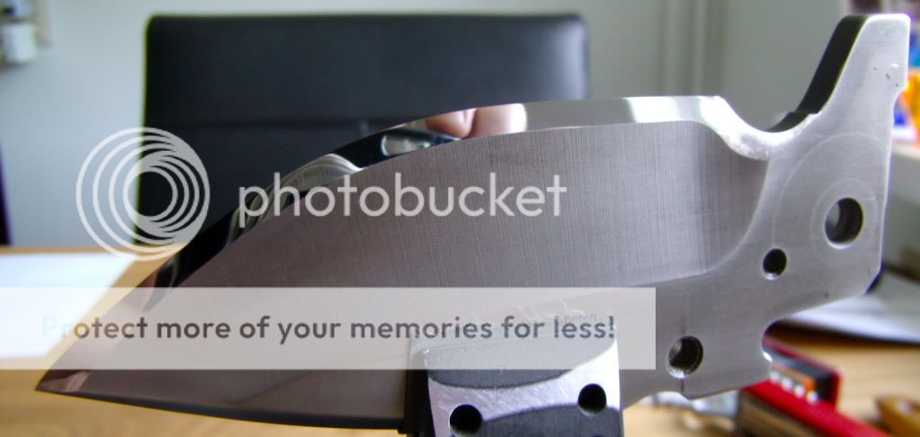

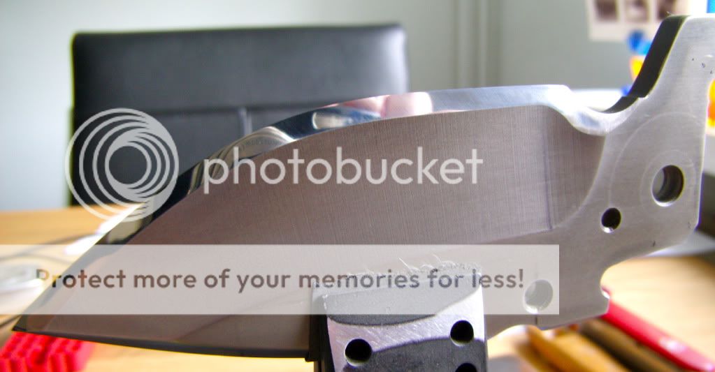

After 6 micron (3000 grit) diamond polishing paste on the backside of the earlier used wet & dry paper;

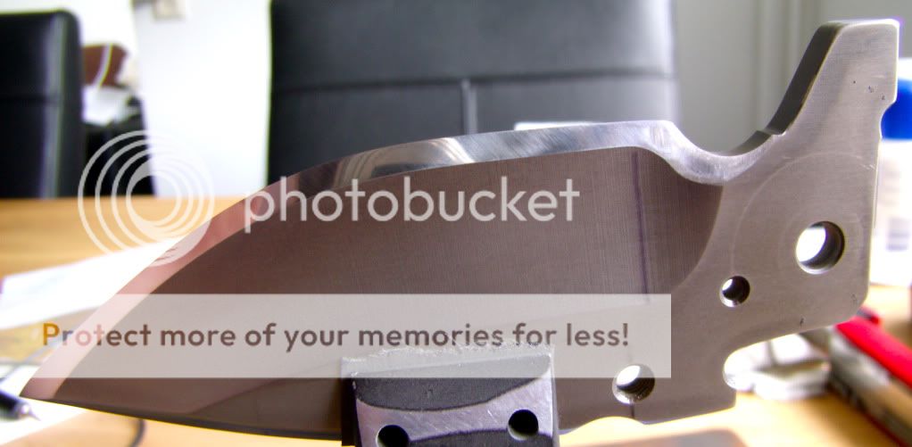

That's looking darn good, just a hair of cloudiness left at the heel of the blade. Perhaps left-over scratches from an earlier grit?

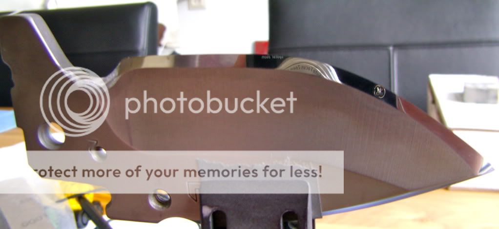

I think it's because all edge pictures are taken with daylight coming from the right hand side to show each scratch pattern at it's worst.
Most likely it's just the pattern the 6 micron diamond paste produces, but we will see as i still have 3 micron to go.

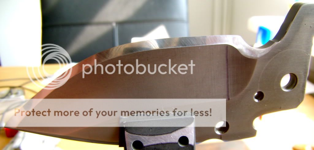

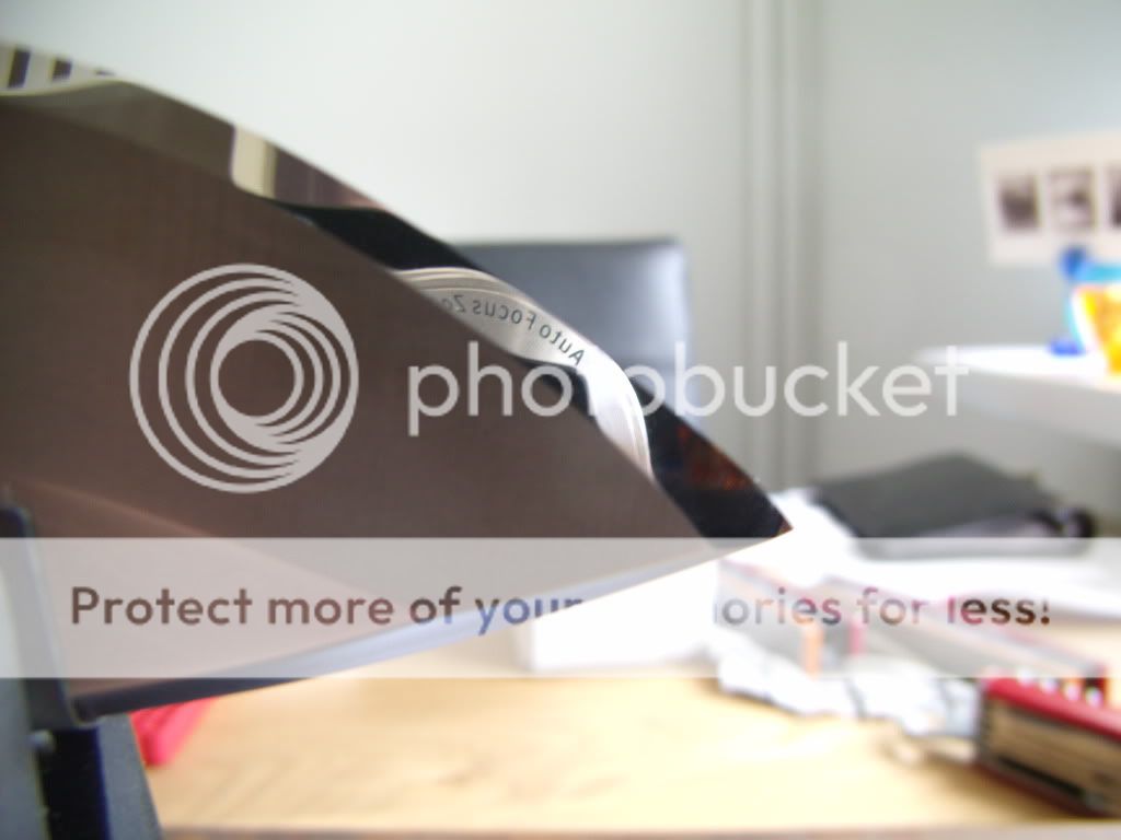

Currently busy with 3 micron diamond polishing paste (8000 grit) on the backside of the earlier used wet & dry paper; slowly but surely we're getting somewhere,
it looks awesome, great job. and it also looks like the main grind is pretty even on this one, way too thick :D but even tip to heel.

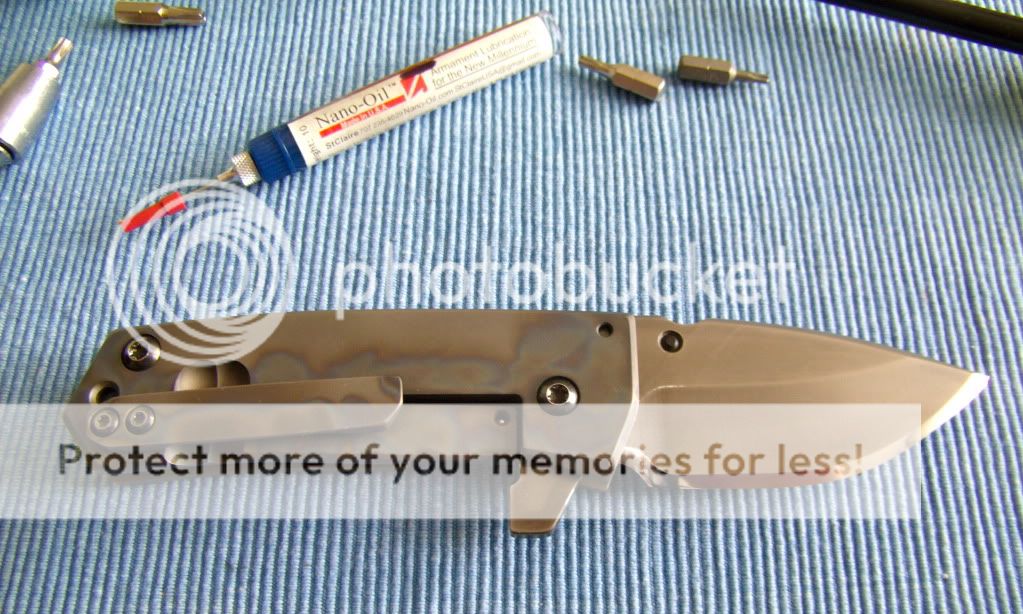

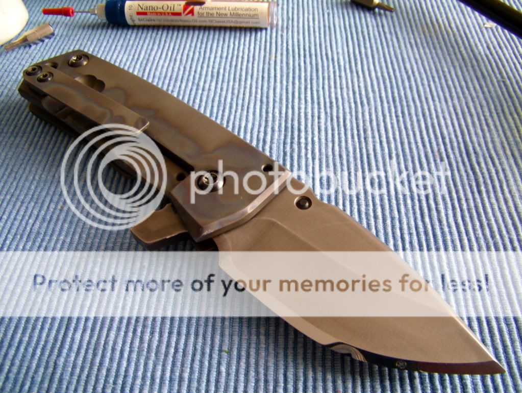

Just put the knife back together again.
All screws now have a layer of white teflontape, and Nano-Oil was used for the lubrication of the pivot axle.
