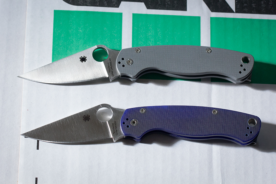

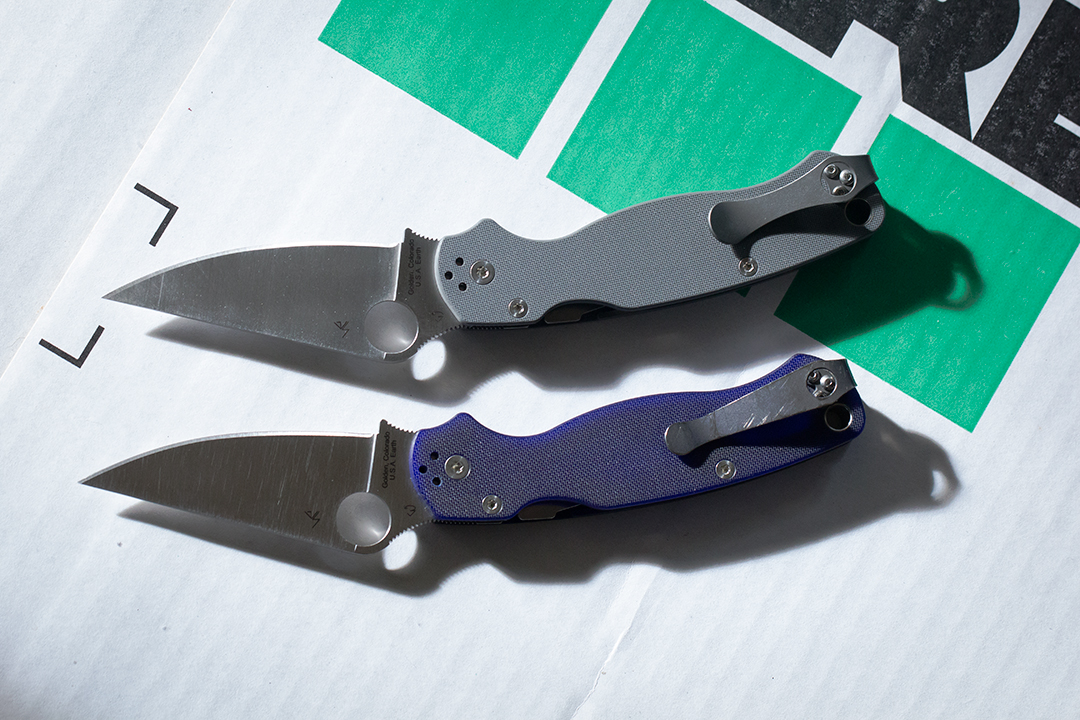

New cruwear versus old s110v
Build quality wise the cruwear knife is perfect in every way. The s110v is slightly off centered and took a while to break in whereas the cruwear already drops freely. The s110v has been used pretty hard so it will get a break now.
What clip is that on the Cruwear? It almost looks like a Lynch, but not exactly...
It's some random one I got from eBay, I'm actually pretty happy with the clip, the finish is darker and nicer than it looked like in the eBay ad. The one on the blue knife is an anodized lynch clip.
I shoulda grabbed one of these. That Grey looks nice. Have never used Cruwear. Guess i'll wait for a Grey Maxamet.

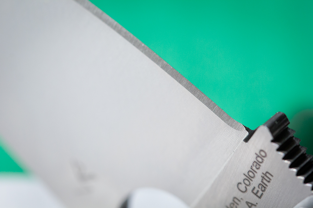

The most important part of any knife, the edge, is beyond scary sharp. Based on the rope-cutting video that was posted on the forum, this shouldn't need to be touched up (except for an occasional stropping) for quite a long time.
