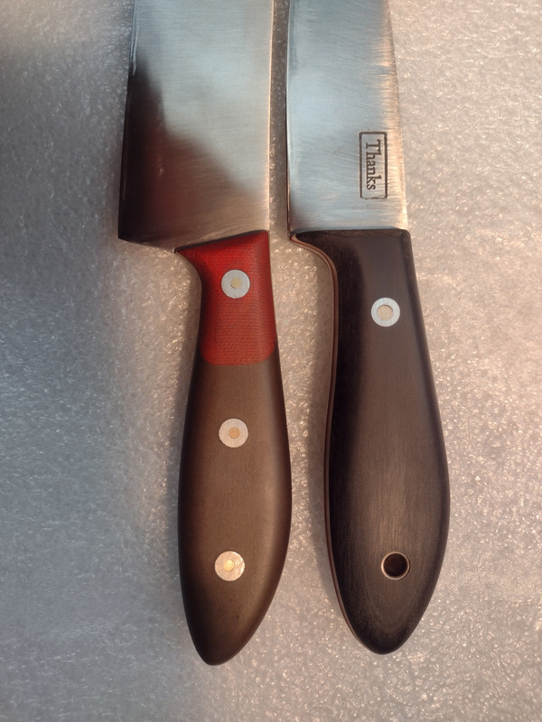

Although, The feedback I got was the handle was too big for some.... And some wanted this knife for in the kitchen, which wasn't my intentions.
So, because of what the people asked for, I came out with a New handle design that is .154" less tall than the original Long Paw handle design shape.... Idk If you can see in this picture?
If feels Noticably different.

I didn't realize it at the time, but the Pass Around is kinda dainty.....
The Last one I made for a fellow here specified that he really wanted it big and hand filling.. So I went a bit bigger on the thickness, same profile though. Wow.
It felt like holding a potatoe....but in a good way. I Love potatoes.
I now think it should be That thickness! :D
