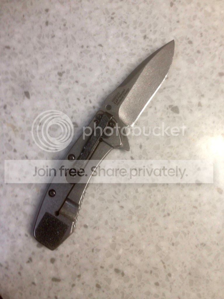

This Cryo has a finger choil, 9mm over travel disk, and a ferro rod notch on the top of the blade all done by me. It is also wearing a clip off of a Thermite. Very happy with how it turned out. Thanks for looking.
Really nice mods. What was the tools/method for the blade work?
I've dinked around with mine a bit, mostly re-profiling the blade and adding grip tape to the clip/ frame. Removing the thumb stud made it much easier to pull from the pocket, and I never used it anyways. It's two pieces and it unthread easy.
Dremel with the sanding wheel, various grits of sandpaper for the choil. Took it apart, marked where the choil should be, then dremeled till I had it to the right size. Checked against the frame for depth. Put a slight bevel on the edges, then hand sanded till smooth. Hacksaw and filing then jb weld for the 9mm over travel. The washers were polished as well.
