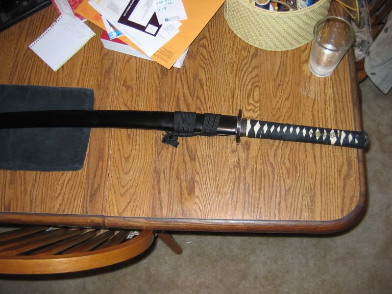

Just traded for this puppy. I used to have a CS O-Katana, and I've been missing its cutting ability and indestructibility. This is all that, in a shorter package.
The wrap was loose, and the tsuka core was cracked. With some liberal epoxy, I fixed it right up. I painted the entire core, along with the samé, matte black with high-heat stove paint, and a quick coat of matte clear protective spray.
I reapplied the ito, only with simple crossovers as opposed to the average twisting type of wrap. I tied it tight, added a few drops of superglue, and then applied shellac to the entire cotton ito wrap, saturating it. Not that it's all dry, it's nice and solid and offers a terrific grip. The diamonds aren't perfect, and there's a few spots where you can see the wood of the core (which is black, so it's not too obvious) since the diamonds are wider on this type of wrap. I don't care, it's a user.
The saya was sanded down to bare wood. I reapplied the wooden kurikata with epoxy, then hit the ENTIRE saya with paint-on truckbed liner. This is heavy duty shit, meant to coat the bed of a pickup truck. It leaves an awesome texture, and it tough as friggin' nails.
Without further adieu...
Before:
After:

It looks nice however, I have a question.... OK several questions.....did you dis-mount (remove) the handle? if so why are there no pics? where were the cracks? are there pics of the handle prier to refinishing?
I own one of these so I have an interest.....
Maybe "crack" wasn't the right term. One of the glued seams of the core came undone. I stripped the whole thing and used a strong epoxy to put it together.
Yes, the handle removes relatively easily. I didn't take any photographs of it dismantled because there's nothing worth noting. I just snapped a few after I got her all put together.
I did not take the initial pictures, those were taken by the previous owner. I only have intermittent access to a decent camera, otherwise I would've documented the rebuild.

documenting the whole rebuild would have been more informative however, it appears to have turned out well....
Good to see that the sword has gotten a facelift that makes it a much more appealing as a user! :thumbup:
