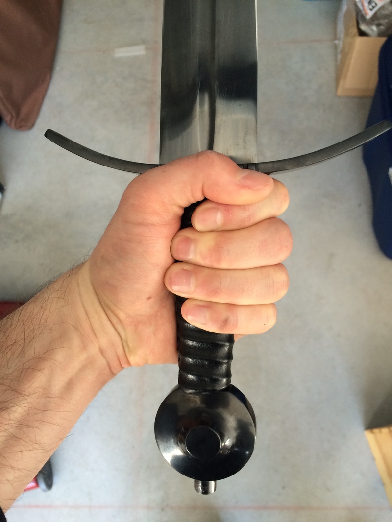

Lightest feeling and best balanced CS sword I've held. Point of balance is 4" in front of the guard. Profile, distal taper and fuller are all cleanly executed. I've owned an original Atrim, and handled Albions. This makes a perfect single-hand cut-and-thrust; sidearm, archer's sword, etc. Pommel nut construction holds sword securely, but allows for dismount to customize. I'll be stripping the black finish off the blade. When my mods are completed, the sword may even resemble an historical piece!
Pommel is inlet to accept the rectangular tang stock - sometimes called 'keyed'. Ergo, tang stock and not threaded tang-end takes the shock, and pommel will not rotate. Pommel is extremely well done - shape works well for slipping the grip to extend reach, or grabbing with second hand for greater control.

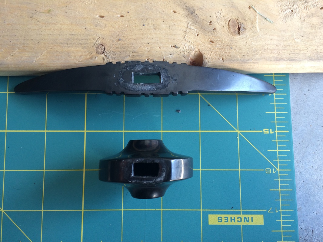

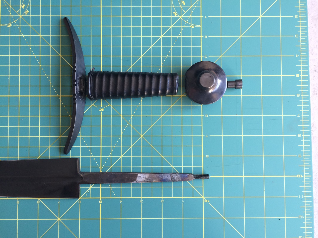

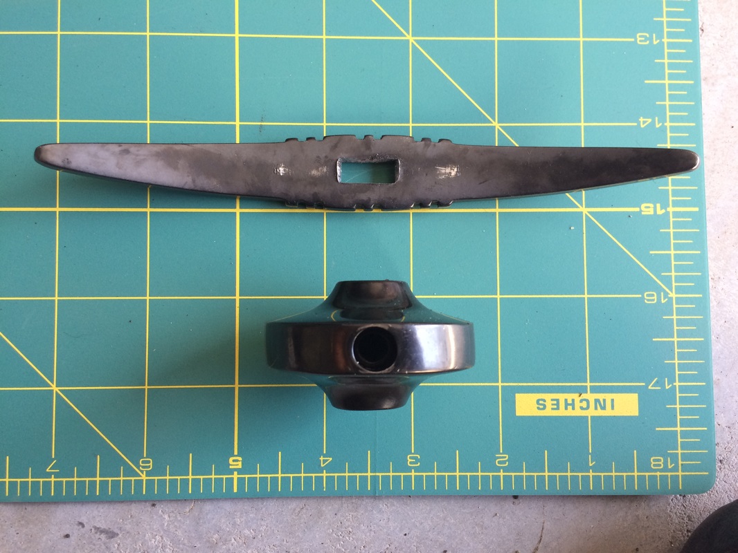

Took down the hilt today. Happy with blade stock and tang proportions. Weld for threaded end seems clean/strong.
Spaces inside grip and pommel filled with epoxy-like 'filler' which crumbled away. However, after reassembling and tightening pommel nut, there was no play in cross, grip or pommel.

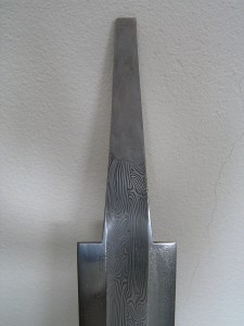

There was a major difference between the construction of antique swords and modern swords; modern swords are made entirely of steel in one piece. The blade, tang etc. is a single piece of steel. Contrary to this it seems to have been the nearly universal practice from the Middle Ages until well into the 19th C. to make a steel blade and scarf-weld it to a wrought-iron tang. This means that the tang, shoulder of the blade and the first couple of inches of the blade were made as a separate piece and forge-welded to the blade.
This means that we do have some different considerations; the tang needs to be treated differently because unlike the wrought-iron tang and shoulder of a 'period' blade the modern sword's tang is hard and subject to work-hardening in a way that was not true of the originals. This means that the shoulder (the join of the blade and tang) has to be well-rounded to avoid creating stress-points that can cause the blade to snap off at the tang. Ideally the tang should have a lower temper than the blade as well."
here's a pic of a nicely radiused one:
http://i44.photobucket.com/albums/f24/hephaestus61/Maces Hammer-In 2011-10-22/Matts-sword-tang.jpg
(nevermind the welded thread- that's a different discussion :) )
Now, I've seen many that are not as rounded but what you don't want is a right angle at the shoulder/tang point, no sharp corner. You want a nice curve- like a lady.

Hear you all on the tang width. One of the mods is to remove one inch of length from the shoulders. This gives me the opportunity to widen the 'new' shoulder/tang junction; I will have to widen the opening in the cross guard accordingly, and will round the transition slightly (don't like those 90 deg. angles). This will, of course, bring me into the known heat-treated portion of the blade material. The stock at that point is approx. .2" thick, almost 2" wide with a lenticular/flattened diamond cross-section.
Regarding tang hardness: Don't recall if tang hardness is described in manufacturer's specs. I'm aware that other WMA user swords (such as CAS/Hanwei Tinker line) have the tangs drawn back to be tougher. However - you can't see it in the pics, but the tang has 'COLD STEEL' stamped into it. It's using generic lettering (not the CS logo), and doesn't seem etched/milled (which would be costly). The tang is at least lower in hardness than the stamps, and likely lower than the blade. Steel stamps are around 60 Rockwell, no? Again, merely speculation.
Peen vs. thread/nut: Threaded ends on 'using' swords have gotten better over time. Not sure what the thread measurements are for this, but the nut seems to grab it sturdily. I smashed apart an old stump (thereby abusing the sword) without the slightest loosening in any part of the hilt. If it were going to fail anywhere, I think it would be at the weld, not the threads/nut. One advantage to nut construction is ease of disassembly for mods.
