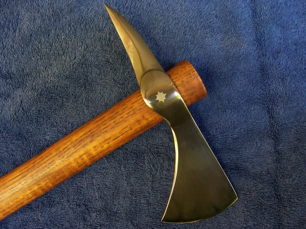

You may need to soften the screw and peen it prior to blueing in order to hide the edges of the hole. Before I started making the pewter inlays, I used JB Weld. The photos show a cut made for the inlay and the other pics show the completed hawks.
Hawkhead: Those look great!
Being a bit OCD myself, did you ever think of drilling the other side and having the inlay done on both sides of the head?
Here's a rough pic of the direction I'm heading with my next hawk's screw hole. Not sure exactly what I want in the end, was just aiming for a continuous channel from one side to other, in which I'll pour pewter. Needs a lot more file and grind work.
Hi BearKinder, Yes, but I did not want to get too fancy and take away from the simplicity of the blued steel, wood and a small unobtrusive inlay.
