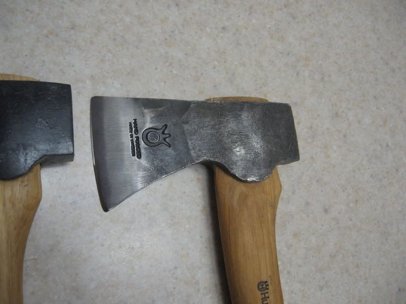

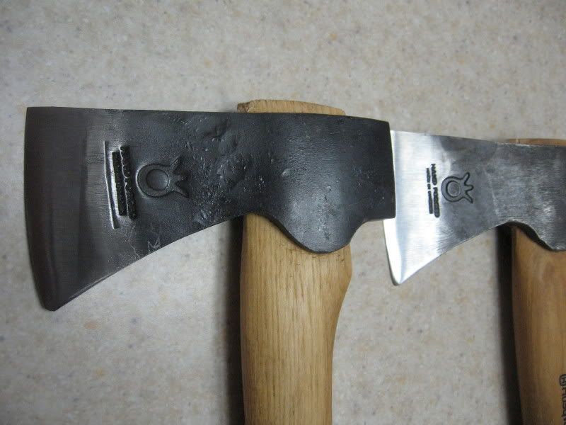

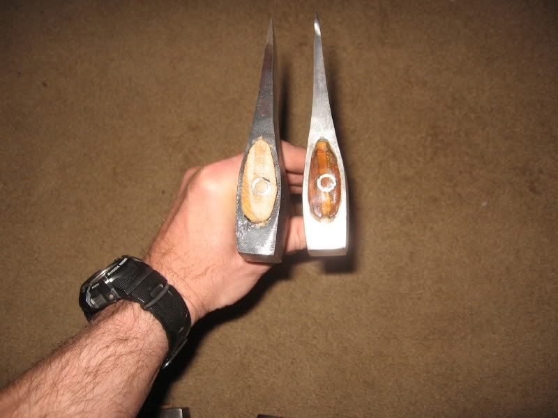

The huskies from the last three runs have all come from Wetterling. Wetterling has under gone a bit of a reshaping, as they were bought recently by the guy who owns GB. The Wetterlings of recent times have had far worse fit and finish issues. The Wetterling is on the left. See the pits, thick obtuse geometry, and miss aligned grain in the handle? The Husqvarna on the right is far better.
Please tell that to the Husky I ordered. Maybe that'll align it's bit, fix the pits, and keep the head from starting to falling off after chopping a 4" tree.

I'm not sure I could tell it anything your, obviously astounding, wit has not already. Please post some pics of your, horribly misshapen hatchet. I have seen questionable handles come out of every factory. On the net, no pics, it didn't happen. Only Lip service!!
My opinion is based on the four hatchets I have purchased. I have no stake in Husqvarna. For under $40 they are the best I've seen. According to Wetterling, the steel used in all the private labeled products is the same as in their name brand line. The heat treat is the same as well. Any difference in edge retention will be do to differing edge geometries. The Husqvarna hatchets have a thinner geometry then the Wetterlings. All on the handles on mine are good.

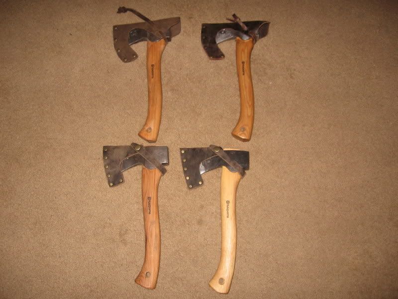

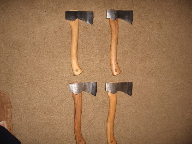

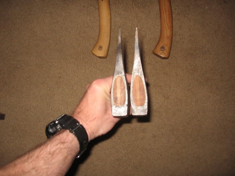

All four hatchets, two on top from the pre GB days, and two on bottom from after the GB purchase.
The two on the bottom don't have a metal wedge. Two on top do. I rehandled the polished one.

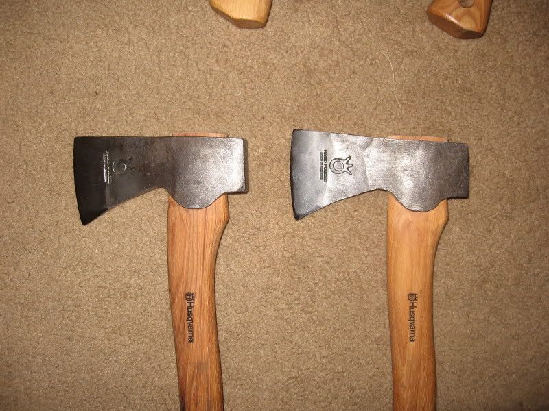

The finish is different on the runs as well, and the bottom curve on the bit is larger, on the second run. GB factory maybe? Guessing, influence for sure.
The darker finish is pre GB.

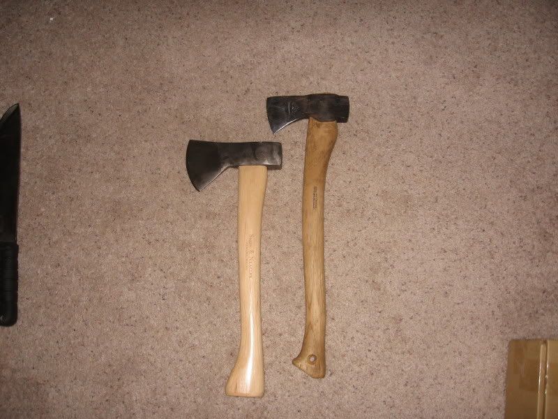

The Snow and Nealey, pictured here with my Wetterling large hunter, had the bit start to move on the second swing into a hard log. Sometimes they break loose. Rehandle it, it's not rocket science.

Drummertist, the finish is very different. I have not used one of the new ones, so I can't comment on the steel performance. The new ones have the same finish as I have seen on the GB line. The older ones have a smoother darker finish. Non of mine have any pits. All the pitting has been on my Wetterlings. I bought the extras because they are going into a couple Nessmuk trio sets I'm making as gifts. I'll polish them and make them disgustingly sharp, before heading out.
