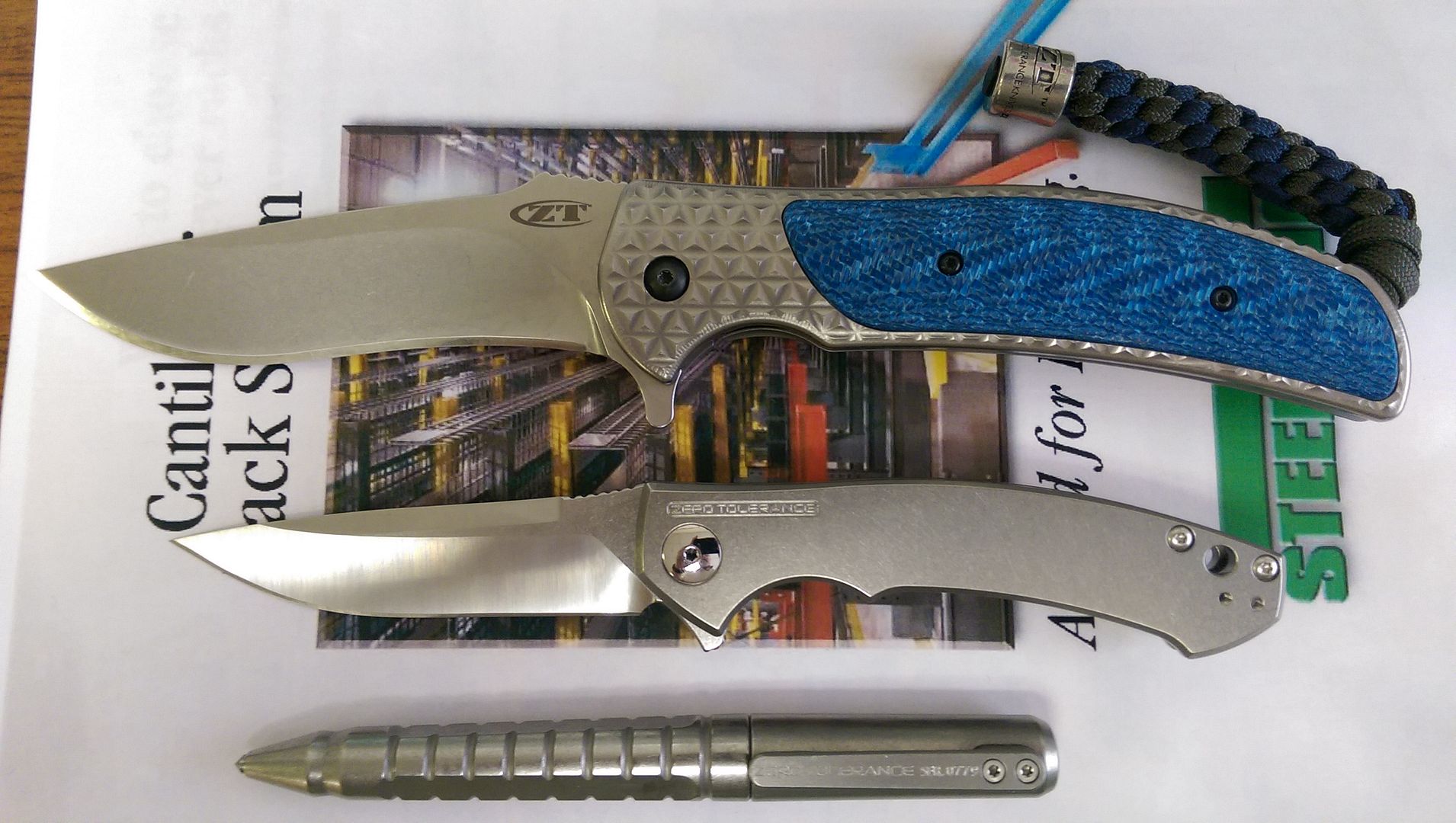

I carry (most days) a ZT0600 with B75P blade steel, and I really like it. I'm not a really hard user, but it seems to hold the edge really well.
Cool, any pics?
