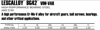

I don't think of it as profound. It is a well rounded steel falling between CPM 154 and S35VN/S30V in pure abrasive wear resistance. In my case it seemed like it was finer grained than BG42 parent steel just like I thought CPM D2 was compared to regular D2. It should be a bit tougher and have some better performance at the edge than the parent steel just like CPM 154 vs. 154cm but I haven't had enough experience with it to actually see it.
I don't know of anybody using it enough to have developed a tuned heat treat like was done by Buck or Chris Reeve with their BG42 or S30V . I can tell a difference in their steel vs. Benchmade or Spyderco, for instance.
It seems like I can anyways. Some would say that is impossible and my imagination (Cliff Stamp).
I like BG42 better than S30V even though S30V has higher abrasive wear resistance. I'd expect I would get along with CTS B75p but wouldn't go so far to say it ( or any other) is a better steel. I just have preferred steels in different categories. Whatever balance of attributes is best for whatever I'm expecting to do is my favorite steel at the time. If I was forced to pick one only it would be 3V or Cruwear/Zwear/PD#1
