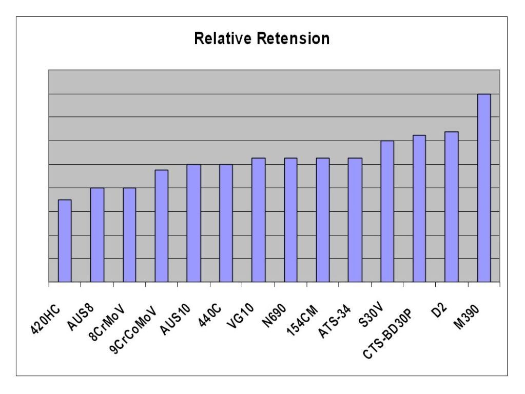

I cut 3/8 manila rope. I got the idea from Phil Wilson. He likens the abrasion of cutting manila rope to that of skinning game. I like it, because it is a very uniform substrate, which does not cost much. In my testing, the rope is supported by the boards and stretches across the gap in the boards. The gap is narrow enough that the rope does not get pulled into the gap. It cannot bind the blade. I cut so that the blade passes through the gap in the boards, which hang out over the edge of my work bench. The blade only cuts rope and does not come in contact with the boards or anything else. The only thing that can damage the blade edge is the rope cutting itself. I make slicing cuts, endeavoring to use the amount of pressure necessary for the cut to be made with about 2 of blade surface.
After a given number of cuts, in this test 30 for each run, I examine the blades using a 3X lens and a high intensity light. Before the cutting, I check to make sure that I cannot see either edge. After the cutting, I look for the edge and gauge the amount of damage by how much of the edge I can see and how much light it reflects. In other words, I look for degradation of the edge.
The advantage to this method is that it negates differences in performance due to blade shape. All I am looking at is the steel. IMO, it's been proven that blade shape is more important than blade steel in cutting performance. So, I want to look at how the steel itself performs, and not how easily the knife cuts.
Results and discussion:
I made about a dozen runs. The CTS-BD30P consistently showed less damage than the S30V. How much better was it? It was not a night-and-day difference. It certainly did not perform at the M390 level. However, I think that if you had two blades with the same shape in the two different alloys, you might see the difference in every day use.
I don't think that the difference in performance was entirely due to the 1-point difference in hardness. I suppose it could have been, but it seemed like more than that to me. I noticed that, the damage to the CTS-BD30P blade seemed more uniform, than the damage to the S30V. The S30V blade often had bright spots, whereas the CTS-BD30P blade edge mostly only showed a thin line. I've tested two S30V blades with a 1-point difference in the hardnesses in one of my previous outings. This didn't look the same. It's a judgment call, and I could be wrong.

To answer my original question, Yes, I think the properties were improved by tweaking the S30V composition. The difference isn't as large as the difference between 440C and N690, but IMO, it is there.
If I had a choice between a knife with a CTS-BD30P blade, and the same knife in S30V, I'd take the CTS-BD30P. If it were two different knives, I would choose the knife based on other factors. (This is normally true. If you aren't a steel junky, there are any number of good alloys that can be chosen interchangeably, their differences overridden by other differences in the knives.)
