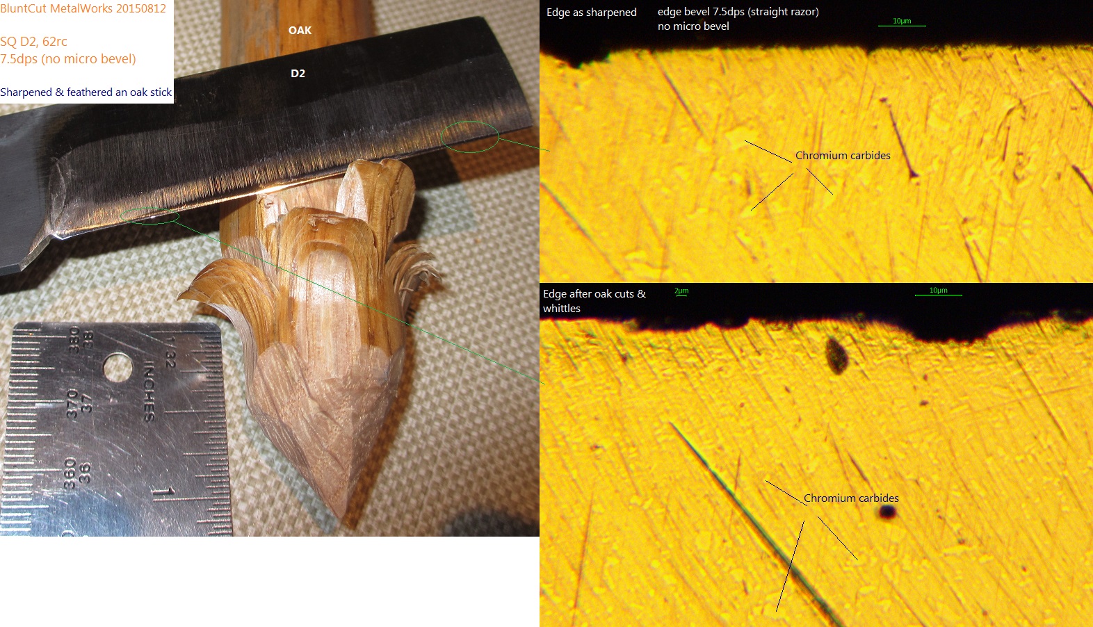

However, if you really want to find out a lowest working dps, get a good 15-30x loupe -> sharpen to 10dps then air-cut (cut in the air) zip tie at 45 degrees angle. Check edge with loupe, if edge intact, proceed to whittle some hardwood such as ebony/ironwood/honduran-rosewood. Initially use gentle cutting pressure, keep increasing until past the point of normal usage. Increase dps if edge damage, decrease otherwise. Repeat until zero-in a stable dps. Final dps = this stable dps + 1-2 buffer dps.
My test zero-in dps for many steels usually start around 6dps. Here is an example D2 at 7.5dps **note: CTS-XHP is similar to D2, except stainless (more Cr) **
7.5dps that's insane, in a good way :-D
