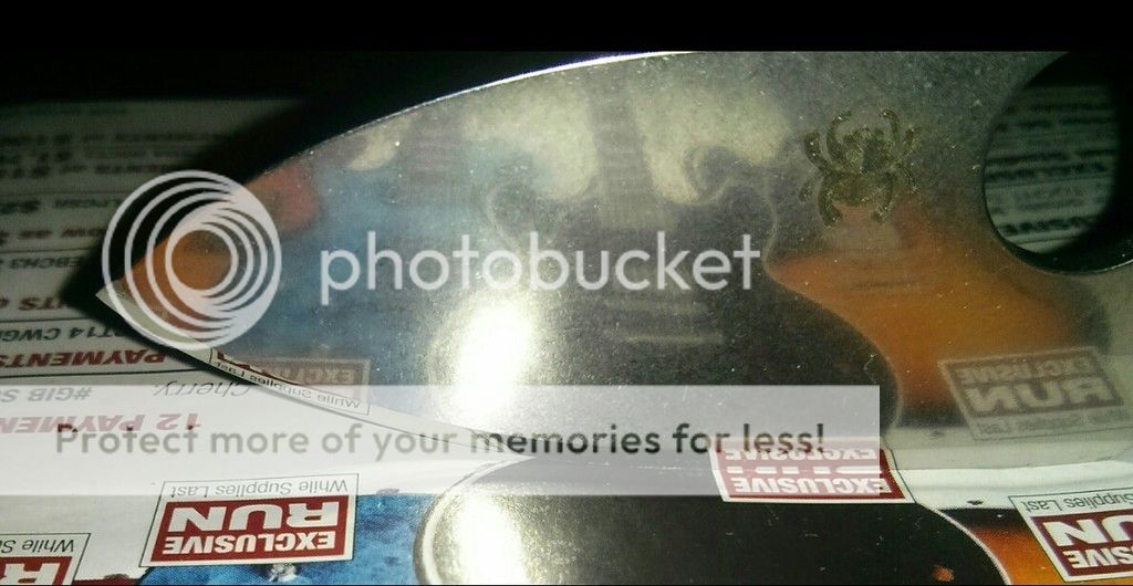

I offered to put a mirror edge on bleedingfinger's Techno, and he mailed it out to me this weekend. Since I hadn't really had much interest in the Techno - I'm left handed and have a few left handed framelocks already - I was surprised at how small it was. Spyderco did a good job with the primary grind on this--much better than what Strider does. In fact, I will say that the fit and finish on the Techno is objectively better than that of an SNG. If you are looking for something PT sized, the Techno would be my recommendation over the PT.
Heres' the mirror edge:

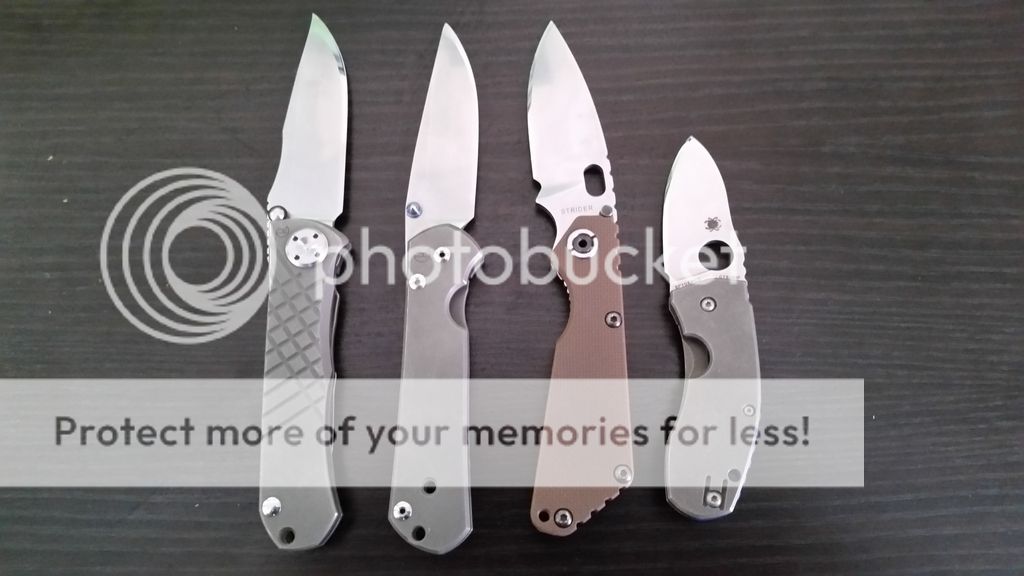

And here it is in comparison to a few other framelocks:
Wow. That's awesome! I have never had a real sharpening done on a knife . I can not wait to cut with it! Thanks Cynic and bladeforums.

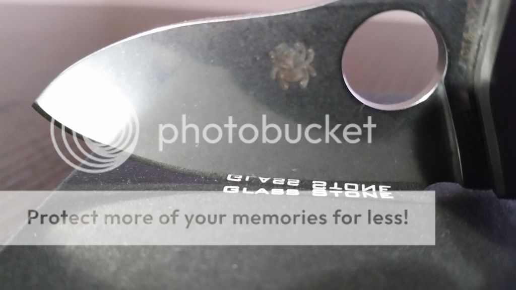

Well alright, update time! I received my techno back from cynic a few days ago. The sharpening job dropped my jaw. Wow!
I press it against something and that something slices open.. lol laser like!
I know the mirrored bevel isn't the cutting edge but man it also LOOKS sharp... And gorgeous!
Like liquid metal. Unreal.
So as luck would have it I've had more than average number of cutting jobs pop up last few days and a couple that where similar to what I believe quickly dulled the factory edge.
There is no noticeable dulling.. I am convinced the factory sharpening was the culprit not the steel. I'll continue to test and take note however. So far excellent performance.
Now when I'm not playing with my knife, I'm polishing smudges off the bevels... Lol its a sickness.
Knives are great and hobbies are fun. People are what really makes anything in this life worthwhile. Cynic went out of his way to hook me up and give me the knife experience that people like us want.
Once again, thank you.. . Cynic is a class act, and a great asset to this community.
Here's some pics...
