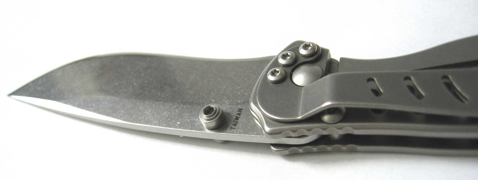

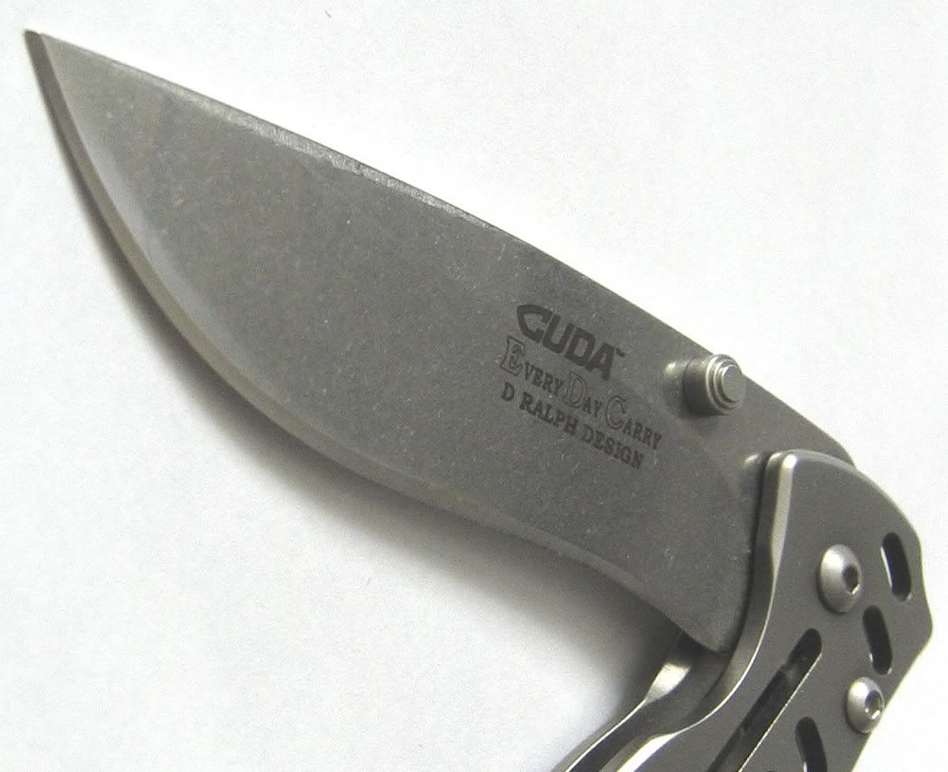

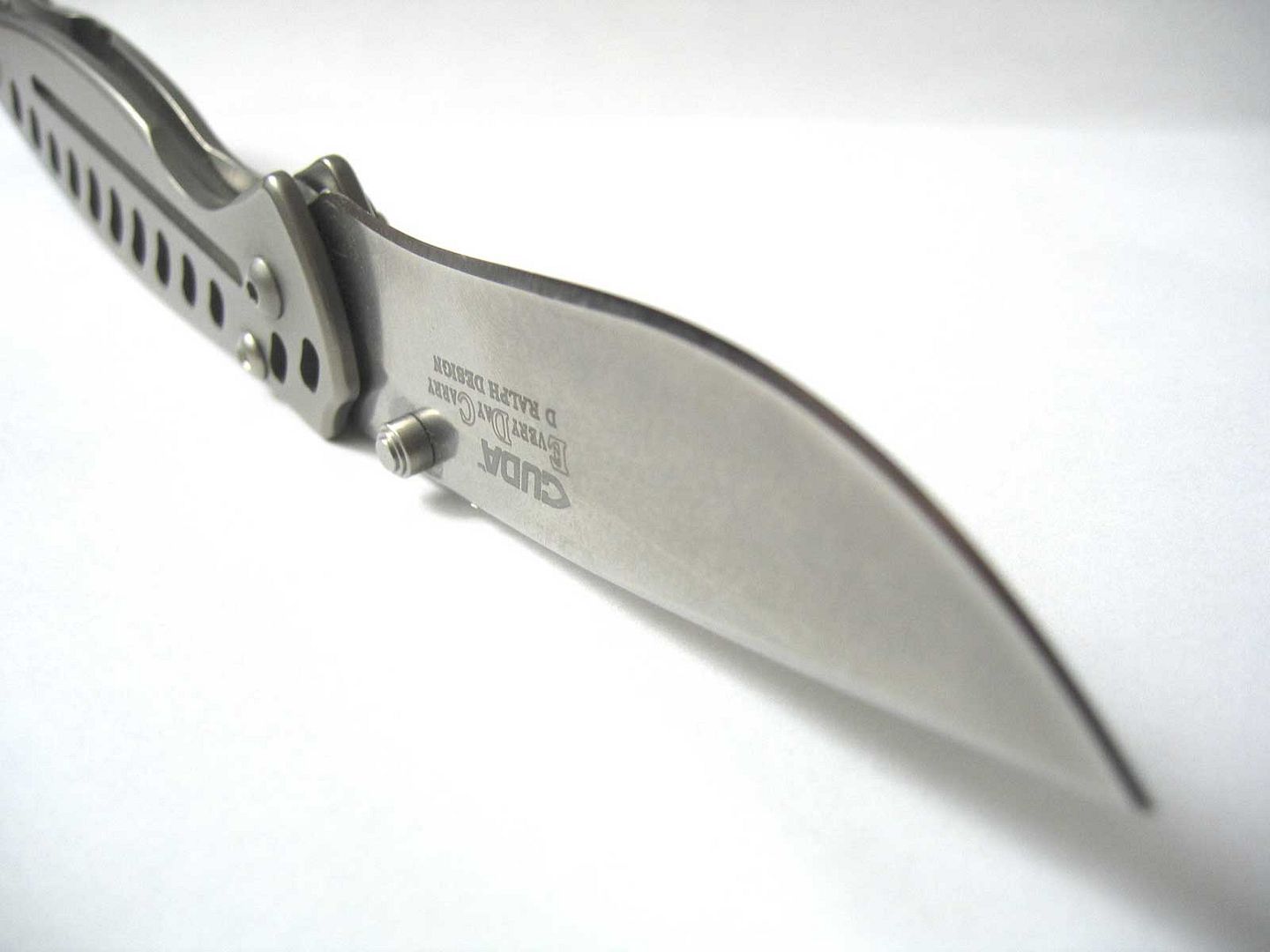

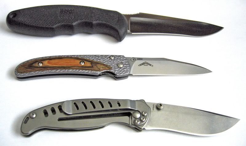

They were made in variety of steels but now it is AUS8 only - for this version you pay approx. $25 (@newgraham, where I got it, I saw it somewhere for $20 but I didn't know the shop and to say the truth shipping cost would equalize the price for me). Blade steel is nothing special but it has stonewashed finish which isn't seen much.

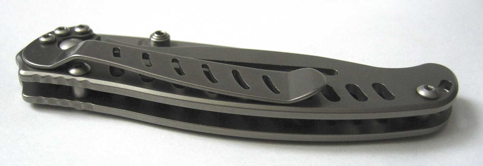

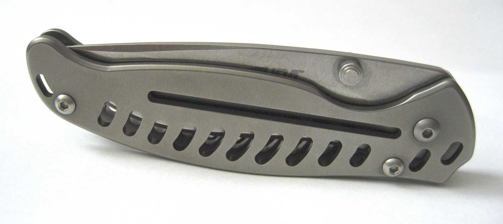

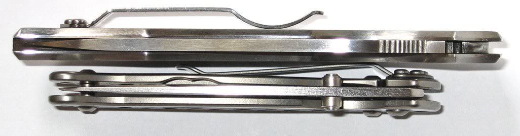

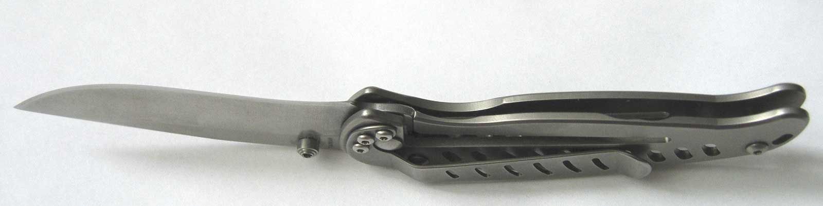

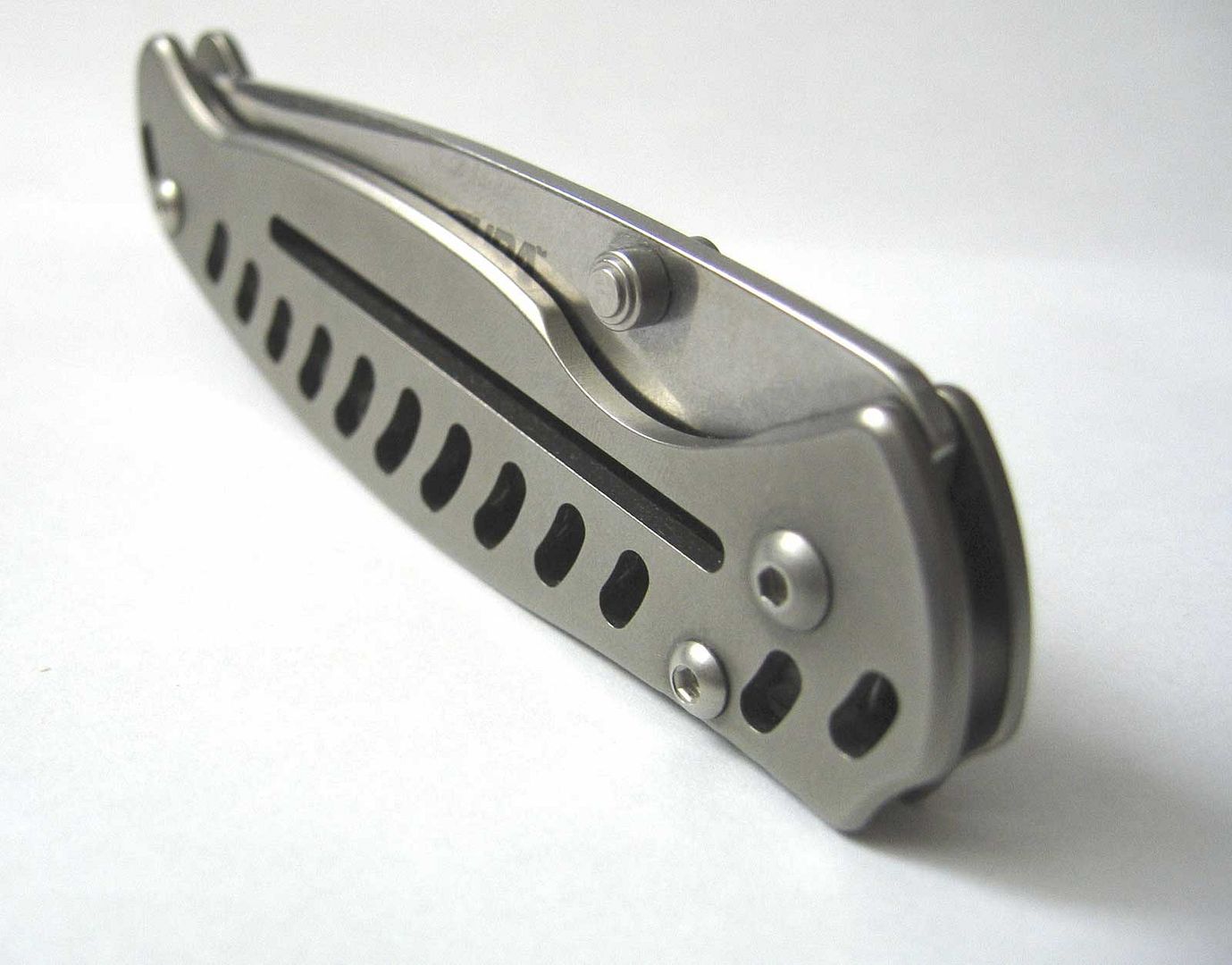

Overally it isn't too heavy (cutouts in handles do wonders). Thumbstuds are moved quite forward so they can catch on something when you are trying to use full blade lenght but on the other hand opening is quite comfortable due this.
It looks good, and feels good in hand. Only one clip position if you mind (I don't).

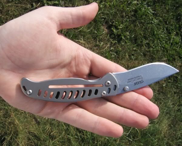

It has pretty good blade/handle ratio. It is small and thin, so it is nice EDC (surprise huh? :)) but expect that handle isn't big (for about 3 and half fingers only :))

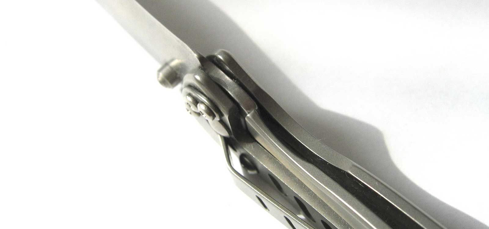

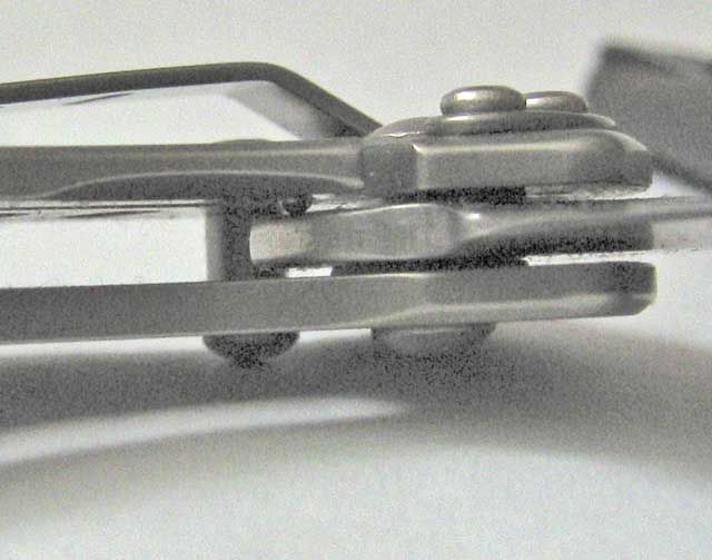

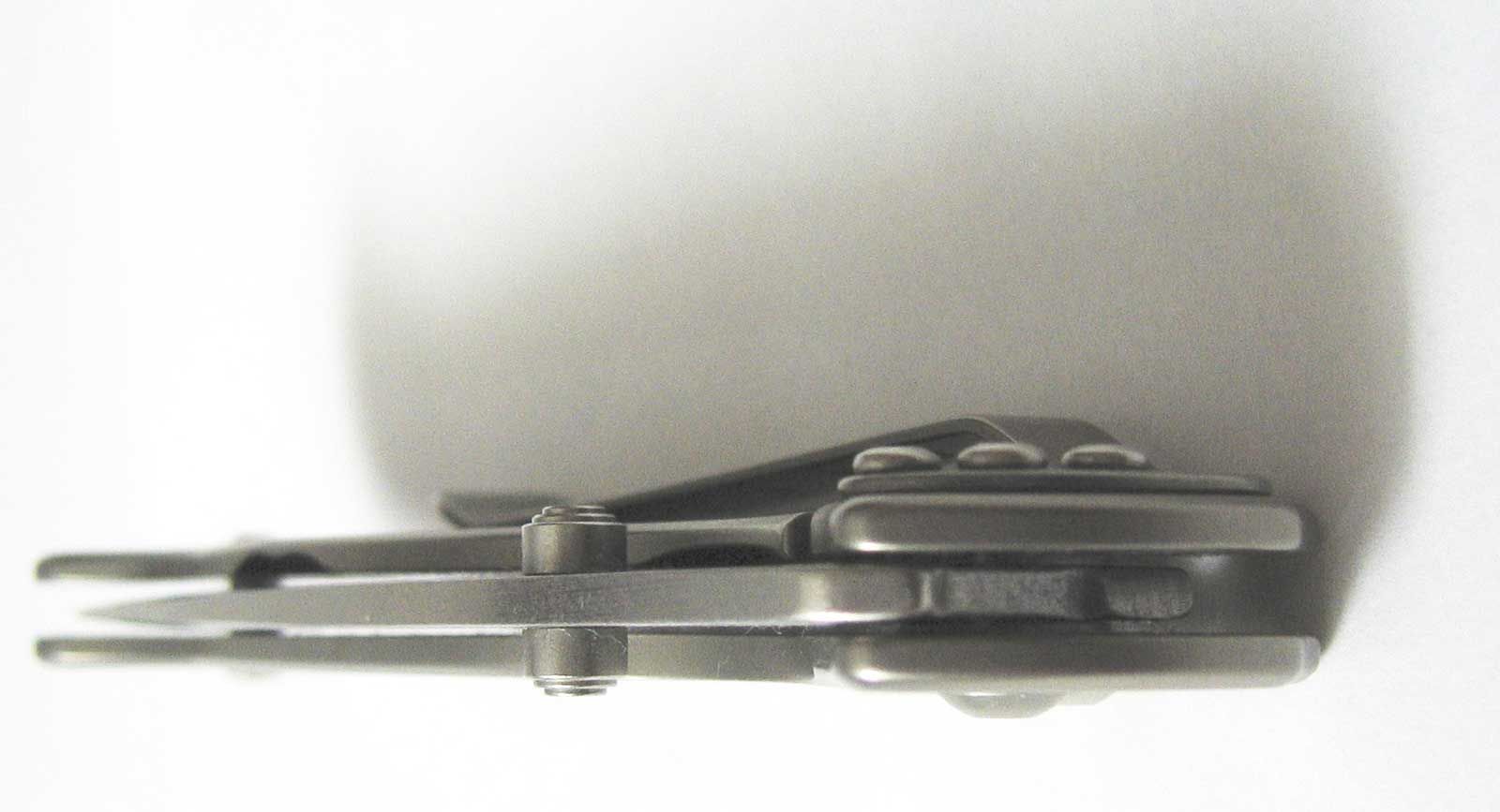

Lockup is solid. My biggest concern is that it has plastic washers :barf: but for this price you can't expect more. Also blade isn't perfectly centered (I personally blame the washers (which are prone to deformation, and the lock springs quite strong) (but it doesn't rub the sides, just not perfect) and worse, when you open the blade, hold the lock disengaged you can notice horizontal blade play (again I think it is because of washers). In locked position there is no blade play at all.
