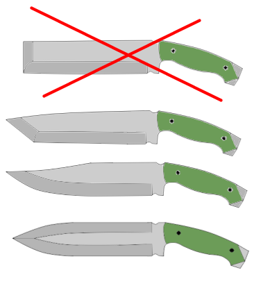

The mall ninja appeal is the part I can't get past... well, not even that, I just don't think the design has a practical use. It doesn't look like a good fighter and it doesn't look good for utility either. I don't get it. It would be far more appealing with some kind of point and would probably see more sales especially at that price point.
Imagine the possibilities...
Heh, the bowie version in that pic is basically the Condor Dundee Bowie:
And if you added some serrations, the tanto version is basically the Kabar "ZK Famine":

It might appeal to me more with a more conventional point, but having a straight front edge like the Razel certainly has some utility appeal. As a fighter, I'm in agreement that it doesn't seem overly useful, but the choice of grind puts me off more than the lack of a conventional tip. If you put a convex primary grind on the main edge and a short, obtuse flat grind on the leading edge I'd pick one up in a heartbeat. It just seems like a few of the design elements are at odds with one another.
Really, I don't think the design is that bad, just not quite as thought out as it should be. I suspect 99% of the bashing is centered a whole lot more around the 'Combat Ready Battle Cleaver' bit, which does indeed make me wince.
Full tang 5160 with G10 handles and a sheath for 44 bucks would make for a pretty tempting beater.
I am kind of a fan of square nosed choppers. Adding the chisel point is something interesting (I like the small Graham Razels).
I have a chisel point knife I made in 5160 (small), and it is pretty handy for some things. I am not sure how handy the chisel point on a big chopper would be. The square design will move the weight/balance out further for chopping.
The cons I see with that design. First, that exposed tang on the rear of the handle is a very poor design. Very thin triangular cut outs will break with heavy impacts/dropping the knife etc. Bark river makes a big thin cutout design like that which is very susceptible to breakage from dropping. Forget hammering with it or pounding on it.
Second issue, that grind will give horrible media penetration! Very narrow shallow grind to saber means it goes from edge to full thickness extremely fast. Take a good full flat grind on that same design, and it will have much better penetration.
The low hollow saber grind is done on this design for one reason only. Speed and low cost of manufacture.
Too bad they did not go with at least a flat saber. Then regrinding it would have been much easier.

There are three good reasons for this type of tip design:
1. It lets the knife be used as a scraper/plane/chisel
2. It might makes Darwin Awards less likely than the other designs you sketched
3. It works well in pry bar knives - like the Cop Tool that is extremely popular with LEOs, the MAK that's designed for firemen, etc.
Really: any time you find yourself defining practicality in terms of knife fighting, just stop and think...
