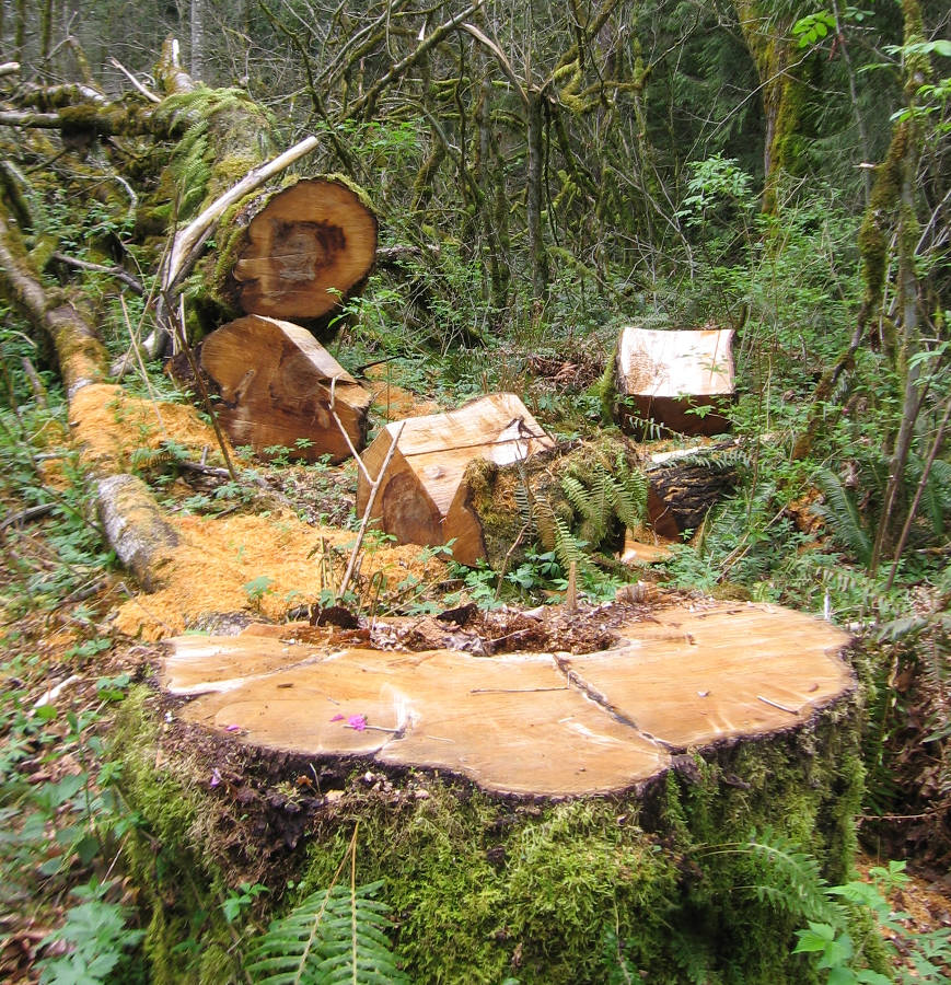

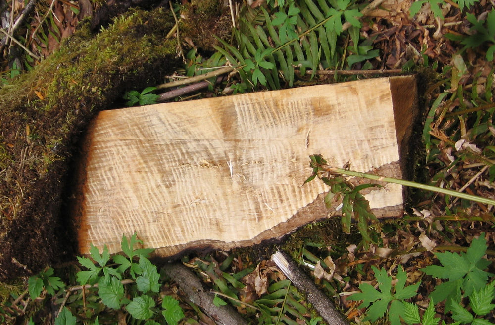

I encourage everyone to stay away from curly maple. The market is flooded with 'poached' maple trees. Tree poachers are coming into your publicly owned forests and stealing curly maple from you. These forests are managed for timber and the proceeds fund schools (keeping your taxes down). Thieves come in and steal your maple. They take just the curly maple from the base of the trunk and leave the rest of your valuable timber rotting on the forest floor. This has occurred in numerous local forests here in the Northwest.
Here are photos of one such theft I came upon in your forest.
Square_Peg, seeing examples of wood poaching is a crying shame. But somebody has gotta be pretty sharp at being able to spy curly maple while it's still on the stump with bark on! Or are they merely gambling? Far as I know around here only at the sawmill can it be determined whether the wood is figured or not.
There are ways to tell curly maple. I've withdrawn them from this forum for fear of encouraging other poachers.
Understandable, and thank you. My neighbour recently had a few large Maples removed on their property because they were dangerously overhanging the house and one of them (after being cut down) showed exquisite curly figure throughout some of the resulting firewood. I spirited away (with their permission) a few chunks of this stuff but the tree exterior didn't look to be any different from that of the surrounding trees, to me.
2 months ago some local thieves were charged with stealing maple. This was several counties away from where I've found maple theft. The problem is wide spread.
