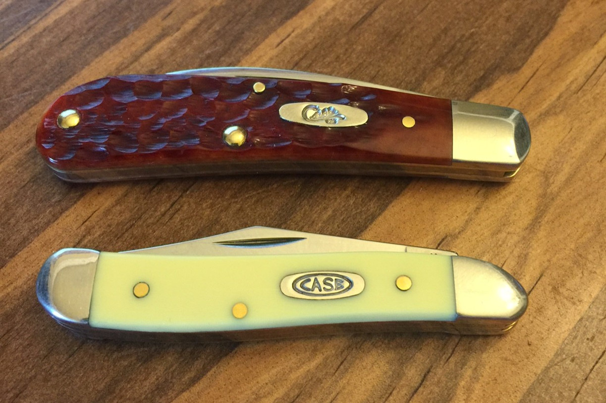

Hello Knife Nuts,
I'm curious if you folks can shed light on which current Case models have a half stop? My Mini Trapper does but my new Canoe and Medium Stockman do not.
It's by no means a deal breaker for me or anything but I do like the half stop and am curious.
As always, thanks in advance.
The Swayback Gents and Jacks that I have do have half stops, as do the Peanuts I have. I don't have the model numbers available right now.
The TB61028W CV Teardrop also has a half stop.
Looks like @Peregrin beat me to it by mere seconds :p
I didn't post images! That's likely why. I'm usually slower on the trigger, must be the Wheaties I had for breakfast!
My recent peanut comes with a half stop. Unless they have changed something in the past year, my full sized trapper does not have a half-stop unlike your min-trapper.
Both of the Case Barlows I own have the square joints (half-stops). They were made in 2008 so if something has changed since then I couldn't tell you.
With Case knives, the use of square joints is part of the pattern. According to a Case representative, the following current production Case knives use square joints (half-stops).
"Here is a list of active patterns that have square joints:
'005 / '005 1/2 / '005RAZ - Barlow/Razor
'07 / '07W - Mini Trapper
'009 / '009 1/2 / '009RAZ - Barlow/Razor
'011 - Hawkbill
'052 - Medium Congress
'117 - Sway Back Gent/Jack
'15 - Small Gunstock
'156 - Tuxedo
'20 - Peanut
'43 - Grand Daddy Barlow
'49 - Copperhead
'546 / '546 1/2 - Back Pocket/Panama Trapper"
