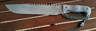

It's a personal preference, but for me, $40 more for comp finish is going to win every time. I've stripped a TGLB, Battle Saw, and an Ash 2 and while I like a stripped blade over a coated blade for any user, the only reason I did it was because they weren't offered in CF when I bought them. Like Cobalt said, stripping is a PITA and if you want to keep the logo defined you have to etch it (I still haven't tried that). Below are a couple pics of some of the stripping I did. The BS has a few hours into it (this went to my brother as a Christmas gift last year and my current BS still has the coating since I didn't want to bother with it again - CBT & saw teeth...). The Ash 2 was just the initial CitriStrip and a once over with some 600 grit sandpaper, but still maybe a couple hours of elapsed time (mostly while the CitriStrip sat). Last pic has the CF MO Burp on top of the Ash 2 as a comparison pic.
