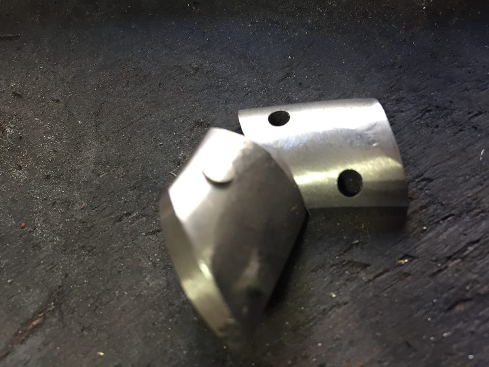

Today I got frustrated with a curved stainless bolster, flat ones are frustration free, but when they are curved I have a 50% success rate, some end ok, some come to say hello when they are almost finished :)
Here is an example:
I normally taper the holes with a larger drill, peen and then beat the hell out of it, but when its curved all my hammering gets grinded in the curvature and I end with straight pins that love to reappear...
What do you guys suggest?
I use 3mm 304 stainless pins and bolsters (almost 1/8") I tought about tappering a 4mm drill so the hole is tappered all the way to the tang.
Suggestions?
Pablo
i have found if i flux the holes and pins before peening they fill up and disappear more often.
You can taper with the drill press when the boster surface at the hole is fairly flat and round.
If your holes rims are elliptical due to the slope you can chamfer with a needle file or whatever...you only need a little taper to lock the bolster and let the pin disappear...you could even use a small chisel and hammer to cut the slope.
Another very good (best) option is using a 2° tapered reamer....it will allow for a lot of slope in the bolster...in this case leave the 304 and use 410; the 304 will work harden too much for a long taper to fill properly.
Anyway the example in the picture is a bit extreme and should be redesigned IMHO...even if you would put a nice chamfer, when you pin you'll distort the pin on one side, skewing the ensamble.

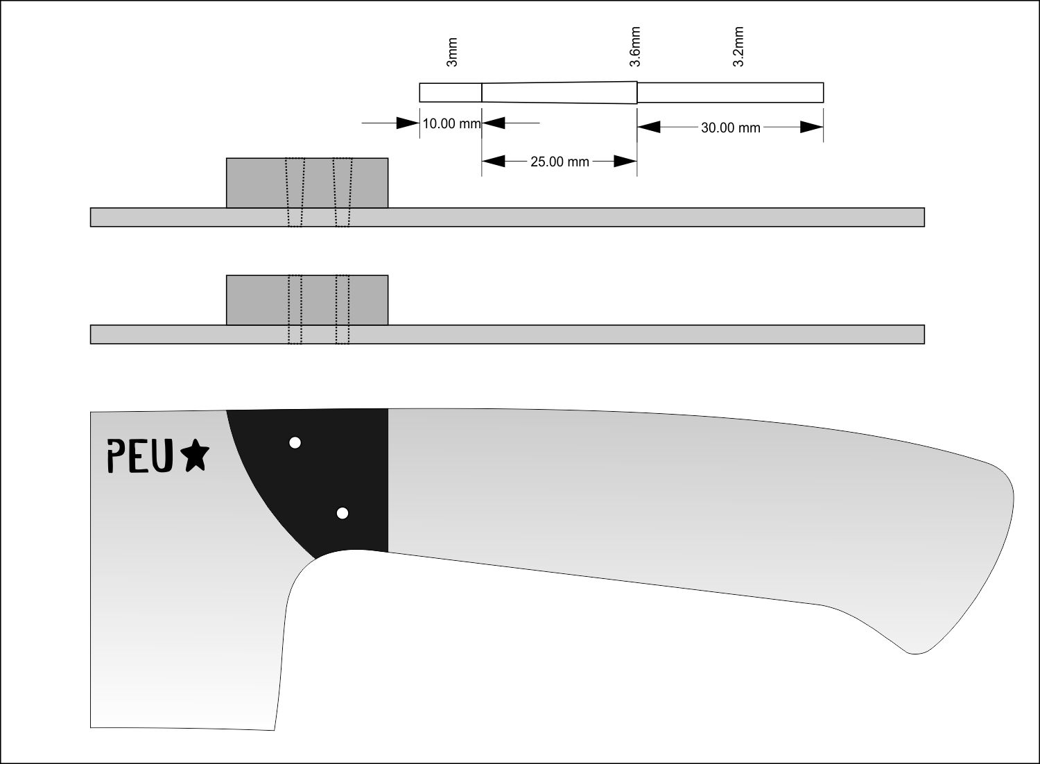

I tought of a tappered reamer or a custom made rotary diamond file:
(in the image the taper should ream only the bolster, its a quick draft)
anyone uses tappered reamers for the bolsters?
Pablo

I haven't made a knife with pinned bolsters in several years... but back when I did, I always used a taper-pin reamer. There's less focus on peening the head -- since it will get ground off anyway -- and more focus on expanding the pin to fill the taper. I only ever used 416 bolster material with 1/8" 416 pin stock. I run a 4/0 taper pin reamer turned by hand in the drill press.
Erin
Tapered reamer was the hot ticket for me..
Softer steel as others mentioned will help as well.
I personally grind my bolsters close to final thickness/shape with a sacrificial pin in the hole.. Then ream the hole.. insert final pin in and grind it just above flush. I use a center punch to set the pin in the hole on both sides. Grind away the remaining tooling marks.
