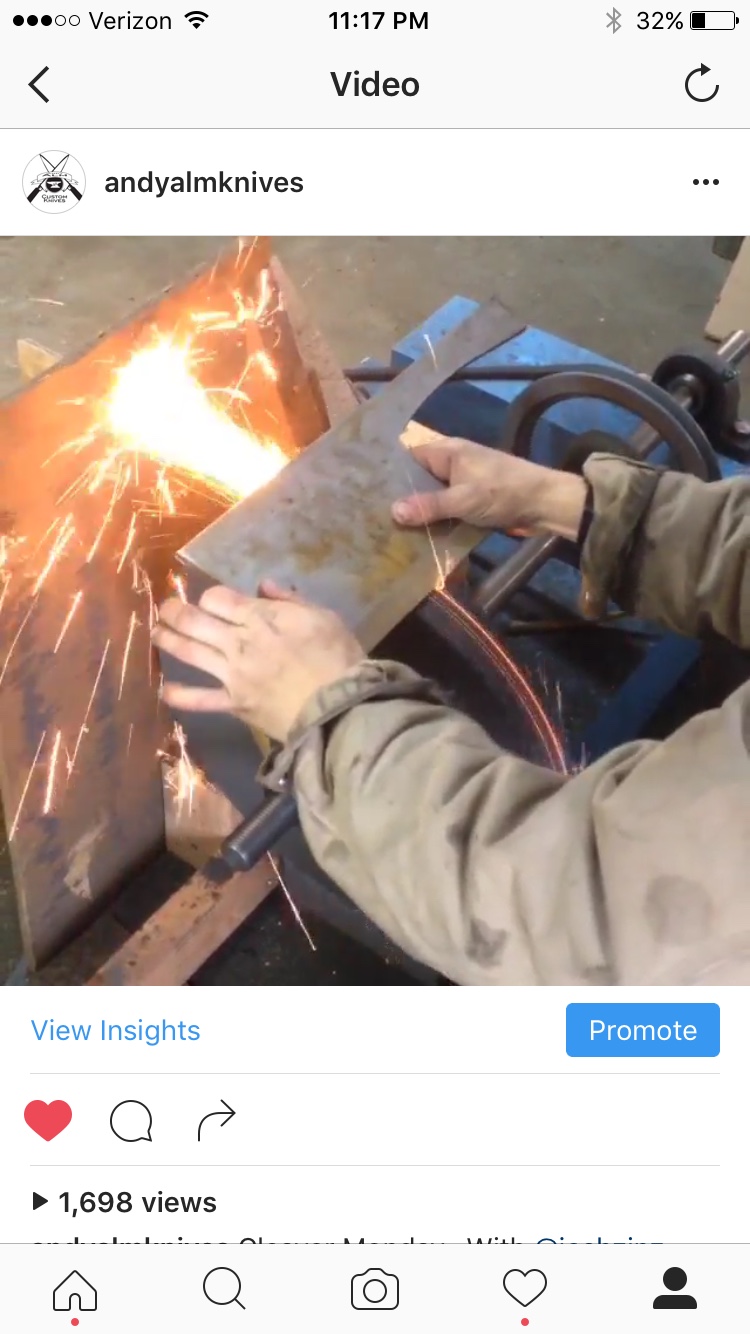

Holy cow. When he said "large wheel" I though he meant maybe 14".
I have seen those absurdly large wheels in various videos. What are they used for?

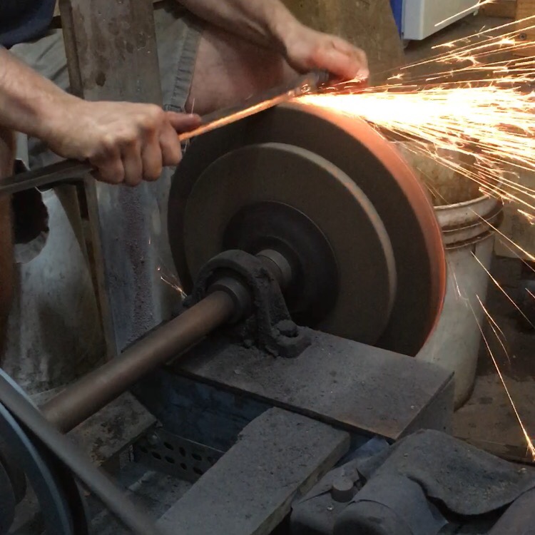

Large wheels are used here in Japan to grind blades very efficiently. They remove material quickly, and are water cooled, so you can grind continuously without needing to dip the blade. They are not necessarily for hollow grinding. Although they are used for grinding the shallow hollows (urasuki) on the back of chisel ground knives (such as yanagibas) the Japanese grind both flat and convex blades on them. For example, I know a maker who does very thin gyuto, which have a subtly convex geometry, and he grinds them entirely on wheels. However, he will transition to a horizontal stone to get dead flat surfaces (or to help even out the convex grind).
Having ground on these wheels, I can say they are absolutely amazing. Belt grinders may have them beat as far as versatility is concerned, but as far as efficiency, there's no contest. They grind fast, cool, and you can grind hundreds and hundreds of blades on one before you need to replace the wheel.
Yep highly efficient. Wish all grinders were designed and built this way.
A skilled bladesmith can grind a bevel in minutes with this rotating water stone and then just finish up on a 2x72

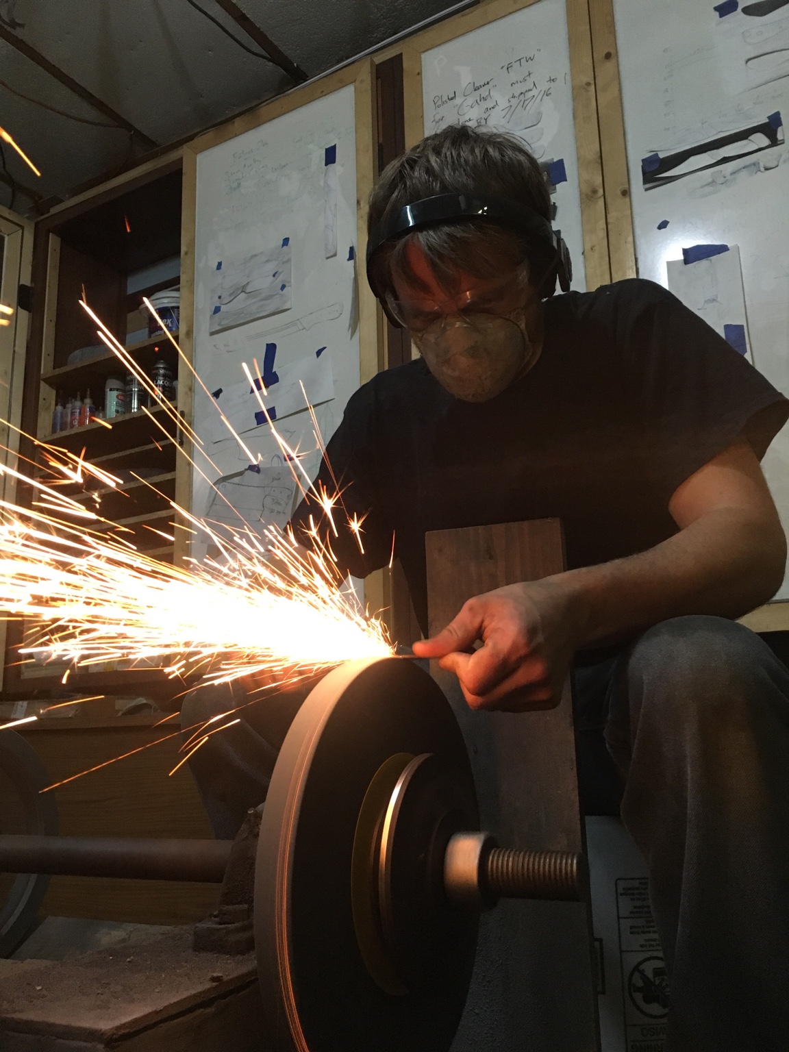

I grind all my blades on stone wheels and finish with buffing and scotch brite type wheels. The largest wheels I run are 16" and I have both stone and scotch brite in that size. I usually do hollow grinds but it is possible to get a very nearly flat or slightly convex grind on this kind of wheel.
The wheels simulated in a curved platen are usually 36, 48, 60, and 72 inch wheels. The average maker will never have such wheels ... but can have a curved platen and get the sane hollow grind.
