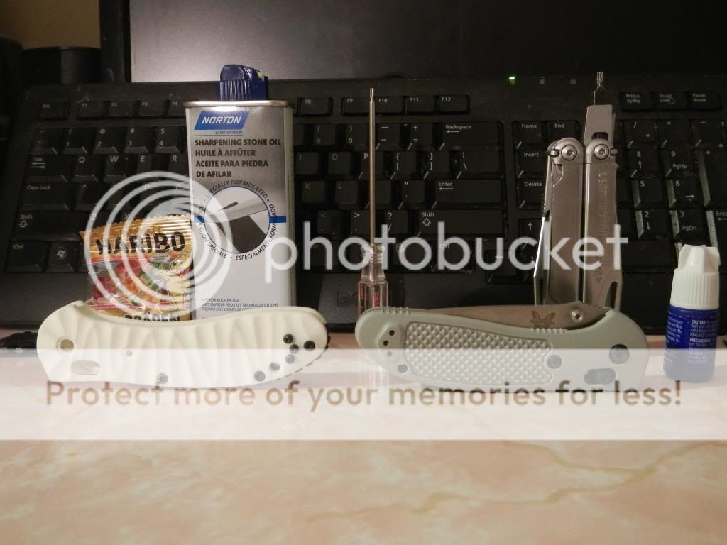

I have Norton's mineral oil used for the stones, and blue permatex threadlocker. Should I be all set? (I should mention that I like to use my blade for occasional food prep. Bread, veggies, and etc.)
Looks good, should be fine. Don't choke on a gummy bear....that would be simply unbearable :rolleyes:

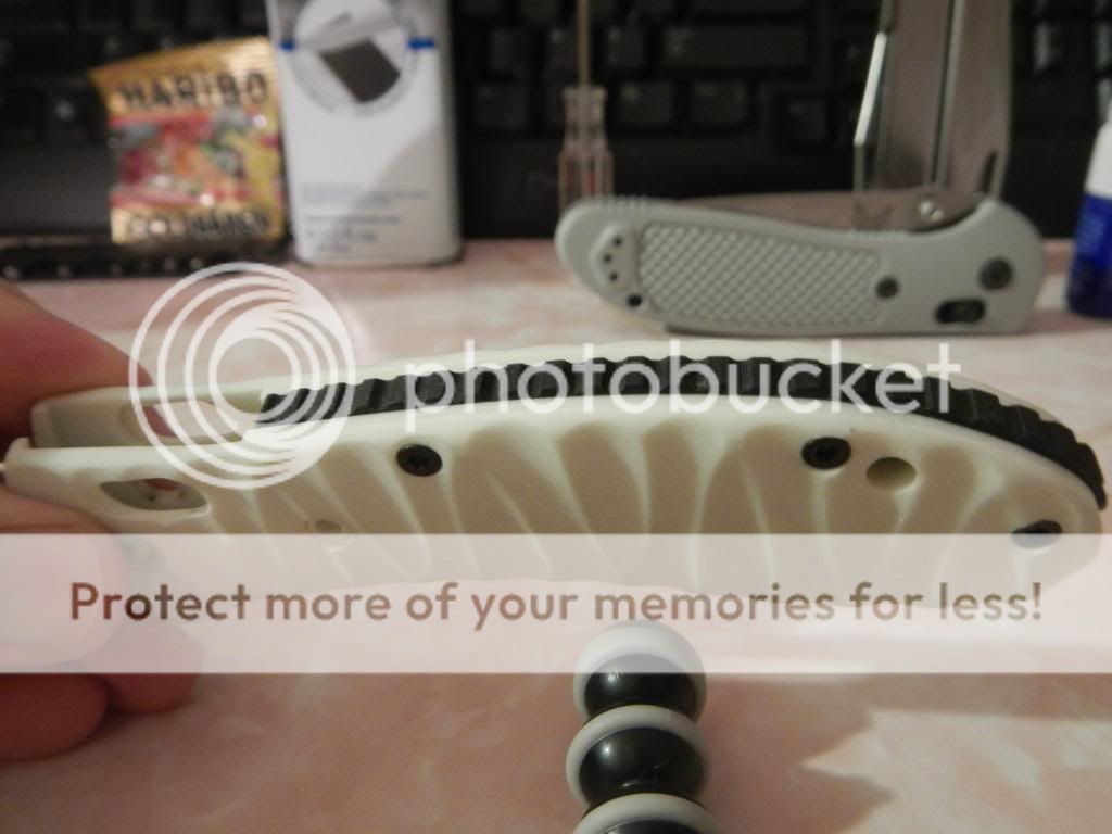

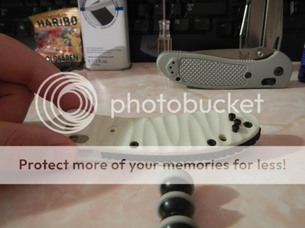

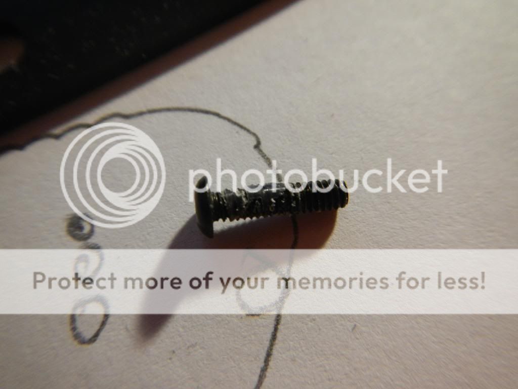

Jesus christ...does Benchmade use JB weld for loctite? I'm getting carpel tunnel trying to scrape this crap out.

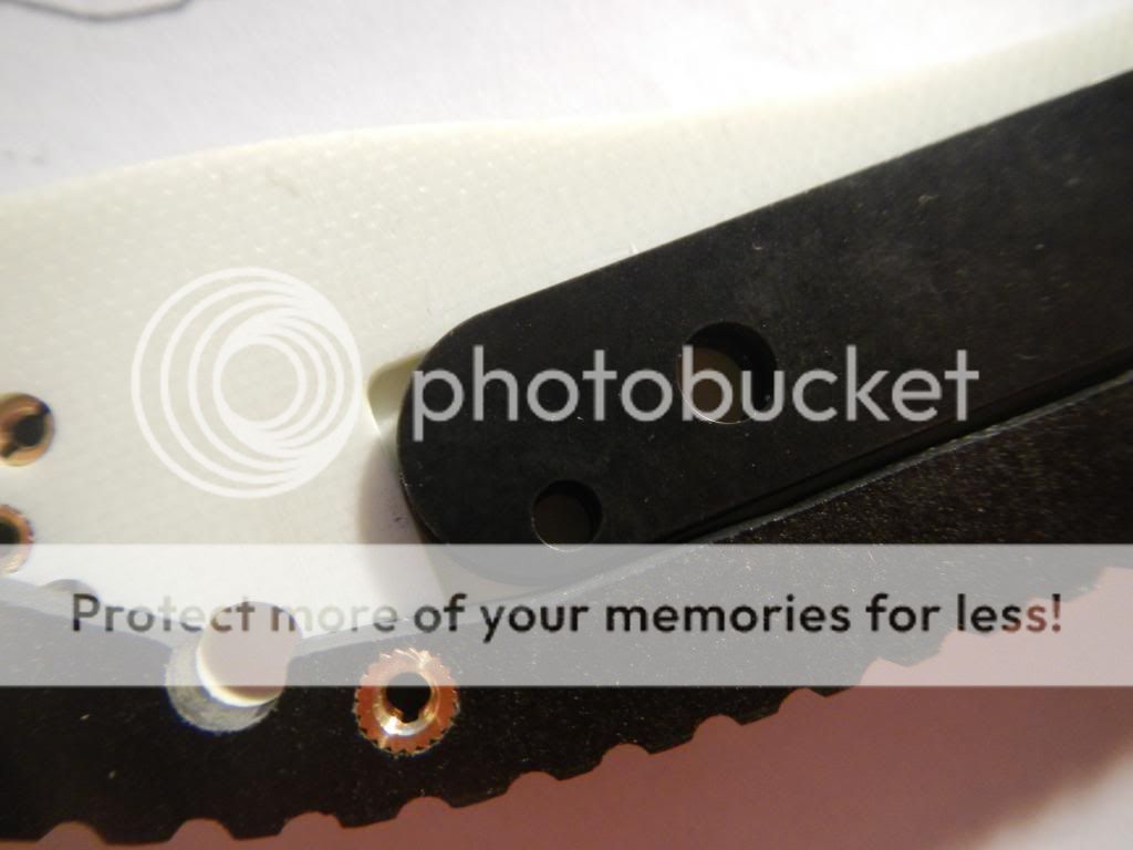

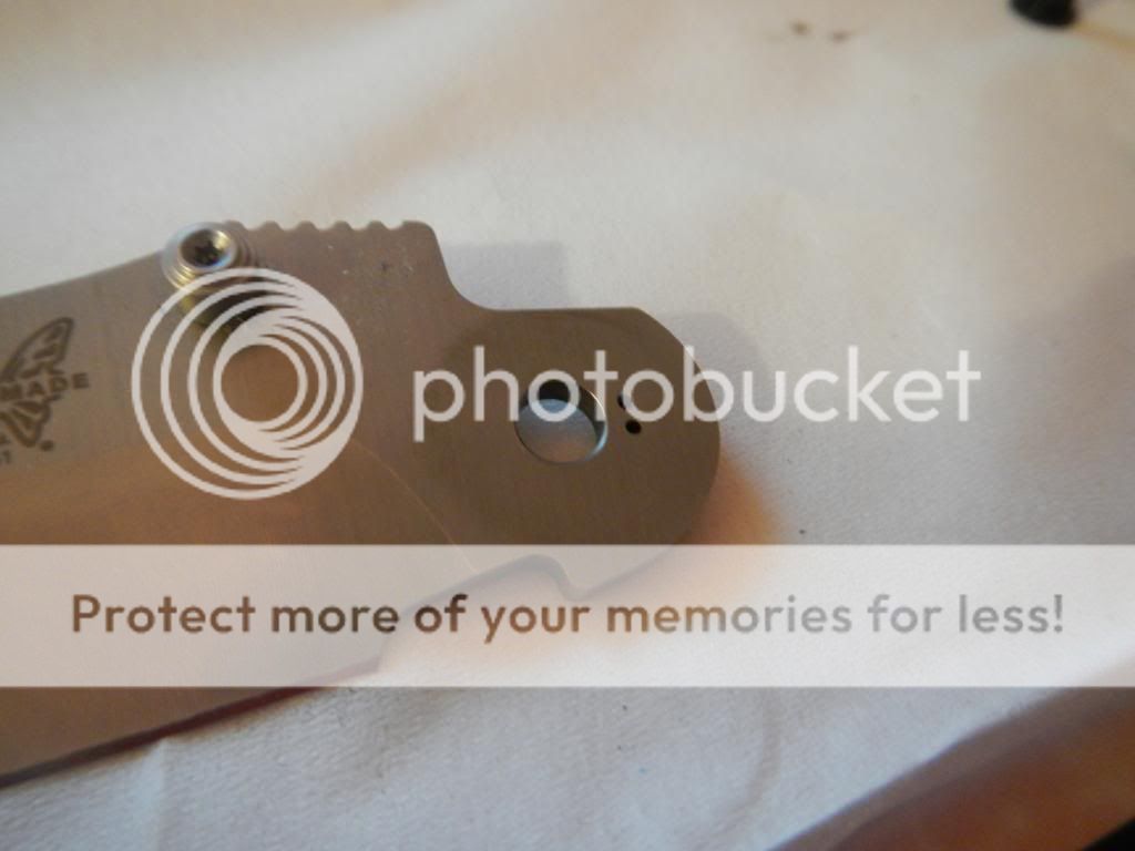

Also, just out of curiosity, what are these two holes on the blade tang? I didn't see any on the blade in the breakdown thread.

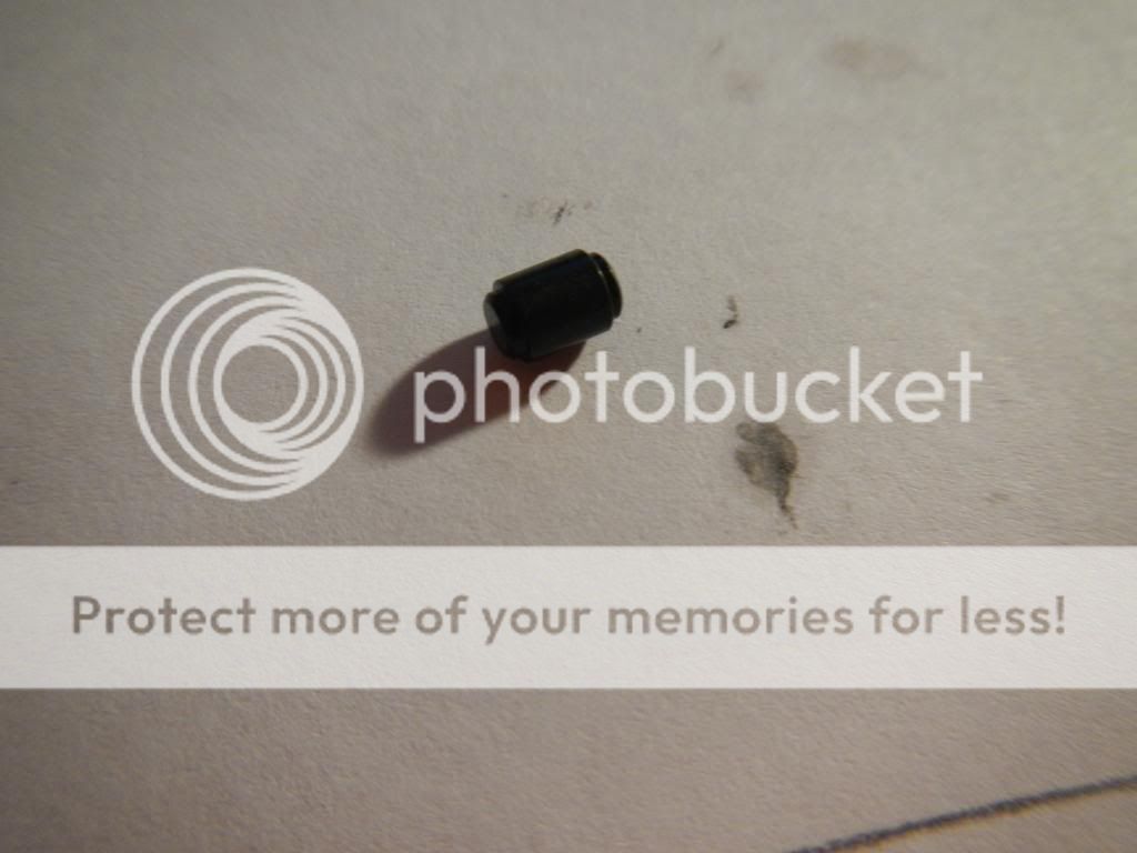

3. BE CAREFUL WITH THE BACK SPACER PIN FOR THE AXIS LOCK CARTRIDGE. Here's a pic:
This is the pin.
And this is where the pin goes
This thing will fall out a lot during re-assembly if you're not careful. (Edit: also, get a flashlight...that thing is a B**CH to find without one) Try to get a set of needle nose pliers before doing this, because you will not want to take the cartridge apart every time the pin falls out. Re-inserting them with the pliers will be much easier and much less aggravating. (Again, the Leatherman was invaluable on this too. If you don't have one already then you need to step it up people :p)

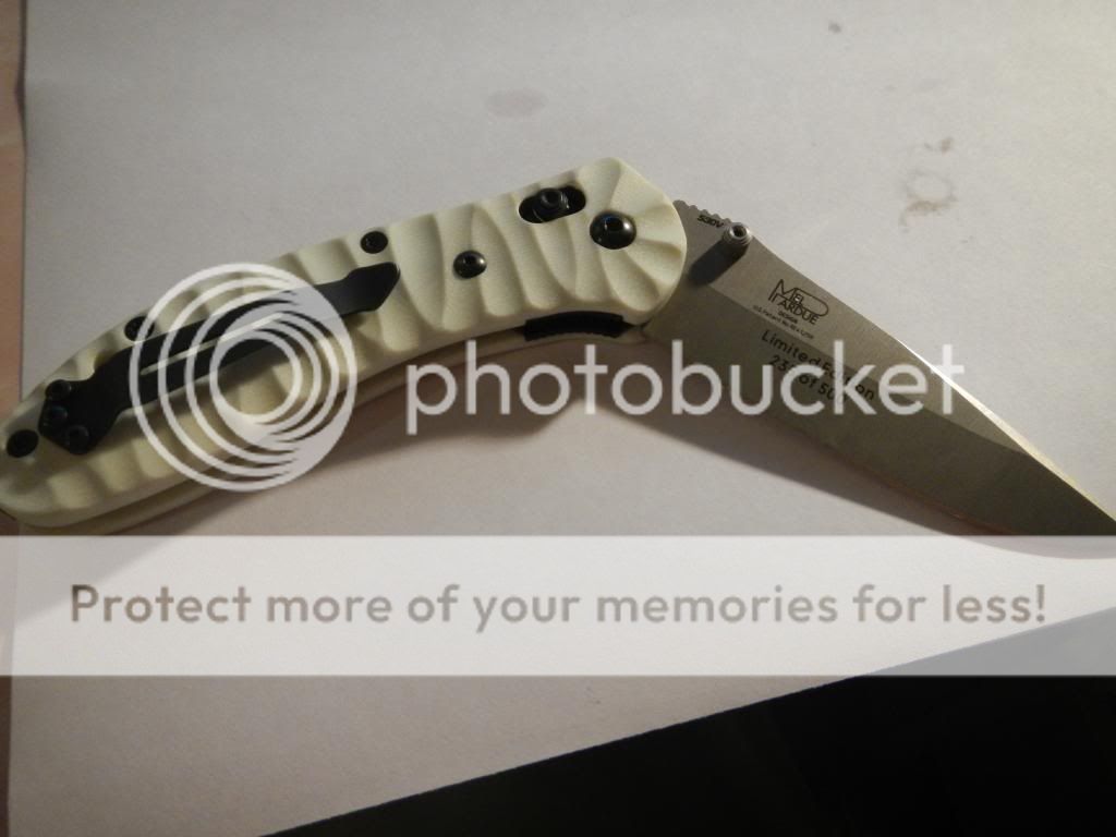

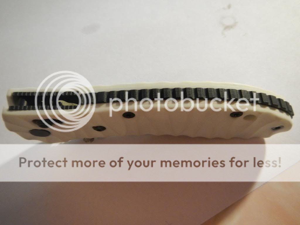

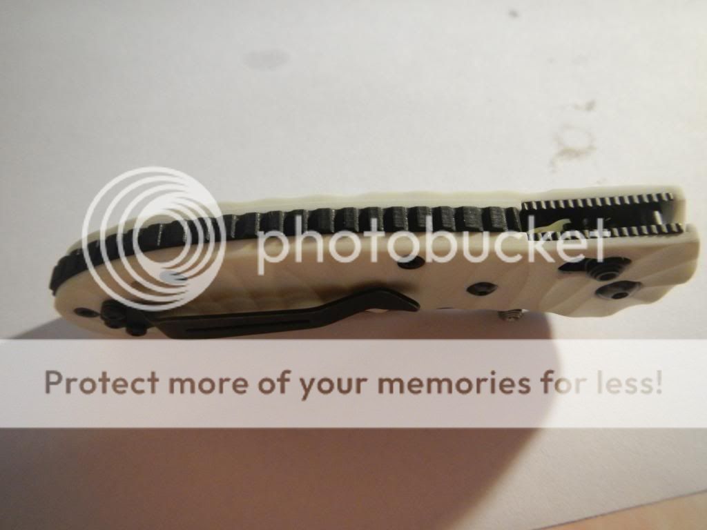

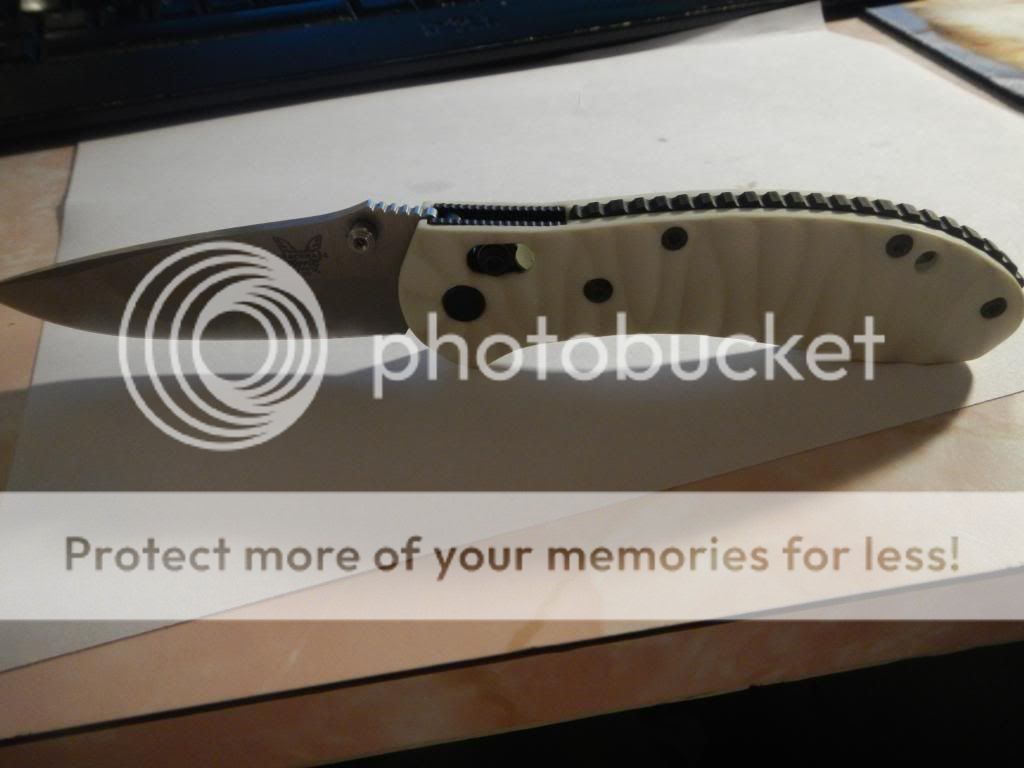

4. ADMIRE THEM SUCKAS AFTERWARDS. Pics in next post.
You know what else I figured out? I was working with my fingertips slightly blackened with grease from the knife and whatnot. I was trying to be careful with touching the scales because they are white...but ended up manhandling it towards the end because you can't be dainty and get the job done at the same time. These white G-10 handles held out very well though. I don't even see any noticeable black smudges or anything. +1 to G-10!
