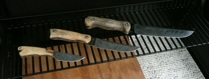

Beautiful spoon handles. Did the wife ever yell at you for that?

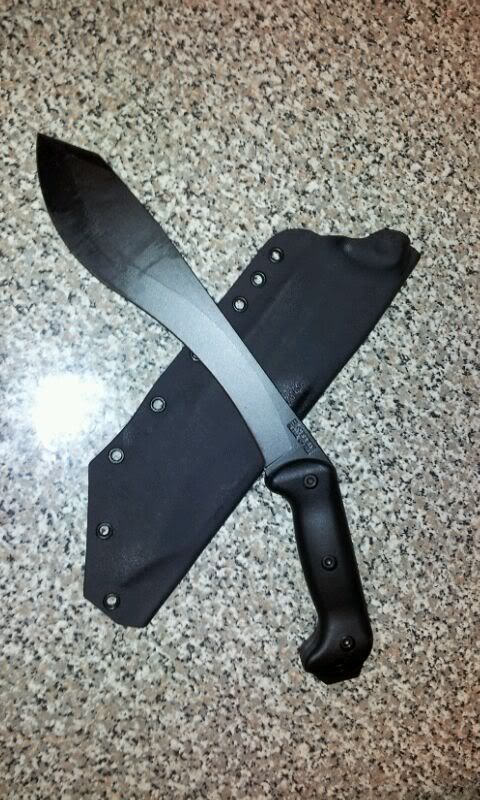

....and my BK-4 "daizee inspired" warrior:
My Celtic 9:
man, GSoM, that 4 looks so good, I went ahead and clicked on the link...nice job! It looks like a modern-day Kopis, something to scream "Sparta!!!" while hacking away...I might have to do something to mine, haven't used it too much.

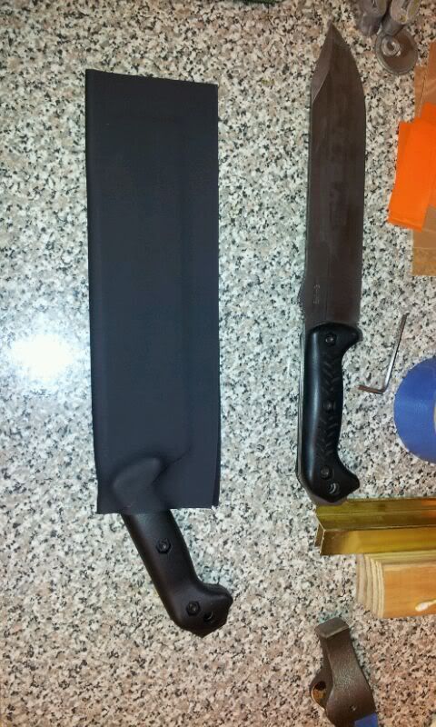

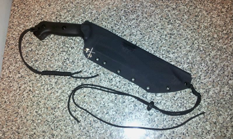

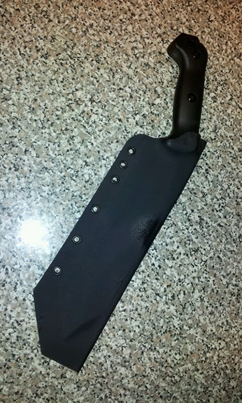

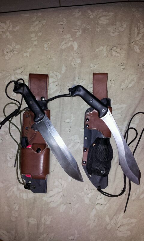

I made a kydex sheath for my 4, it's kinda tricky when you work recurves but not impossible. Put the 4 over some thick cardboard and trace the curve from the ricasso all the way to the widest point of the belly. Draw a straight line back from that point towards the handle (but keeping the same width as the belly) and then cut that piece of cardboard, tape it in that position to the blade, essentially filling up the gap and allowing space for it to be drawn out. Let me see if I can find the pics.
GSoM, here's how the kydex for the 4 looks
the knife "pocket" inside the sheath is straight, kept like that with the cardboard "filler" at pressing the hot kydex
I know that azwelke makes an open-backed sheath, but I don't like that style. Seems like you have to be very precise when re-holstering, and the potential for slicing yourself in the dark seems quite high. Not knocking on his work, don't have stuff from him but everybody who has is a happy camper. I just like mine better :D
I have a sheath from Al and it's the bomb. But I didn't want open back either. Thank you, thank you, thank you for posting up these pics and the hints - I keep thinking something more sturdy like 5mm lauan, but couldn't figure out how to make it work. That is some damn fine work there, zuluninja.
