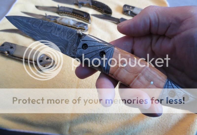

I’m sure you’ve seen these knives listed on the auction site categorized as custom knives. I was pretty curious about these knives myself. I knew they weren’t really custom knives and were made in Pakistan, but I decided to buy a bunch just to see what they were like. I’ll also tell you up front, I’m not writing this to change anyone’s mind about these knives, but rather give those that are interested some information.
Each of these were bought for $39 or less, shipped ($39 being the most and $32.00 was the least).
After getting these and examining them, the first thing I noticed was that even though they were purchased from different vendors, they shared many similarities.

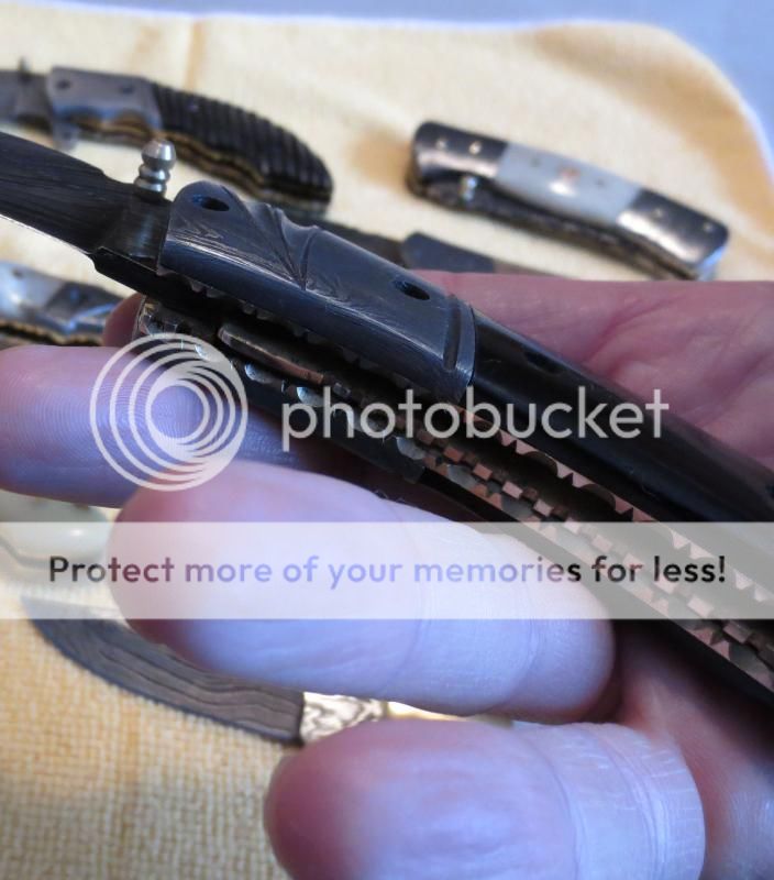

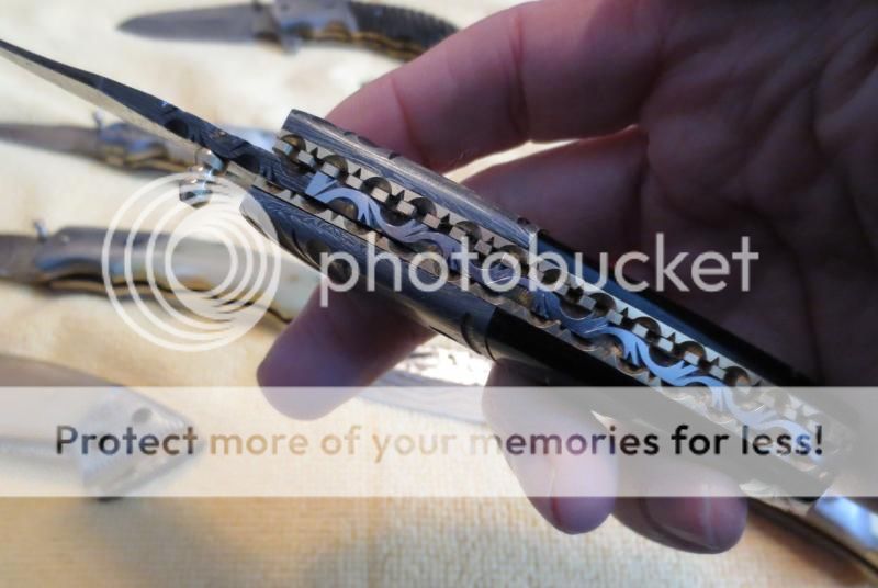

For instance most of the liner locking knives were designed like nothing I’ve ever seen before and even though they were purchased from different vendors they were identically constructed. The frames and locks are all brass and most of them have file-worked steel back spacers that resembled back springs. I’m thinking that maybe these same parts are used on lock- back knives too. The back spacers look nice but really serve no purpose other than to act as a blade stop and add weight.
Another thing I noticed was the hardware; including the thumb studs were similar. Even the way the studs are peened onto the blade looked the same.
So I came to the conclusion that these are probably kit knives and the parts are being sourced from one major manufacturer in Pakistan. But assembled in smaller shops there as well.
The quality of the materials being used is similar on all the knives; however they are not all put together equally well. The scale materials are all organic; horn, stag, wood or bone and the blades were all reasonably sharp, with a few being razor sharp. The Damascus is generic Pakistani quality, but the blades and bolsters are folded steel of some sort and not a faux etching. Surprisingly, the blade steel seems to be of reasonable quality, no scientific testing, but the steel was hard when passed over ceramic rods.

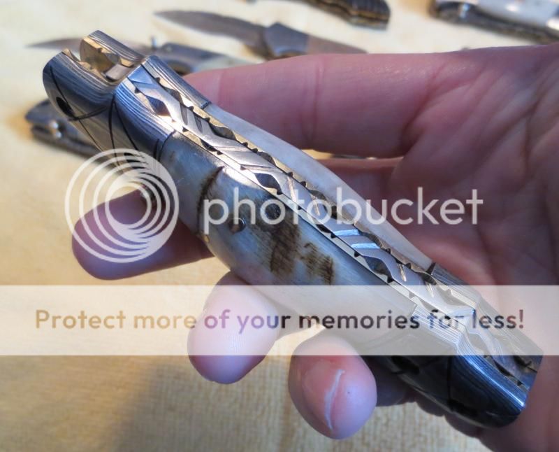

Of the bunch, two were considerably better than the rest. They were just built better and the file work was of a higher level of detail. On the flip side a few looked hastily built with off center blades and careless assembly. Some have washers in the pivot area and some don’t.
Ironically they all came with sheaths that were pretty nice and worth at least $10 - $15 on their own.
The lock back knife is constructed pretty well, no wobble and the stag is nice and fitted well too.
So in summary, these are definitely handmade (some hands are more skilled than others) and have a rustic look about them. I would say that these are best used for show or as desk knives.

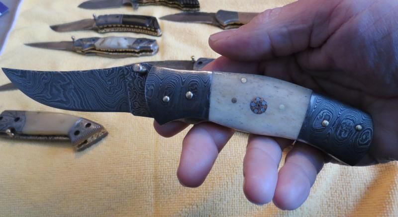

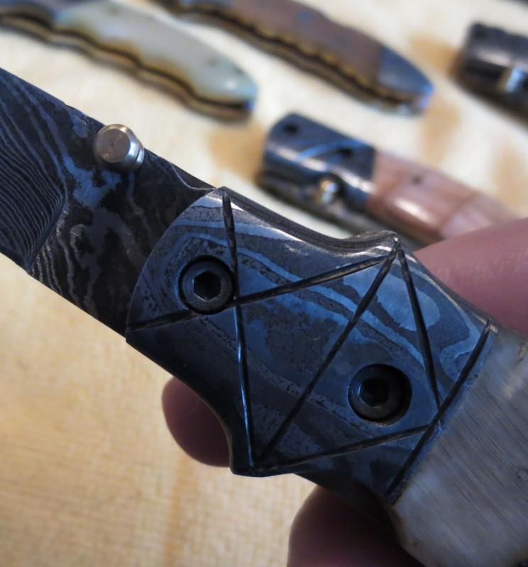

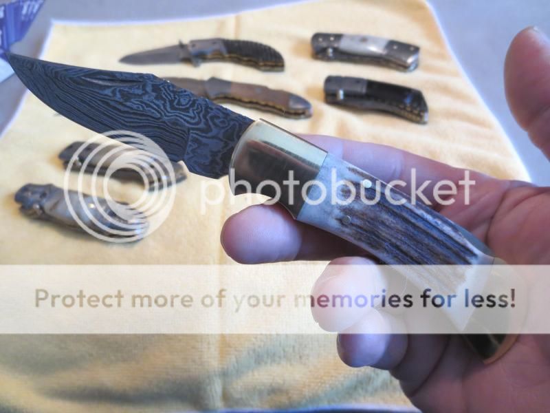

These two are the best

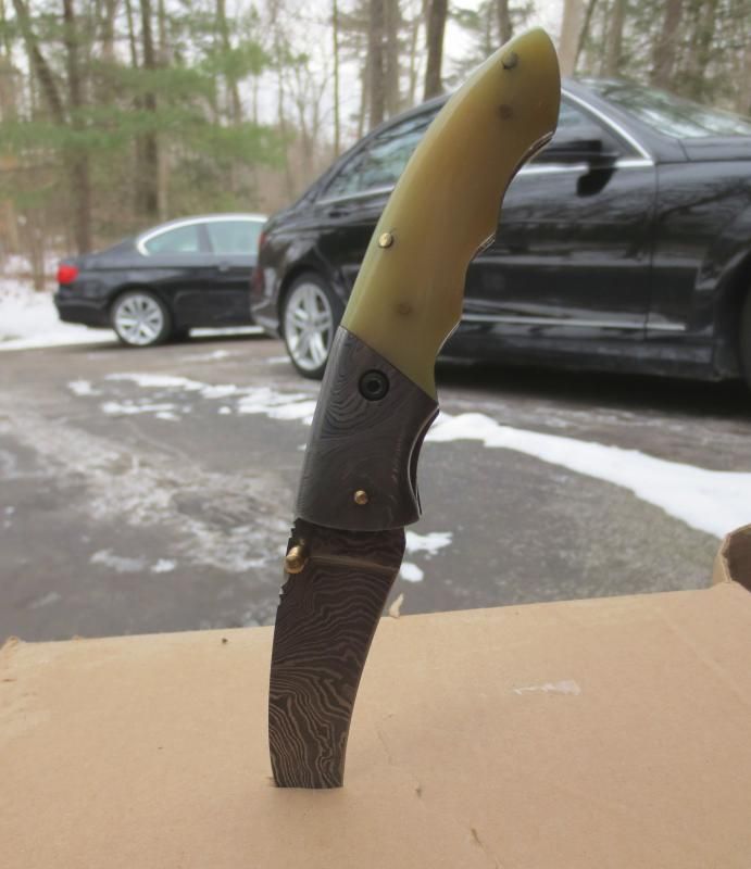

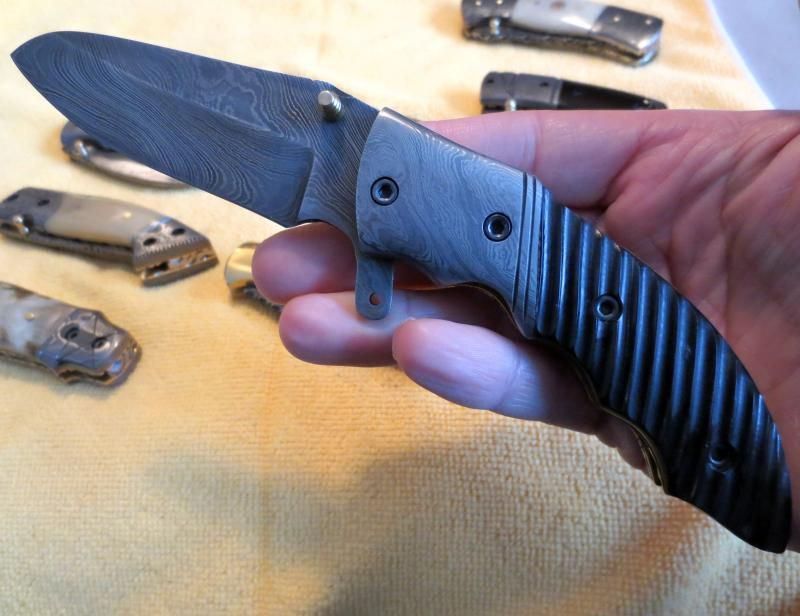

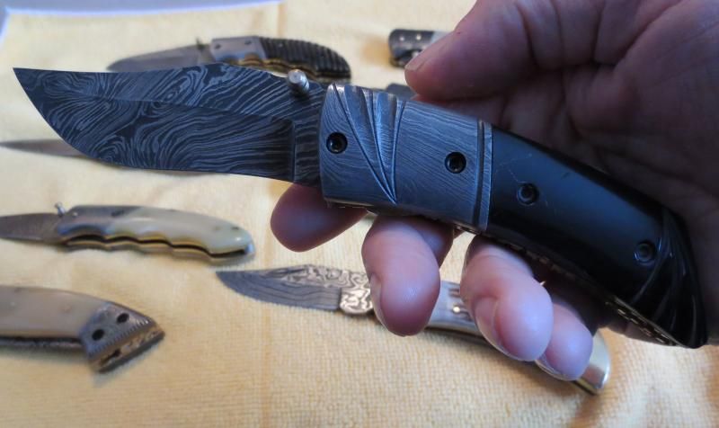

Some of the others

I wouldn't pay more than $30 for any of them and one of the reasons I posted this was so that other members don't get ripped off.
If you look at the pictures, they resemble knives being sold as customs for over $100.00
Ironically, one of the two knives that I mentioned above as being the best , was actually one of the cheapest. It was about $32 shipped with a very nice cowhide sheath.
As far as lockup, they're not like other liner locks. The locks just prevent the blades from closing. There is no "ramp" on the blade tang, they're flat and the lock makes very little contact with the tang. The tolerance on some of them is close enough so that there's no play. But on some of them there is a little play. Brass being as soft as it is would probably fail under any stress, but the blade stops are strong.
Also there's no ball detention, they stay closed just by pressure and some are tighter than others. The knife above with the flipper is the tightest.
Of the entire bunch about half have a consistent level of quality and the others don't. The lock-back knife above is constructed as you'd expect a lock-back to be.

The knives pictured in the first two photos were the best in terms of construction.....blade grinds, sharpness etc. The very first one is my favorite of the lot, I bought it because it was pinned together and had a separate liner as a lock and not just one side of the frame crimped as a lock.

That being said, do you have any plans to do any cutting tests with any of them? See how the edges hold up, etc.?

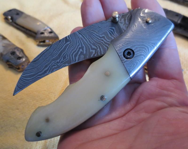

I'm going to try the one with the hawkbill blade.
It has a thin blade and I was able to put a good edge on it.
Most of the others are pretty sharp , but have very thick blades.

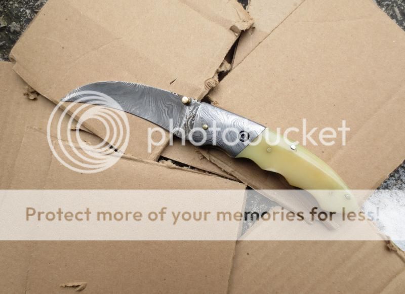

**Update**

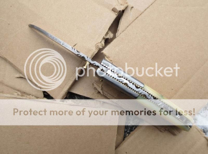

I picked out the hawk bill liner lock as my test subject. The blade is a little thick at the edge and will need to be re-profiled, but I did sharpen it more. The steel seems to be pretty hard, I started with ceramic rods, but was not making any progress so I switched to a diamond hone.
I got a good working edge and was able to shave hair, so I started to cut up a cardboard box. I broke down a medium sized box , but the thick edge and not the sharpness was the negative factor here. You can see some of the tearing in the photos.
When I was finished , the edge needed a sharpening , but was not blunt.
As an added test I wrist flicked the knife a few times to see if the blade stop or tang was soft, it held up.
And so when I was done there was no blade play and it locked up fine. I will try to re-profile it in the future. The shape of the blade is a pain to sharpen.
