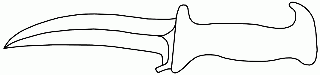

Here's my design. It's fairly similar to the Omani, from Laci Szabo, but with some obvious differences. I also don't expect it to cost $400!
A bit more of a guard to keep the hand from slipping, and the blade bends forward just a bit, with just the slightest recurve. And the gut-hook type thing on the back. Seems to me, when cutting pickle-style, if you push the blade in too deep, if there's a choil or unsharpened portion of the blade, it can get caught, and you stop cutting. I've had this happen, test-cutting stuff with my Emerson LaGriffe. Hence the gut-hook like thing at the base of the blade. That way, it's pretty much guaranteed you'll keep cutting, unless you hit bone or something. I really hope the kamis can produce such a complex shape. But I figure it shouldn't be much more complex than making a cho.
The edge depths should be about equal, like a dagger, since it's intended to be suitable both for pickle, and for standard edge-out slashes. The radius of the inside edge should be about 18" (i.e., if you had a circle 3 feet wide, the back edge of the knife would follow the circle's curve), as this is about halfway between the size of the circle made by rotating the elbow, and the one made when rotating the shoulder. This way, the curve of the knife follows the natural movement of the arm, when stabbing.
My cardboard and modeling clay prototype has a blade length of 5.5", handle length of 5". On my monitor, at least, the pic is life-size. Good size, though a bit hard to conceal. Thickness, I'll leave up to the kamis. Needs to be thin enough to cut deep, but thick enough not to break under the rigors of combat.
