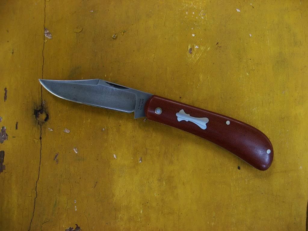

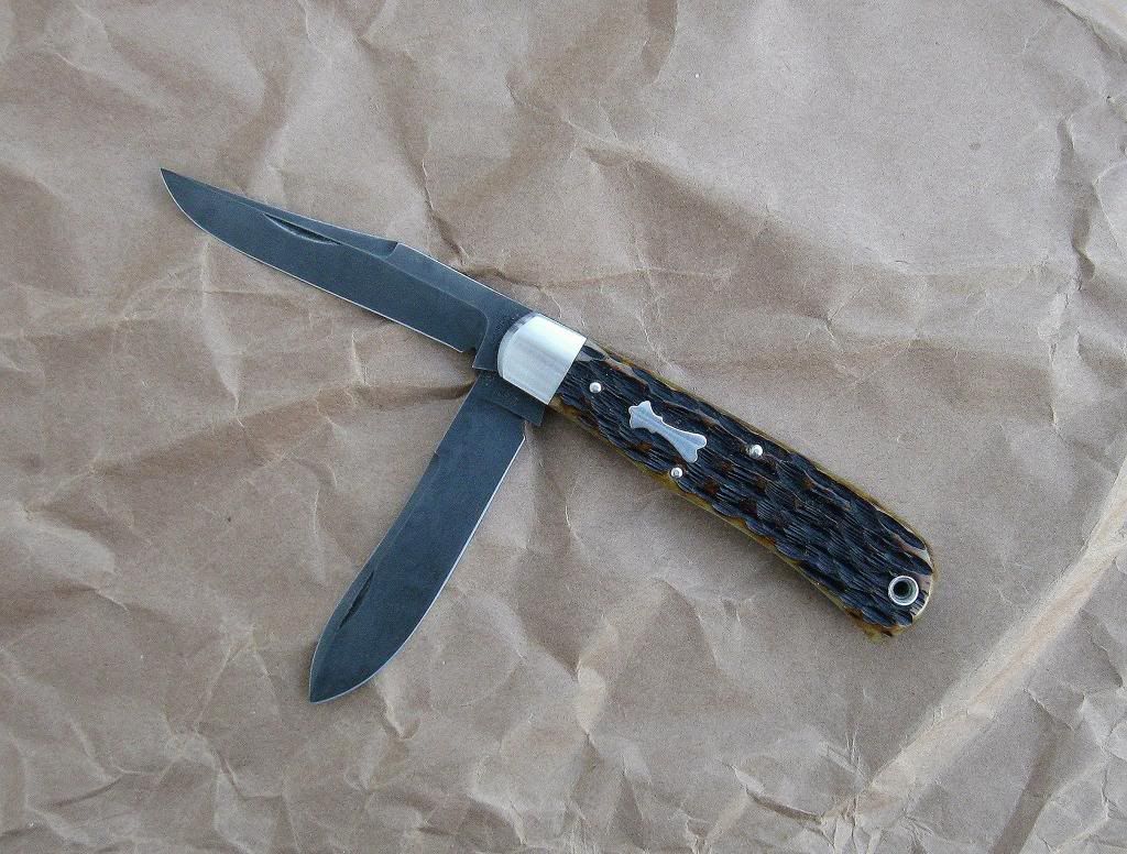

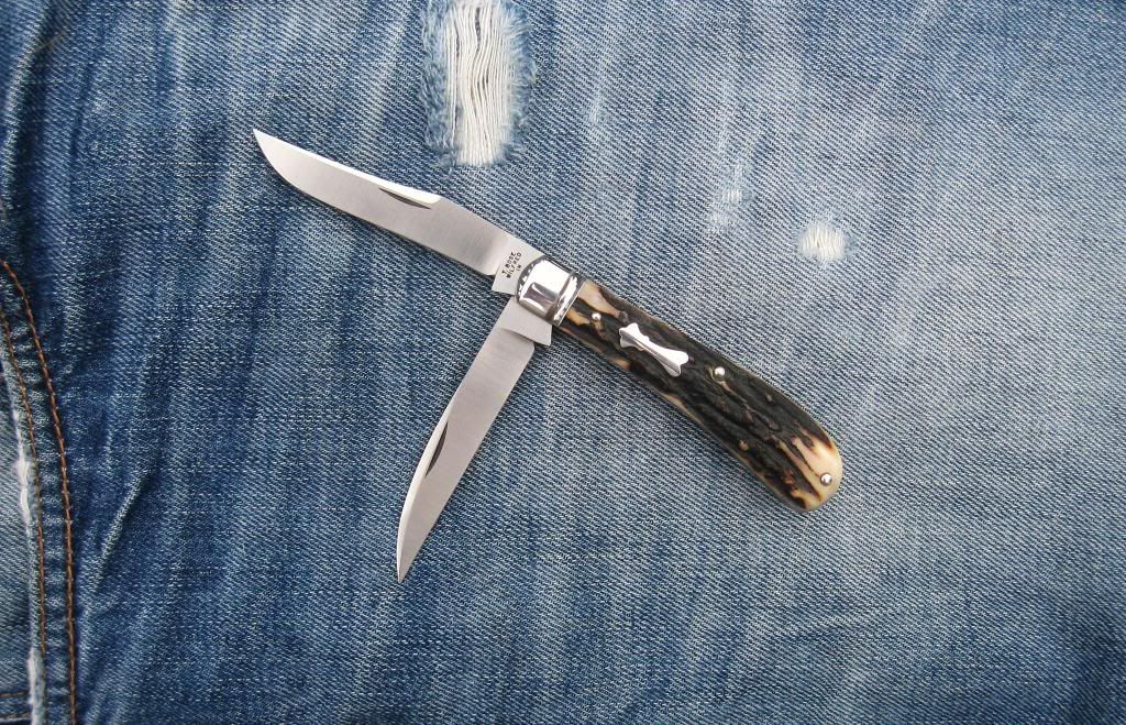

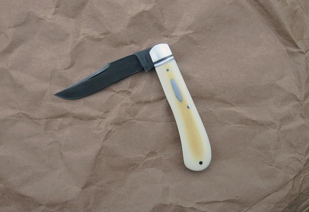

I like some stainless steel, 154cm, cpm154, ats-34. But I really like carbon steel blades on my custom knives more than anything now! I've had lots with stainless and a few with carbon
steel, A2, 52100, and my newest carbon steel is W2. If the carbon has a good heat treat, thin grinds, there's nothing better..imho. As for looks, I think carbon steel looks great with a natural
patina or etched blades. Here's a few of my custom knives with carbon steel.
Jason
W2..
A2
A2
52100

Based on these pictures, your taste in knives and mine are just about synonymous.
Those are beauties!
