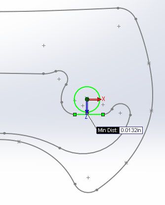

i'm assuming this is the "trouble area"
.013" isn't a whole lot, but should be achievable.
