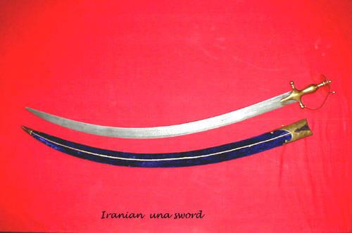

we manufacture custom made gold engraved swords-visit link

Nice swords by the way.

Are your knives and swords decorative or are they actually designed to be used?
I'm curious about this. I've been to your website and you folks have some extremely intriquing cutlery. What steels are used in your Damascus?
So, are they users or wallhangers?
What steels do you use in your Damascus?
my apologies for the delayed reply.we use high carbon steel 440 c -these are users only we try to make them factory finished or non-sharpened so they are not held up while shipping but can be sharpened too.

Good news that they are 440c and they are users.:D
Now, what steels are used in your Damascus?:confused:
440C? In swords? Correct me if I am wrong, but 440C is a stainless steel and, by all reports, stainless does not make very good sword blades as it does not seem to hold up well to the extra stresses that come with the repeated impacts that swords take, remembering that they are long, unsupported steel blades. At least that is my understanding from my reading in a number of books oon the subject and my reading of the experiences of the fplks over at SwordForum and at NetSword.
Damascus is a type of steel. It usually consists of a blend of two or more types of high Carbon steel. Your site advertizes Damascus steel.
I'm just intersted in what types of steel are being used to make your Damascus.
If it's just 440c, it cannot be called Damascus as 440c is just one type of high Carbon steel.
I apologize if this is confusing.:(
