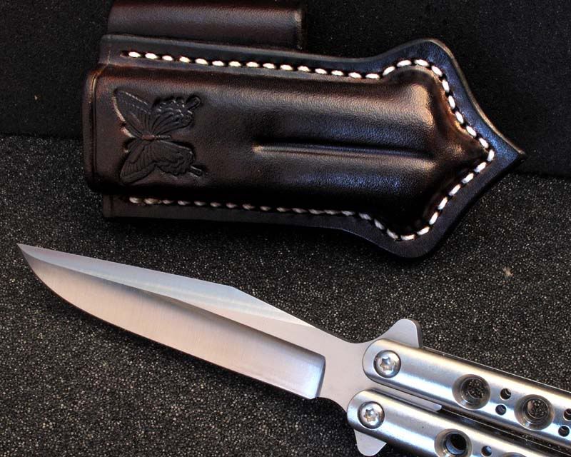

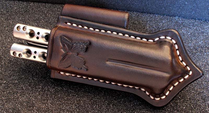

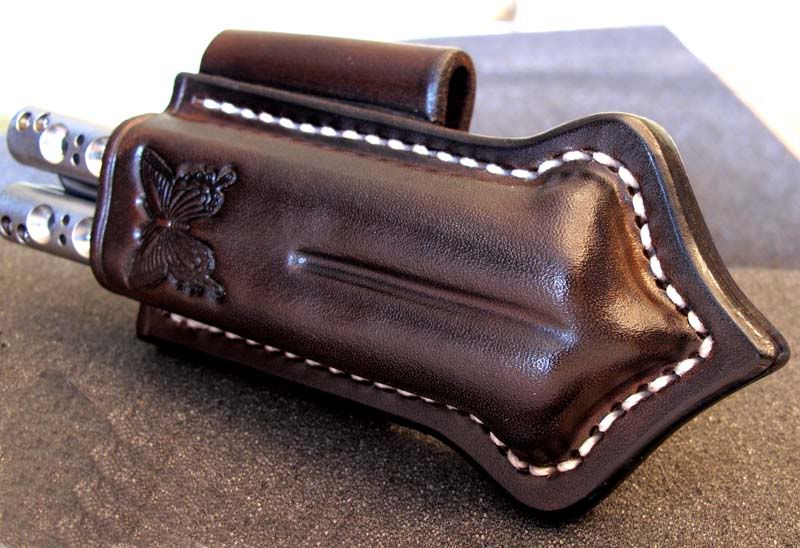

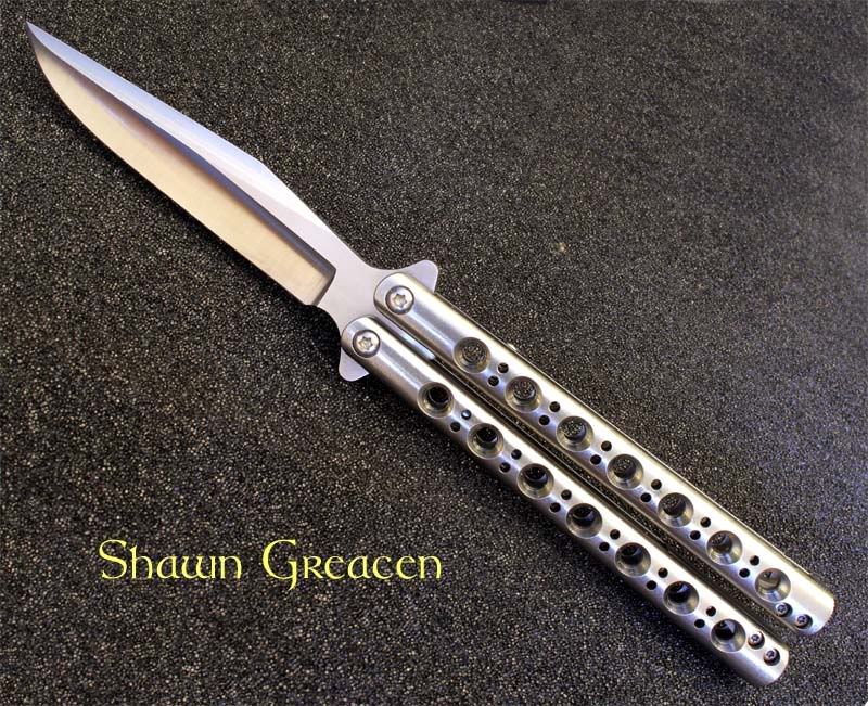

Shawn Greacen, aka balibalistic, made this great latchless bali, I was asked
to leather her up a bit, the horns are a bit wider than I like for this type of sheath
as you need to allow them to enter into the sheath, and if you form too tightly
you can't get it back out! But I allowed the leather a little breathing room and
she fits up nice and snug and you can get her out as well.

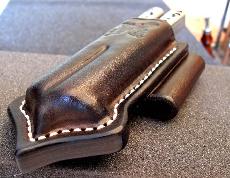

The hidden pins done make for a different tang, as you can see I had to shape
the leather around that point, but it adds a nice, graceful look to the sheath, at least I think so ;)

a tip for those that want to try a sheath where you have a distinct point
I start the holes for the threads at that point and work backwards each
way to the front of the sheath, this way the spacing doesn't get messed
up as you wind your way around the sheath, you put them where you know
they have to be first and work from there.

Thanks TF, be glad to help where I can and as you say it's the clean and simple
but it does take some grunt work to make it so, the main tip would be patience
in the forming process and dyeing as well as the sewing, not to rush it, but to
work hard and keep working the leather until it's dried, I ususally let the top section
sit for about 20 to 30 minutes between forming, and I keep that up until it's dry.
