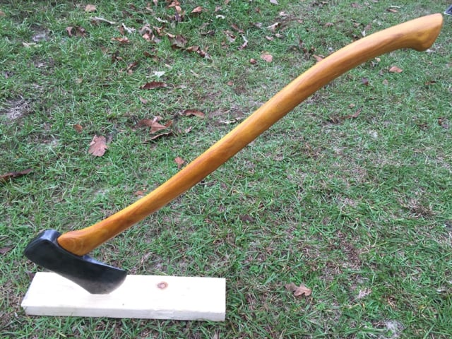

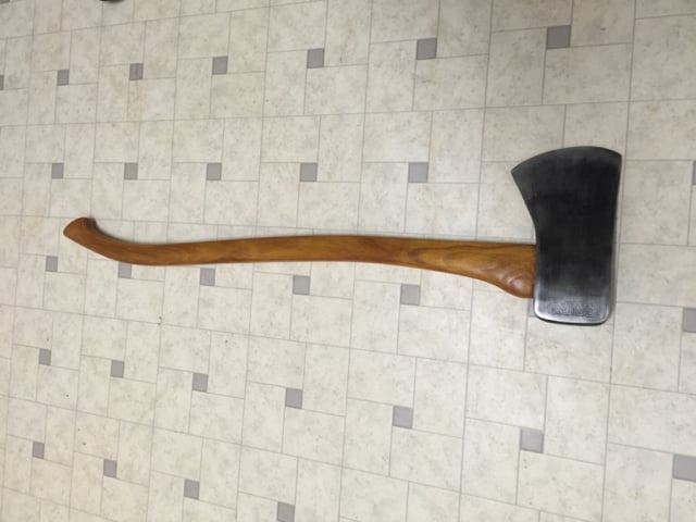

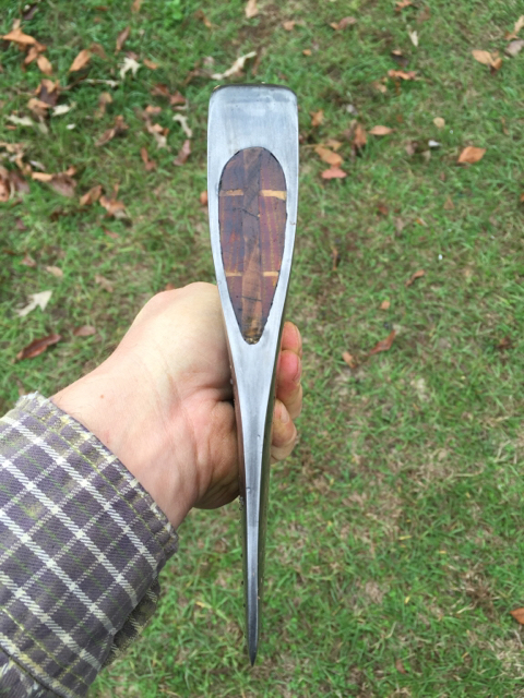

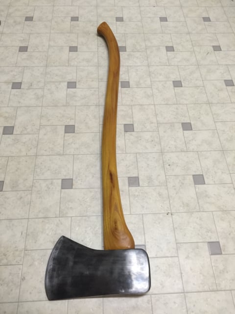

I can make you a single bit axe handle to this length. I just made a Osage orange handle that is 31" on a Lagitimus 3.5# head.
Nice job on these! Handles from scratch are a lot of work especially when entirely done by hand. How you'd adequately price stuff like this (and not lose your shirt) escapes me. What's your secret?
It all depends on the wood. Take Osage orange for example. If you can get it easily and have a mill cut you boards it won't cost you much per handle. If you have to search the Internet for suppliers that can ship you the wood you are going to pay for it. The board I made this handle I payed 100$ plus 50$ for shipping. I was able to get several good pieces out one board. If you miss your cut it will cost you. Measure twice and plan and plan again before cutting. Osage can be your best friend or your worst enemy. I suggest you make a couple of bows out of the stuff before making a long axe handle.
If you insist on making a axe out of it and you don't want it to break right away and you don't have experience around Osage you need to buy a bow stave to make your handle out of. Make sure it is wide enough. Most staves are not wide but the grain is correct for a long handle. I also do this not to become rich. If I can do this and just pay my way it's worth it to me.
Can you send me a p.m and give me an idea of how much it would cost?
Thanks. That is very nice work.
I can't figure out how to pm on this sight.
This particular axe I'm selling on eBay for 260$ or best offer.
Axe handle price depends on length and type of wood. Osage is tough to get and tougher in a long length. If you just want a handle similar to this that is not hung on a head. I would do it for 150$ plus shipping. A hatchet can be done for 75$ plus shipping.
