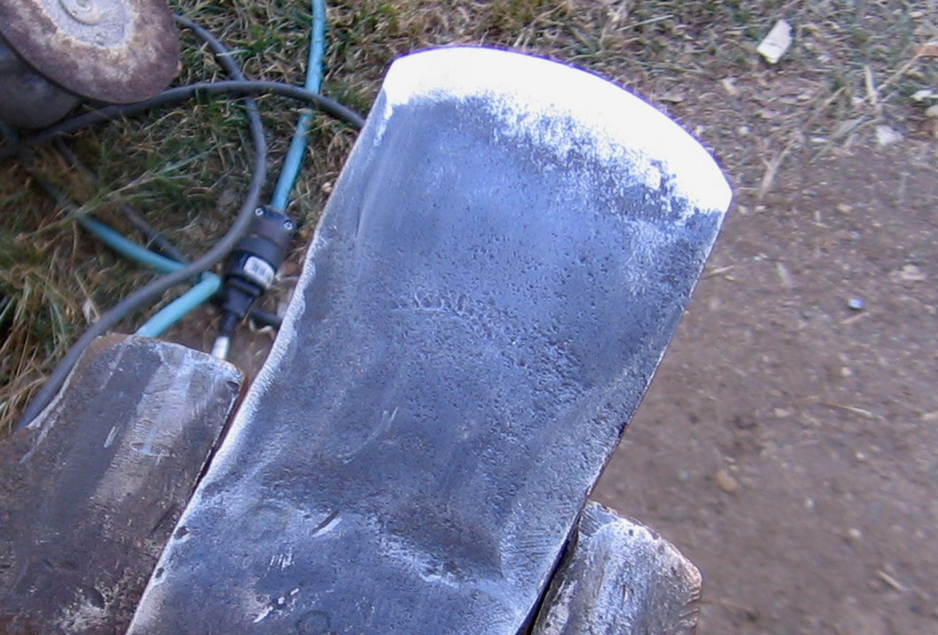

Peg, I REALLY like what you did with that D. B. handle. The head looks a lot like a Puget Sound, but not exactly.
Thanks, Bernie. It's a PS falling axe but I've never been able to identify the maker. The stamp is only partially visible. Looks like an arc of tear drops - perhaps the top of a crown.

Nice job on these! Handles from scratch are a lot of work especially when entirely done by hand. How you'd adequately price stuff like this (and not lose your shirt) escapes me. What's your secret?
I ended up selling the axe for $160
I made $100 after buying the axe head.
Had about 8 hours into the handle and hanging it. Not to mention the price of the lumber. The best thing you can expect is to not wear a shirt when making handles. HaHa
