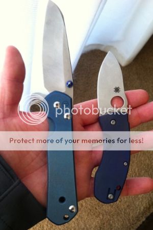

Livewake who did your blue?
YouTube "TSP anodizing"

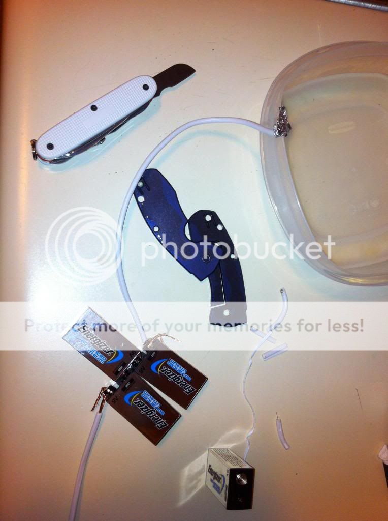

Trisodium phosphate (TSP) is a cleaning agent used on siding, decks, and paint. TSP can be had at your favorite home improvement store in the paint aisle. TSP, water, batteries, a couple of leads (in the pic I cut up an extension cord) and some aluminum foil. Takes about 20 seconds for this color. 3 9v batts on the Techno (indigo) 4 9v batts on the Sebenza (denim blue)

Awesome thanks! I will be checking that out. Can you see the color taking place. Like if I wanted denim can I see it turning and then pull out before it reaches Indigo?
Indigo is achieved at a lower voltage(3x9v). Denim with higher voltage(4x9v)The voltage will only take the color so far. Google Ti anodizing spectrum and you should find a list of voltage and corresponding color. 4 9v batteries will go denim, however you can deplete the batteries and lower the voltage resulting in darker colors (the Sebenza is color faded from front to back on purpose) The color change is really easy to see, and you can pull it out to check. I timed how long they were in just so both sides matched. It literally takes 20 seconds to achieve these colors.
Another note is keep everything not Ti or the aluminum used for the cathode out of the solution. Steel, copper and whatever else you are using will draw all the voltage away from the Ti. You can do 1/2 then flip and attach to the other end and do the other 1/2.

Good so far. I did it about a month ago and I've carried both the Techno and Sebenza. The Techno has spent some time clipped inside my bag next to a flashlight in sheath and does not show any real wear. There is a little wear on the sharp edges but that is unavoidable. You can still see the stonewash under the anodized color so adding more scratches on top just adds character IMO. Easy enough to re-do!

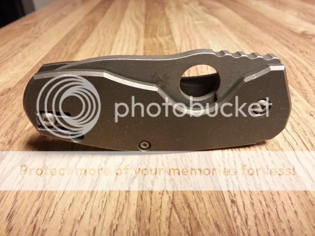

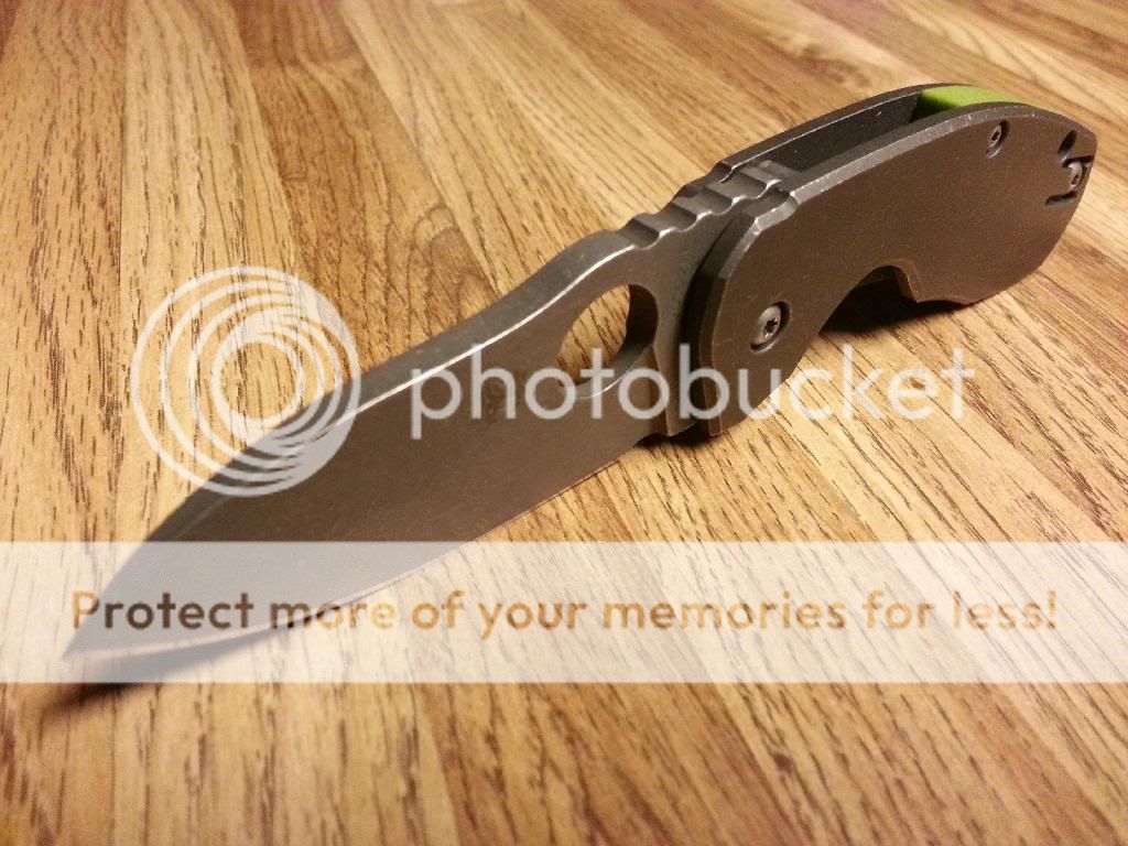

Finally put the Cuscadi smooth carbon backspacer on today:
Also removed the clip, which I never use (and is the only thing about the Techno I don't love due to its shifty nature).
