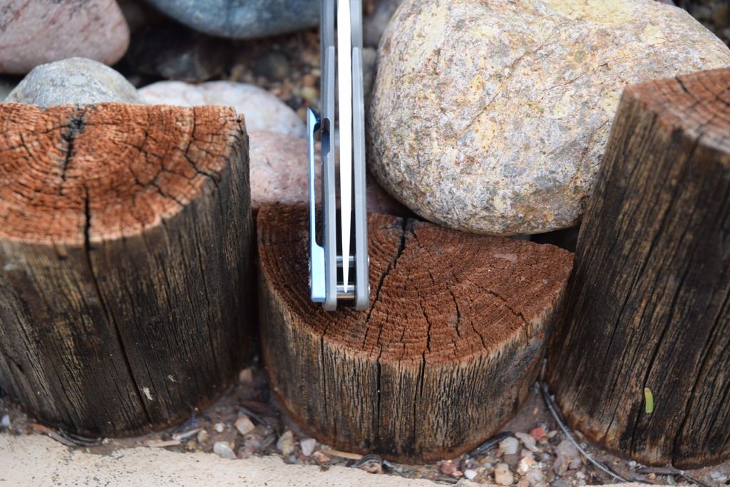

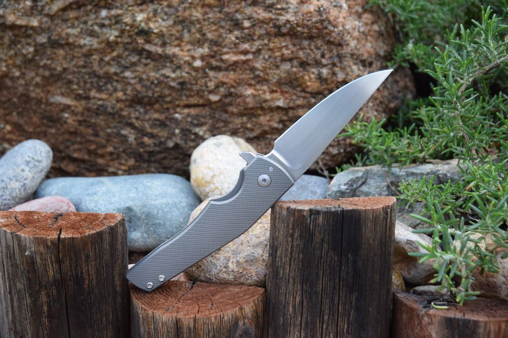

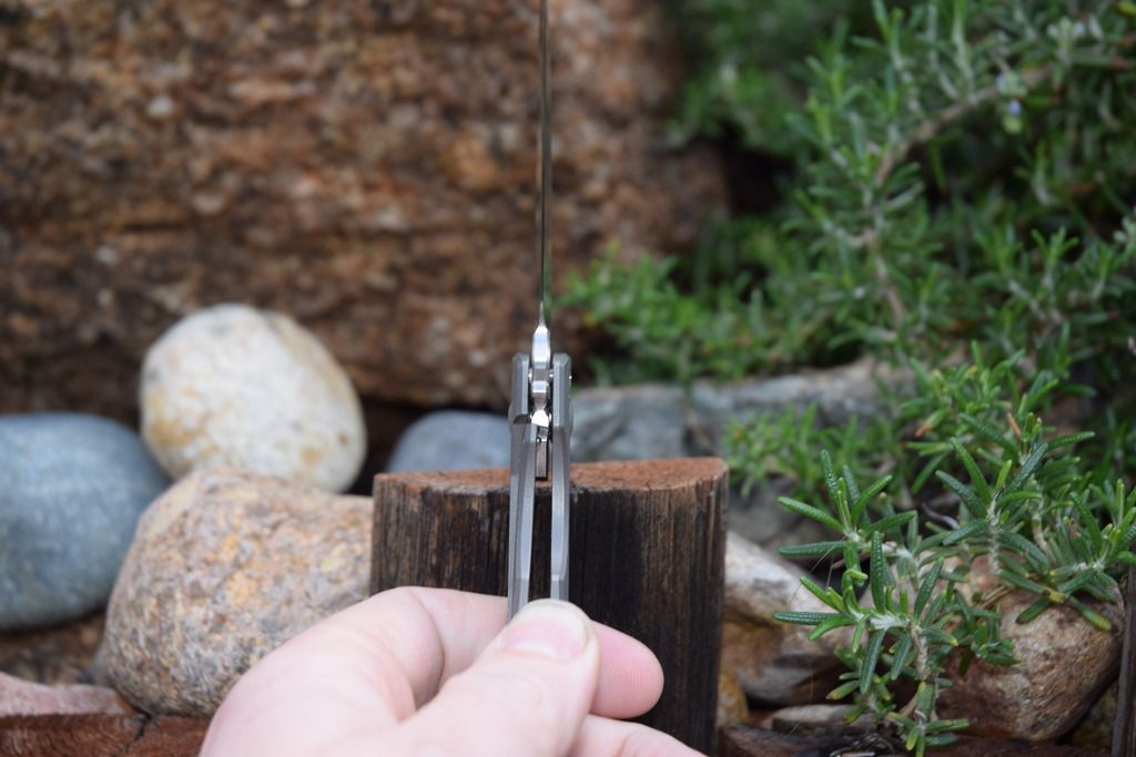

Great flipping action, very smooth.
It's running on caged bearings. Titanium lock face has been carbidized.
Blade steel AEB-L
Blade length 3.25"
blade thickness 1/8"
total length 7.75"
On caged bearings
weight 3.0 ounces
total knife thickness with handles approx. 7/16".

What's the hardness of the blade? Was it cryoed and how thin is the grind? Looks great and would make a nice lightweight etc knife.
Blade is approx. 60 HRC. It was not cryo'd but it was subzero quenched in dry ice at ~ -95 and then tempered back to 60HRC. Its a pretty thin grind. probably 10-15 thou. I'll check it later tonight and update.
