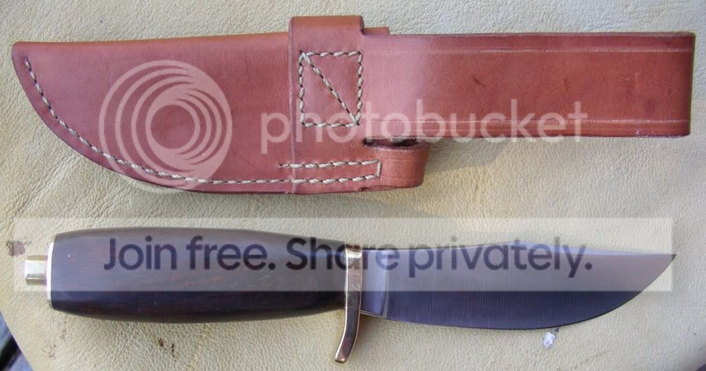

i would like to know if there are any clues to look for when viewing a knife online, that might help distinguish between a kit knife FB and a true custom FB.

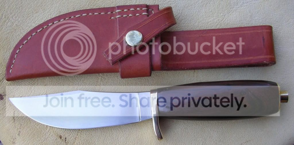

below are pics of an unmarked 8 1/4"(not including pommel nut) FB as an example. the 4 3/8" blade has a flat grind and bilateral swedges, looking to my eye, symmetrical and "perfect", rounded spine, comes to a perfect point and is shaving sharp. it does not appear to have ever been used or re-sharpened.

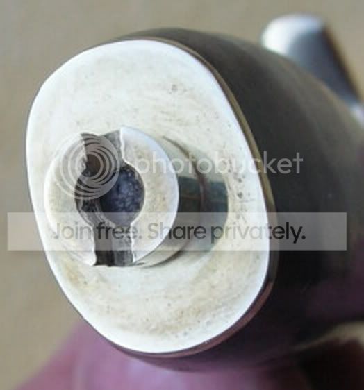

the guard and butt plate are brass and there is a threaded tang secured by a brass nut.
the one piece handle looks like desert ironwood.
the sheath is substantial and well made of thick cowhide and is a perfect fit with the knife.
i am hoping that some custom knifemakers will comment on aspects of this knife and sheath which might indicate a true custom or a kit knife.
besides being interested in the possible origin of this knife, i am also looking for 'pointers' that could be applied to other knives as well.

im going to go out on a limb and call it a kit blade
for the grinds from you post are dead on and great care in making them that way
why then is there mostly ruff handle work? thats not to say its not a good knife but if a maker was spending all that time on the blade to make it dead on i would think that a bit more care and time would also have been spent on the handle fit up
sheath looks nice but im not a leather guy
Heya Roland.... sorry to say but I'm going with Butch and calling that a kit blade. The quality finish of the grinds are a mismatch to the fit and finish of the handle work. There's obvious gaps, there's large grit sanding marks in the handle near the guard, the finish of the butt cap and that pommel nut is pretty much standard from kit suppliers. Someone who can pull a swedge like that isn't going to leave that kind of mess on the handle. Sorry to tell it to ya :(
Quit buying knives late at night man!!!! :p
The sheath looks alright, stitching isn't that hot and hasn't been tapped down or had a stitching wheel run over it. I'm not the best leather guy though but it's a decent sheath.
I'm thinking the same thing. Aside from what the others mentioned, the blade shape is sort of an indicator, too. I think Jantz offers a blank just like that, which itself is a copy/version of a Marble's woodcraft. That's not to say that a custom maker can't/won't use a woodcraft design, I'm just saying it automatically puts doubt in my mind as it being a custom blade. With the other factors mentioned added to this, I'd say it's a factory blade somebody put a handle on. Right or wrong, that's my initial impression.

Oh yeah... it's unmarked.... someone that can grind like that is going to mark a blade at least to my way of thinking.
that is a Solingen "Skinner" knife blade. It comes with a threaded tang and even comes with the threaded nut. I have seen it for sale on the web at places such as "Thompson's Scandinavian Knife Supplies"

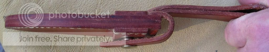

the sheath is really well made. you couldn't stitch through the 3.5mm thick leather, which is 5 layers thick at the throat of the sheath, without a very heavy duty sewing machine. so i presume some kits come with the sheaths already made up to fit the blade.

A maker that can do that kind of grind, especially the swedge, is going to mark his blade. As a rule beginning makers won't mark their blade but the blade will look like a begginer's knife... hope that makes sense.
As a rule, the whole package should be equal... the blade should never be finished better than the handle IMO since woodworking is easier to clean up than metal.
roland
Roland,
Myself and a lot of makers on these forums sew through that much leather by hand. You can use and awl or drill press to make your holes.
