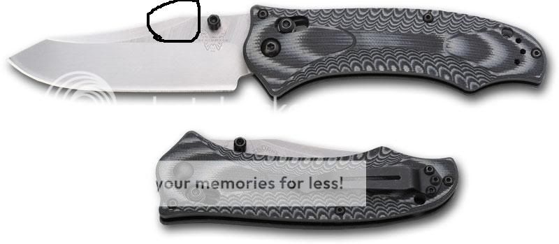

Do you think there is any way to save the thumbstud? For instance, looking around I found this and it looks pretty good.
attachment.php
The 0300 you did Charlie Mike looks pretty good too in the image you posted previously, which also has retained the thumbstud.
That top pic looks pretty cool, except it needs to be rounded just a bit and radiused. On my 300, I only left the thumbstud because it also acts as the stop pin. The 200 has a stop pin, therefore I removed it the stud because I prefer the wave only option. If you notice the lack of flipper and speedsafe on my 300, that is how I roll... Wave only ;)
So then you would say that the thumbstud can be retained with the wave mod but you just don't like it in the first place versus the two being mutually exclusive.

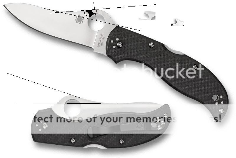

Hmmm... I personally wouldn't wave the rift without cutting into or even behind the stud hole. As for the Spyder, the tiny portion removed may not be enough to grab the pocket reliably or worse, the pocket could get trapped inside the hole. You need more of an opening, this means dropping the top of the blade.
STR knows more about the how's and why's of this.
If it did not function reliably I would just keep opening the circle until it did which should work fine. The only thing I would be worried about is leaving enough of the hole to still be able to deploy it, which for you is not an issue obviously lol.
