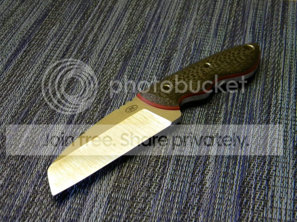

A while back a forum member ordered a knife from me. He really liked my Mini Wharncliffe model but wanted something a bit larger, so this is what I came up with. It's what I'm going to call a Standard Wharnie, and it comes in at just under 8.5" overall length. This one was flat ground from .156" thick Elmax powdered stainless stock and heat treated by Peters to 60 RC. Lightning strike carbon fiber with thick red G-10 liners.
Feedback is welcome, thanks for looking!

Beautiful! Looks very clean. A straight forward utilitarian blade in great steel. Looks like it will make a great user.
I think that blade shape is actually more modified sheepsfoot than wharncliffe, but that's not really relevant to your actual work. The knife itself looks awesome, and comfortable to hold. How long is the blade alone?
you are killing the Elmax! and top it off with the Lightning Strike CF... It was nice chatting with you today, you should have an Email!
I'm a sucker for Sheepsfoot or Wharncliffe blades. I must say I like the larger version a lot better! Is that real red G10 or the ruby red?
Great looking knife: clean lines, nice curves, texture, killer handle material choice. Love it.

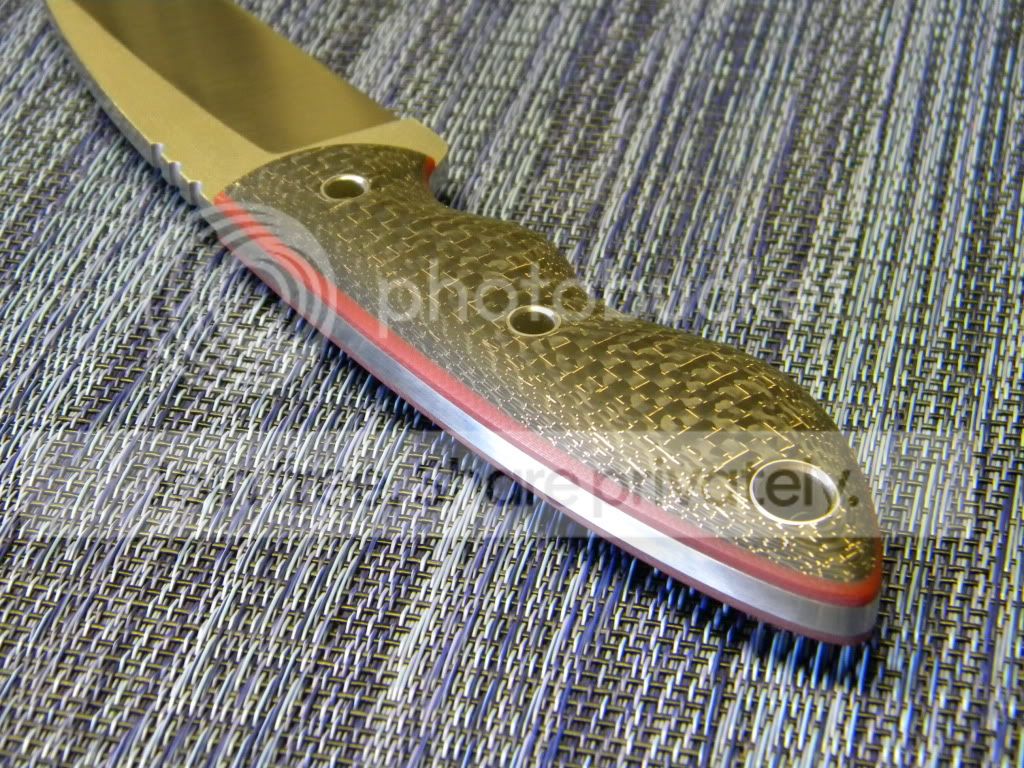

David, this is the ruby red G-10 that Chuck at AKS has. I like it when it's at least .090" thick because you can see the color. If it's thinner than that it tends to be washed out and not bright enough for my tastes.

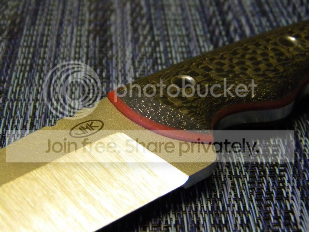

Looks sweet, Bud! I do like it better than the smaller one and they are both great. I have noticed and really like how you sweep the front on your slabs. clean looking transition in a very easy place to look less than elegant. I should cut back a little more than I have been.

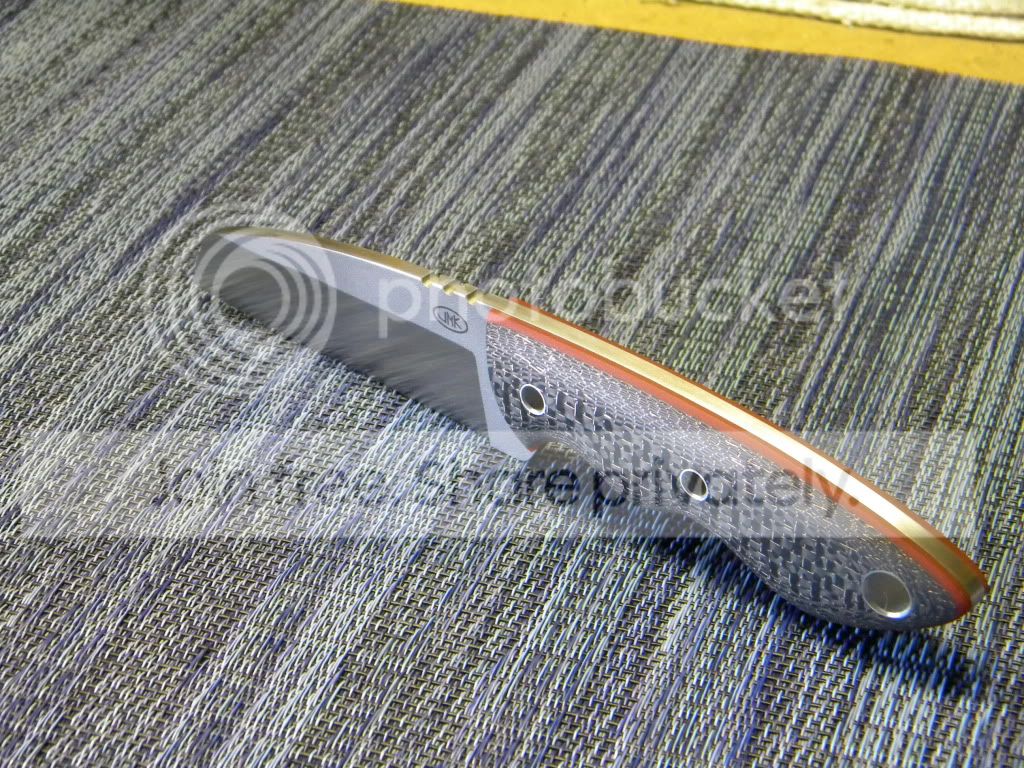

A shot of the grind symmetry from the front:

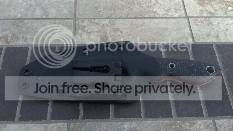

Sheath with small Tek-Lok:

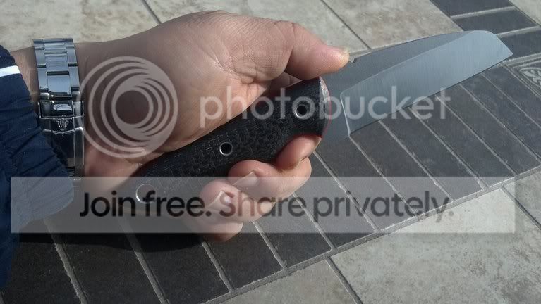

In-hand shot. I really love the handle to blade ratio in this knife. My (ahem) well-muscled mitts (ok, I have sausage fingers) tend to favor larger handles.
