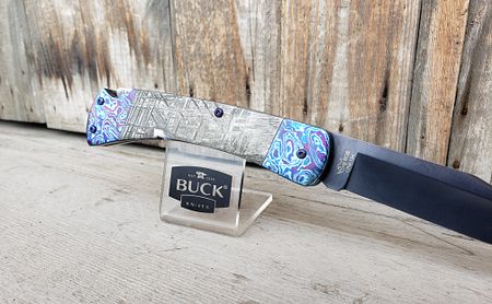

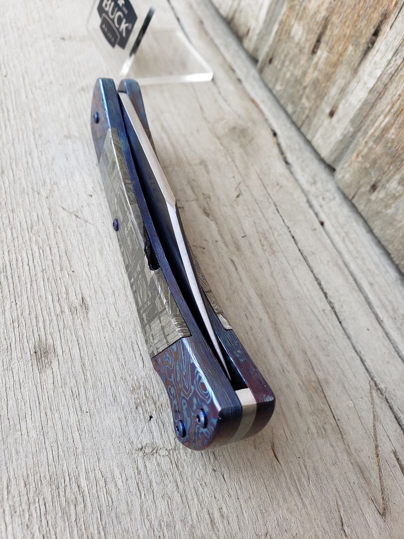

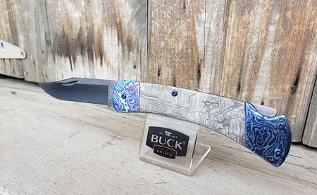

Here's a recent project I wanted to share with you guys.
It's a .205" thick each side Ameoba/Nebula Timascus frame I milled. The scales were hand fit/shaped into the slot and are of the Muonionalusta meteorite, which is as old as earth. Out of this world Damascus if you will.
The blade is a NOS TiAlN coated CPM 154 which it the same coating that was on the endmills I used to create the frame. All held together with titanium bolts.
