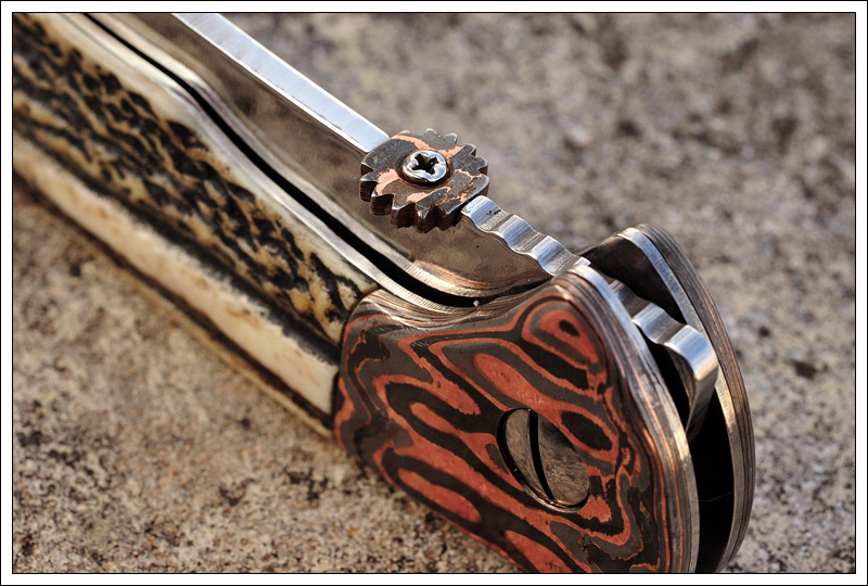

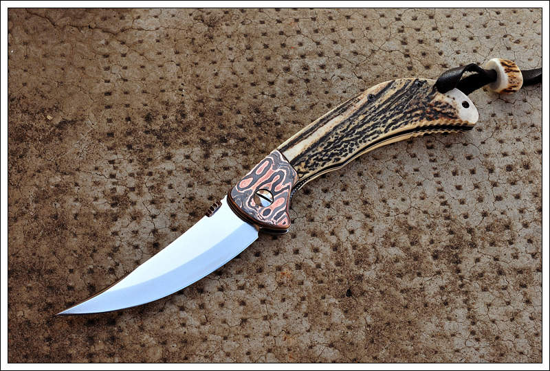

I just finished this for a customer that had the original one I've made many years ago stolen.
Base Knife: Emerson Knives Folding Persian.
Modifications:
- Swedge. Removal of black teflon coating and satinizing the blade.
- Deer stag handles (matching bead for the lanyard)

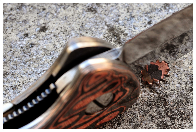

- Mokume (1010/1070/copper) dovetailed bolsters, backspacer and opening disk.

Nice custom work Ariel,how in the world do you get 1010 and copper to stick together,you amaze me with your combinations--Best Regards Butch

Thanks guys! :thumbup:
How durable is Mokume compared to Damascus and other bolster/scale materials?
I missed this question yesterday. Mokume is VERY durable, I've never had any kind of problem with it. Only thing to take into consideration is that if you use carbon steels on it like on this one my customer requested, it might eventually rust if not taken care of.
I do laquer it to help with that, and it seems to do the trick as I've been wearing a belt buckle I've made with this exact same mokume for two years now and it never got traces of rust :cool:
