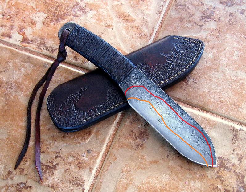

The 8th picture, hemp string-wrapped handle, leather lanyard, appears to be a cold bluing and bleach finish. You can do that DIY as well as the acid etches. The mixture of the bluing and bleach pits the blade and leaves the bluing in the pits after you clean it up. Just search for gun blue and bleach.
I experimented with bluing and bleach on one of my moras. its pretty neat but I would def do it outside it puts off some vapors you dont want to be breathing
There is also mustard, lemon or tomato juice, vinegar, and electro-etching that can all be done DIY.
Looks easy enough, I'll probably do this. Thanks.
After searching up on it, it seems that all you do is apply blue to the blade and dip it in bleach. But to get the transitioning effect like in that picture, I imagine I would first apply blue paste up to red line, dip the entire blade in bleach, then do a second round with blue paste up to the orange line. Does that sound right?

I'm pretty sure the upper portion of that blade has a darker color because of the left forge marks with some scale in the pits perhaps, but your idea of sorta layering, or feathering the bleach/blue effect sounds like it might work. That blade, and the other similar blades in 2 other pictures in your gallery are made by Rick Marchand from www.WilderTools.net, so you might ask him cause he is here on bladeforums. Also, different steels will react differently, as in become more pitted and textured) than others. I'm pretty sure O-1 and 1095 are the optimal steels to get that effect with, not sure what the kabar kukri is made from.
