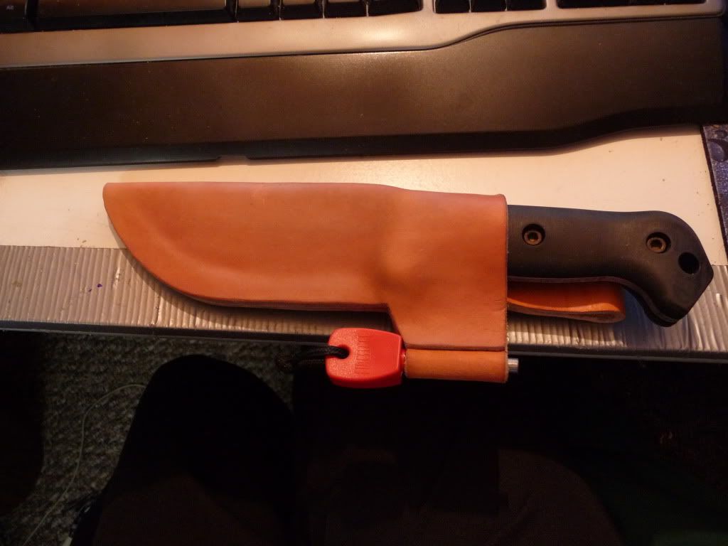

This is my first ever attempt and I've only invested a couple of hours into it so far. Considering that I nearly messed it up due to a lack of planning or real measuring, I was rather amazed at what I produced. I opted for a very simple fold over design with a loop for firesteel. And yes - I was heavily inspired by mooosez45's vertical carry sheath - he's rather talented and does some downright amazing work. I still have to refit it for some custom scales, do the stitching and dye it, but I so far so good by my standards:

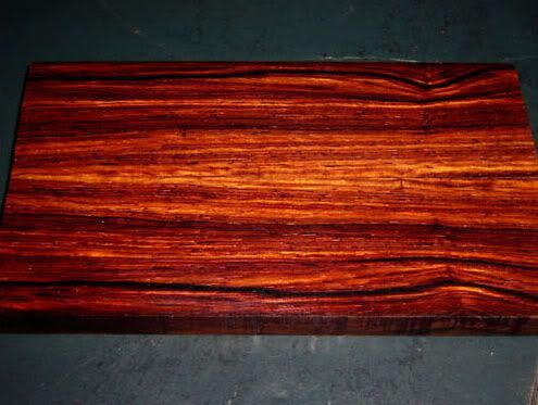

Secondly, I also ordered some cocobolo scales to make my Beckers a bit more snazzy. These ones for my BK-11:
And these ones for my BK-2:

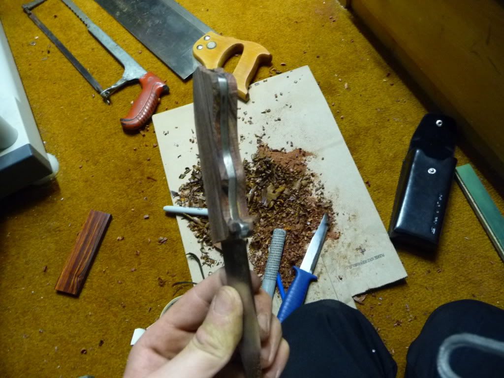

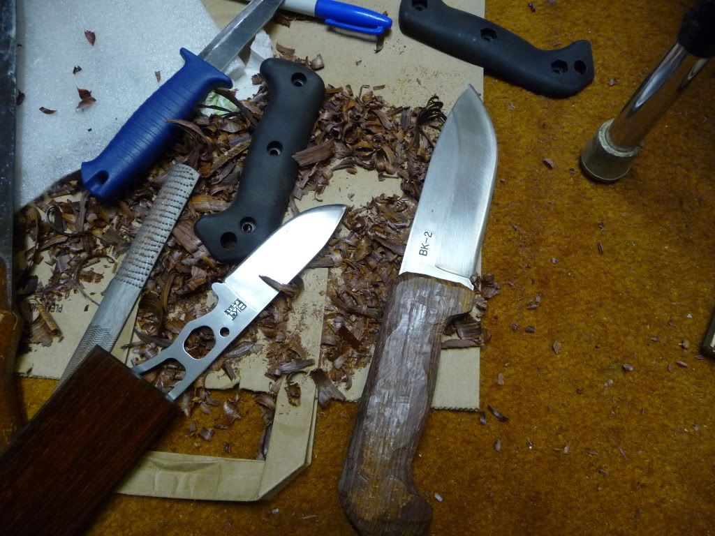

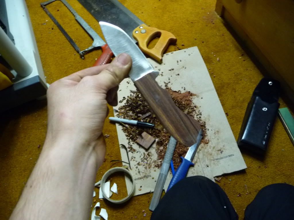

This part of the project is proving to be a bit more difficult though due to my lack of any stationary power tools (I only have a dremel and drill). A scroll saw, planer, belt sander and a grinder would probably make this a hell of a lot easier, but my method is actually proving to be pretty enjoyable (albeit rather time consuming). I've spent about an hour so far and have only done the basic shaping of a single scale for my BK-2... all the work was done with the BK-11 and mora with some help from the rasp/file combo (all pictured). Ignore the saw - I gave up on that about a minute in :rolleyes:. My plan is to do all the initial shaping and thickness reduction using my BK-11/mora/rasp. I'll then fit the scales, drill the holes for the screws, then finish the shaping with a sanding drum attachment for my dremel. I'll then do the final finishing using good ol sandpaper. A lot of work ahead :p

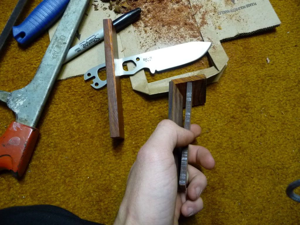

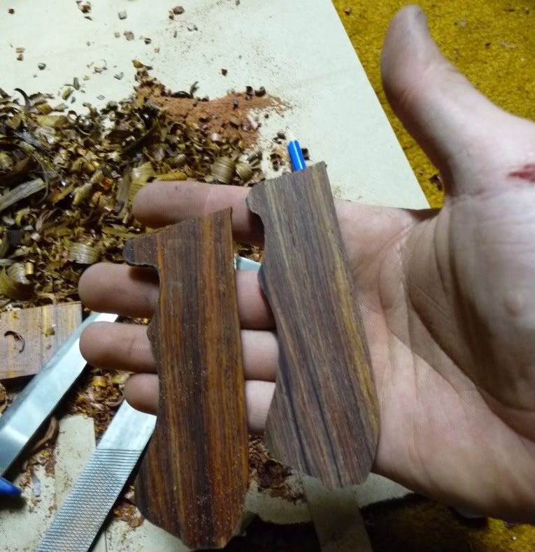

First off I decided that I had to saw a single slab of the set in half... using two 1/2" thick slabs on either side would have produced waaaay too thick a handle. Anyways, having only a hacksaw available, it proved to be quite difficult... Had to keep it rather straight and be very gentle as to not snap the wood in half. Took about 45 minutes but I finally managed it:
Then came the shaping. The BK-11 was used exclusively for this:

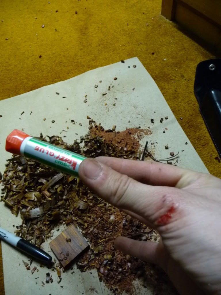

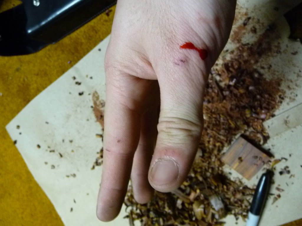

And while shaping the second scale, my BK-11 got a tad upset with me and decided to bite. Just a nick, but the convex edge sort of split the wound instead of slicing it, so it was a bit difficult to get it to stop bleeding.
Nothing a bit of superglue couldn't fix though. Always have some on hand.

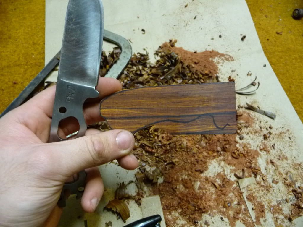

Back to work! Basic shaping on both scales complete. Again, nothing else aside from the BK-11 has been used yet!
Decided that making the scale follow the choil all the way wasn't working out, so I carved them to the new design on the right:
Fitted the scales on the BK-11 with some double sided tape. Sadly the BK-11 can't claim all the glory for making it's own scales - further shaping of the scales was done with a Mora and a file. Now I have the initial shaping out of the way - Just need to figure out how I'll be attaching them on before I finish the handle off and get to work on a sheath.

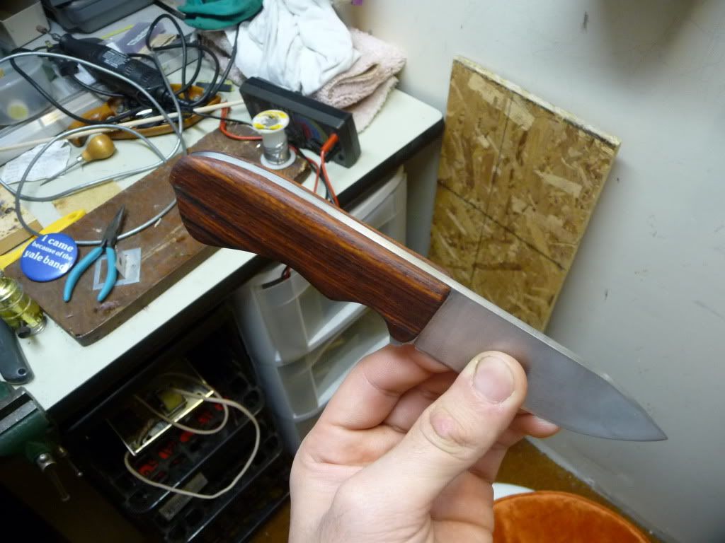

Did a bit of contouring/rounding on the BK-11 scales using my mora, a file and some sandpaper. I then gave it a quick wipe with mineral oil to give some idea of how the color/grain will look once I finish it. Looks pretty snazzy if I do say so myself.... All that's really left to do is figure out how I'll be attaching it on. The old pins vs. screws debate ;)

That looks great! Turns it into a whole new blade.
Thanks mate - I felt somewhat hesitant about covering up the stampings, but to keep the thing ergonomic and usable, it was sort of a necessity. It really does feel and look like a completely different blade now.

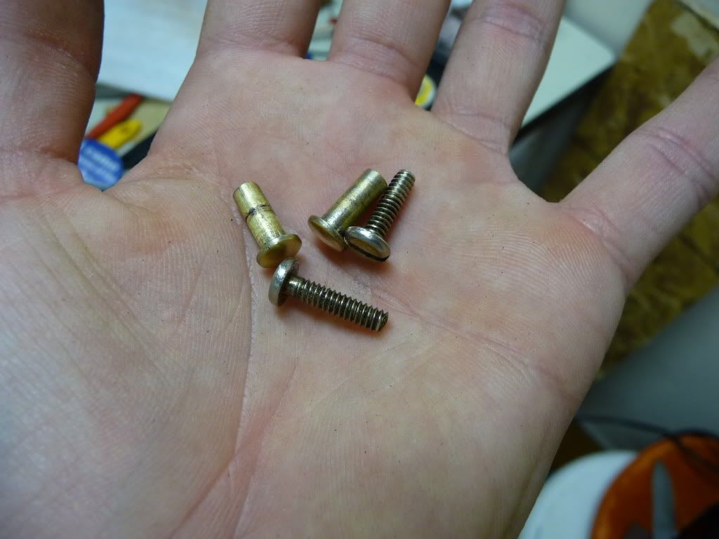

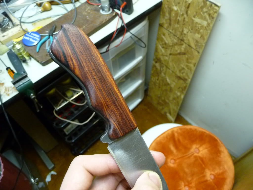

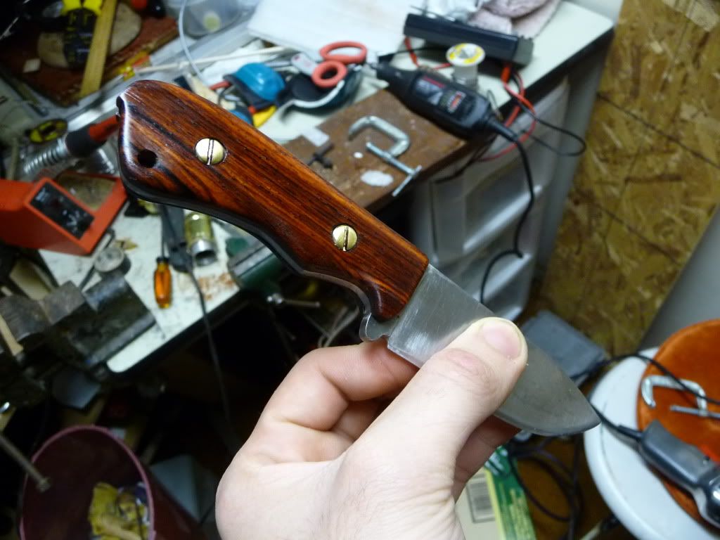

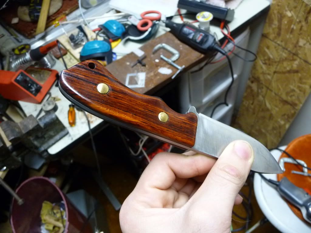

So I ended up looking around the workshop and found these nice little brass screws:

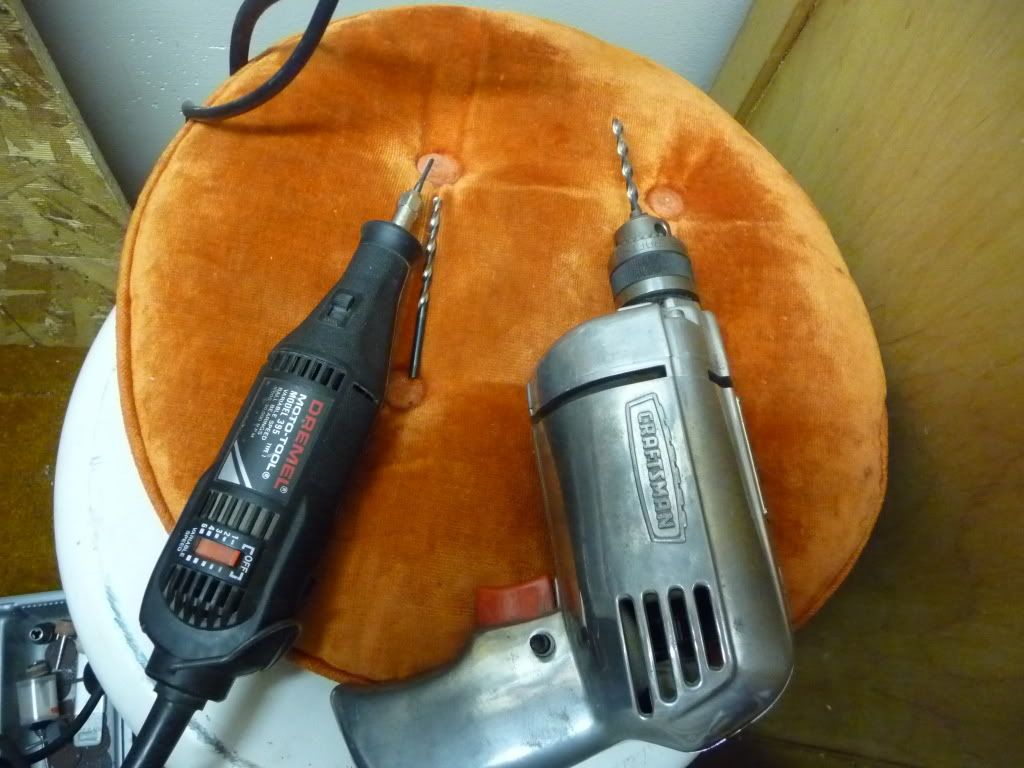

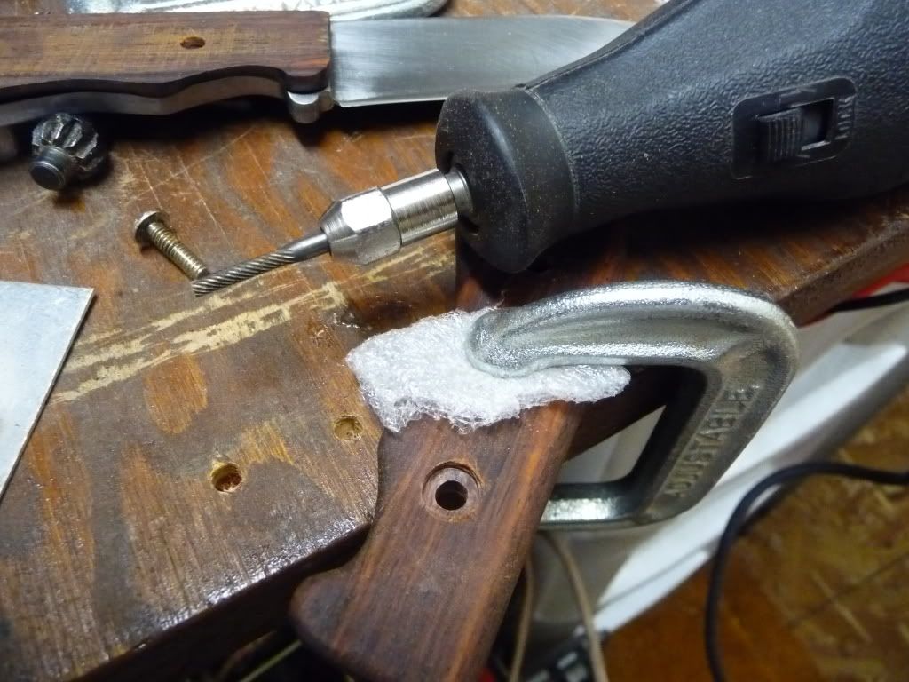

They were a little long, but a cutting wheel attachment for my dremel took care of that. Drilling the holes for them was a bit of a pain... only had an old drill and my dremel to work with. The holes actually weren't that difficult as cocobolo seems to be almost plasticy due to all the oil in it. The depression for the screwhead was the real difficulty - had to use the dremel attachment shown below so steady hands was critical:
Anyways, here's the final product with the first coat of Tru-oil on it:

yay for super glue. wound control was why they originally made it, right?
the medical grade stuff is much more entertaining (rubbery), but well, $$ as well..
and super job. i love hand tools. a machine shop would be nice too, but i use what i have as well.
Bladite
sweet!
Bladite
Dermabond is what they patched me back together with after a couple of gut surgeries. I had always heard that Vietnam Era quick fixes were where the Super Glue origins came from. I also know that SuperGlue does not allow air or moisture to pass through, where Dermabond does. Not sure, but it kept my innards from becoming outtards, so, rock on. Moose
