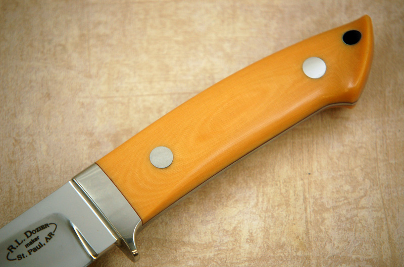

Well more research lead me to this dozer knife using aged white micarta. And after looking at it I just love the color. Also the weave pattern looks identical.
Looks like black line gold micarta, likely westinghouse material. I'd say it's a much better score than it being G10. It will however, turn the same color as the outside over time.

That color is beautiful, one of my favorites for all types of fixed blades. I am curious how long it takes to turn red again and why it happens.

It changes color over time because of the types of resins they used to make this material back in the day. Lots of speculation as to what causes it but nobody has been able to stop it that I'm aware of. I consider it a feature.
The old stuff is typically much better quality than what's available today, denser, more uniform, less prone to chipping, etc.
