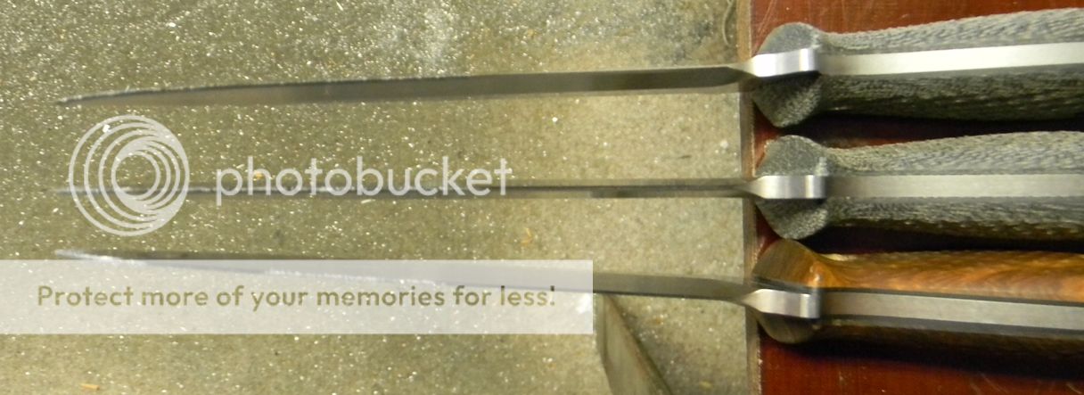

The test blades:
1.jpg~original
I have two test blades that are 3V that are geometrically identical. They're even the exact same Rockwell hardness (60). One was processed with an industry standard heat treat, the other was processed with a few tweaks. I don't know which is which, it's a blind test, they're stamped on the tang under the scales. As I'm posting this I know the outcome of this test, but as I'm writing this I have no idea what is going to happen.
Just for giggles I'm also throwing in an ELMAX blade of a similar design and a D2 blade. The D2 is unfortunately a very different design but I'm including it because it is a known standard, however all four blades are HRC 60 and are sharpened to the same 13 degree per side edge angle, microbeveled and stropped and for all intents and purposes are starting out the same.
The skinning knife is normally sharpened at 13 per side. The larger knives are not. However I'm interested to see the effect of the tweaks on fine edge stability and 13 per side is fine enough for significant differences to appear and some folks who are more concerned with cutting performance than durability may push it that fine.

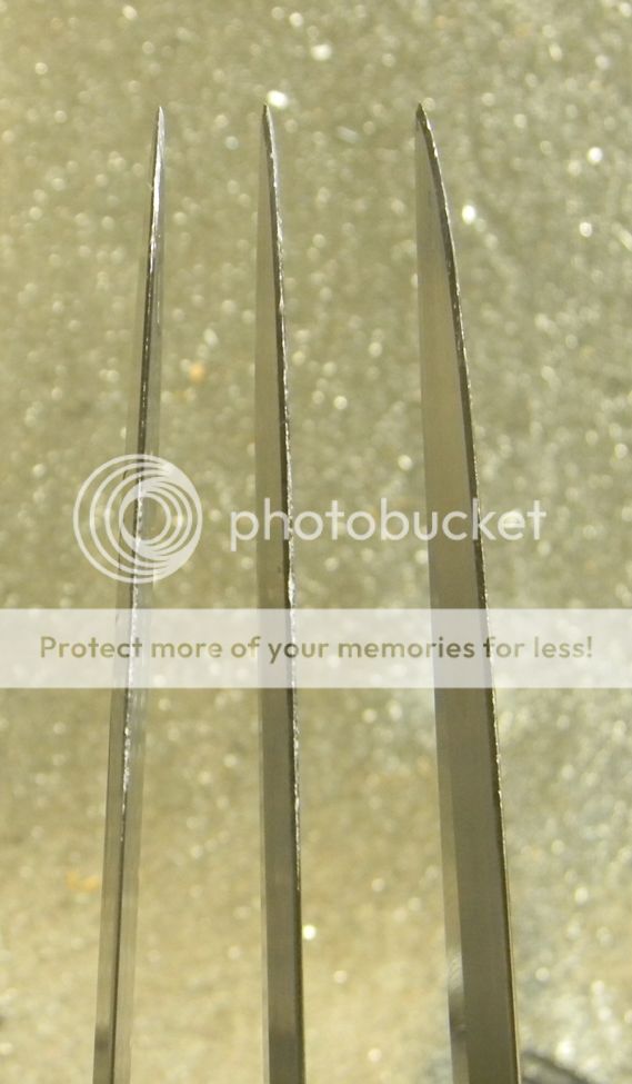

The first thing is to cut cardboard. They all cut an identical amount of the same cardboard. They're mixed up during the test so they all get a broad sampling of the material so no single blade is overly subjected to any particularly abrasive bit. This takes a little while and now my arm hurts. The cuts don't use the entire blade but are limited to about 2" in the belly of the blade. The outcome is evaluated by looking at the cutting edge under bright light and 10X magnification.
All of the blades are significantly dulled, only the D2 will still shave hair. All will still scrap a few hairs here and there.
2.jpg~original
It is worth noting that shining a light on an edge and taking a closeup picture of it makes every little imperfection look like a parking lot. These are all still relatively sharp at this point.
Best: D2, HRC 60, 13 deg per side, there are a couple shiny spots where primary carbides may have pulled out but over all it is still reasonably sharp. It is worth noting that this is not remotely an industry standard heat treat for D2 anymore and at this point I would have been surprised had it not come out on top here because this part is what it does well.
#2: ELMAX, HRC 60, 13 deg per side, won't shave hair but still cuts well.
#3 & #4, HRC 60, 13 deg per side, both 3V samples are about the same, not far off of the Elmax and the difference between the two is too close to call. Given the much lower carbon and carbide content compared to the Elmax there is surprisingly little difference.

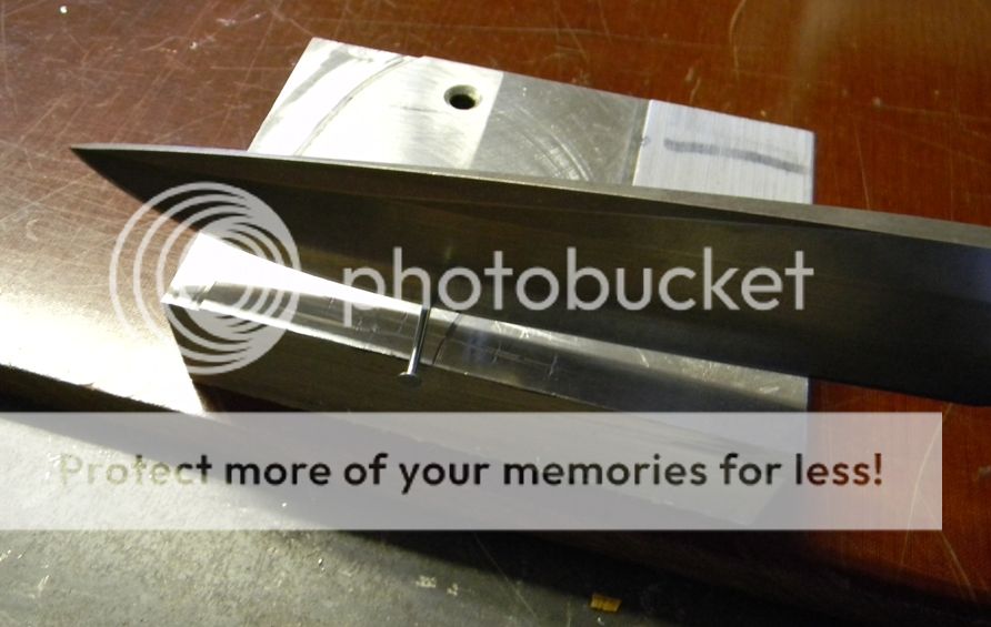

Test two, cutting leather:
Leather can actually be quite nasty to cut. I believe it might be due to naturally occurring silicates in the hide that are very abrasive. The key thing to consider when cutting leather is that each piece of leather is different and even a single piece can be different from one spot to another. So the only meaningful data you can derive from cutting leather is comparative between samples and then only if you mix things up so that variations in the material are evenly dispersed. All of the blades are somewhat dull now. The D2 came out on top again.
3.jpg~original
Best, D2 - this is D2's time to shine. After this I expect it won't do so well.
#2, Elmax - not far off from the D2
#3 3V, test sample A. Not far off from the ELMAX. UPDATE: test sample A turned out to be the new heat treat, I think this is a positive development.
#4, 3V test sample B. Not far off from test sample A. The two test specimens are very similar at this point but test sample B appears to be slightly more dull and has larger and more shiny spots.

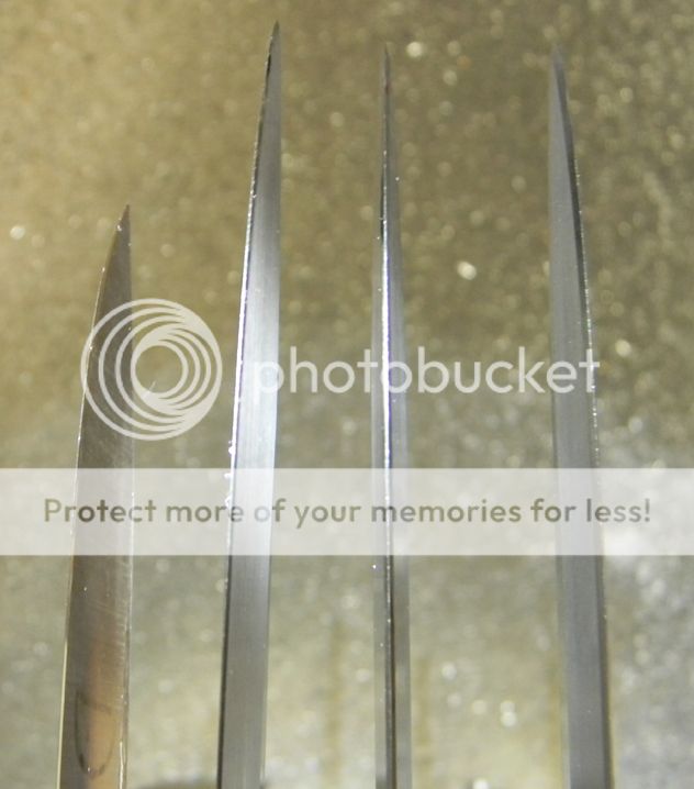

This test is hardwood whittling. This is not as objective scientific as the other two tests because there is more of a human element to the technique but it is very valuable because it helps illustrate edge retention in real world use. The other two tests in soft abrasive media probably correlate well with things like automated CATRA testing, which can be a poor predictor of actual real world edge retention. This test, which involves biting into and twisting out of a piece of hardwood, gives us an idea of the edge stability. Because these samples are all sharpened to 13 per side (fairly acute) it can be said that we are looking at fine edge stability. There are a number of things that affect edge stability, many of which we can try to address in our heat treat. What it all boils down to is a clean fine grained homogenous steel at relatively high hardness has the best potential for edge stability. As you reduce the hardness (or use the secondary hardening hump which reduces the hardness of the matrix, even as the overall measured hardness goes up) you reduce the strength of the matrix, though too hard and it will tend to chip. Carbides, which improve wear resistance and can actually improve the strength of the matrix like aggregate in concrete can (and generally do) reduce edge stability. This is particularly true of larger secondary carbides that tend to form in the grain boundaries, a big problem in D2 and one reason we often want to avoid the secondary hardening hump with cutlery. Alloying such as large amounts of free chromium that contribute to corrosion resistance doesn't contribute much to the strength of the matrix reduces edge stability when found in the amounts required to make a steel "stainless". And retained austenite reduces edge stability. This last one, RA, is a bigger problem in cutlery than most people realize and is frequently the biggest weakness in industry standard HTs when applied to cutlery. The standard protocols are largely concerned with hitting a particular HRC with minimal distortion, dimensional changes and risk of cracking with little regard for fine edge stability because fine edge stability just isn't a major concern for most of the applications these steels were developed for. In practice, RA results in small areas of austenite (a soft weak structure) that doesn't convert and remains soft. These areas increase ductility of the matrix improving impact resistance in thick sections and reducing dimensional growth associated with martensite conversion. But, in a knife edge they also act like the perforations in a postage stamp, allowing a fine edge to fold over or simply flake away under stress. Modern metallography has shown us that the amounts of stabilized retained austenite found in many complex steels can be significantly greater than was once believed. So, the purpose of this test, and therefor the reason for this thread, was to see if techniques used to reduce RA in other similar complex steels had an effect in 3V.
Sorry about the length of that just now. Wow...
The hardwood I'm using for this test is some very old, very hard, Osage orange. With the cutting edges at 13 deg per side, this is actually a brutal test. I wish you could be here to see and hear this, it makes me cringe. Normally when I do this there is a fairly large spread from best blade to worst, with the worst failing in dramatic fashion with edge damage visible at an arm's length. So this particular test is notable because there isn't a huge difference between test samples. All of these samples have pretty good fine edge stability.
The results:
4.jpg~original
The best is 3V, test sample A. EDIT: this is the new HT. Despite the abuse it withstood it is almost none the worse for wear. The edge stability of this sample is very good. In my experience, even a very clean homogenous simple steel such as W2 doesn't beat this by much.
Second best is the Elmax. This is a surprise to me because it is a very high carbon, high carbide stainless steel and I did not expect it to have good edge stability. I expected a high carbide stainless at HRC 60 and 13 degrees to chip out, but it held up. This may be due to the fine carbide size and even carbide dispersion of the 3rd generation PM steel offsetting what I think would normally be a crippling amount of carbide.
#3 is 3V, test sample B
#4 is the D2. This is actually pretty good for D2. Fine edge stability is not its strength. I'm surprised it was beat by a stainless, but honestly the spread between the specimens was pretty close this time.

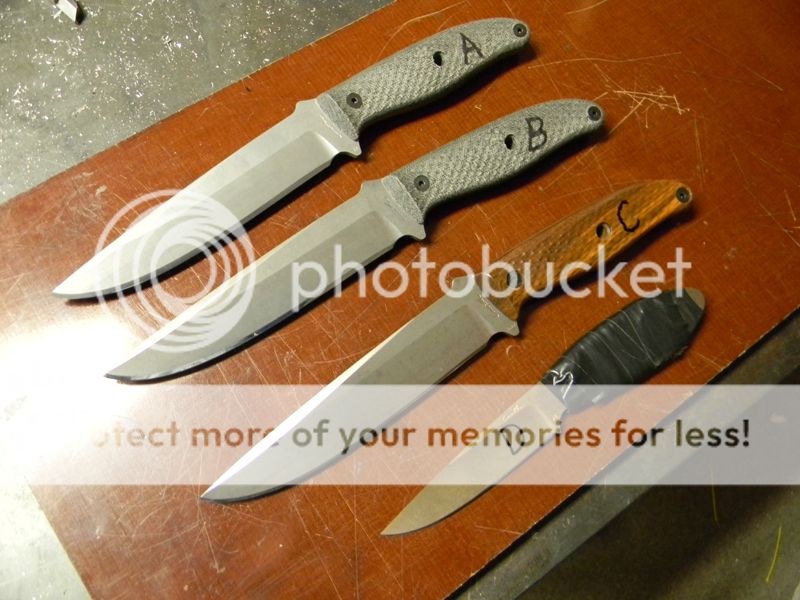

The next test is a cheap parlor trick that any knife can do well at with thick edge geometry: cutting nails
5.jpg~original
This is a cheap parlor trick because in of itself it tells you nothing about the overall quality of the knife, it says more about the edge geometry than anything else. A relatively soft cold chisel can cut a nail, but that doesn't mean it can hold an edge or cut well. So the ability to cut through a nail is not the hallmark of a good knife (for example it would pretty much universally indicate a pretty bad sushi knife), it is simply the hallmark of a tough edge. But in this case, with the edge angle a very thin 13 degrees per side none of these edges are particularly durable at all. It is, however, a perfectly valid test in this case because all the knives are sharpened to the same angle, and the little 2 penny nail is not so big that primary bevel geometry is going to come into play. So in this case the differences in the blades will be very telling.

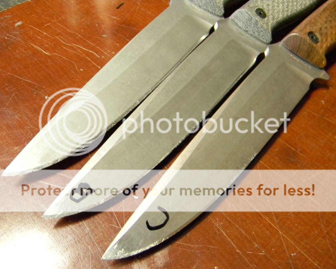

The damage:
6.jpg~original
Best: 3V, test sample A (modified heat treat)
#2, Elmax. This is surprisingly good for a stainless sharpened this thin.
#3, 3V test sample B (industry standard HT)
#4 D2. Come on, it's a hard thin D2 skinner and it was run through a nail. Twice. I can't believe it didn't break. Try this with your pretty little Sebenza some time...
I cut two nails with each blade.
