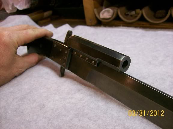

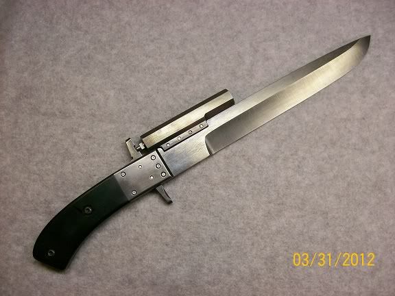

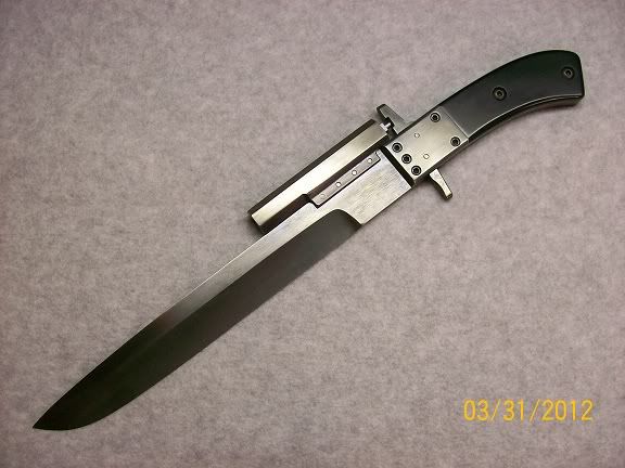

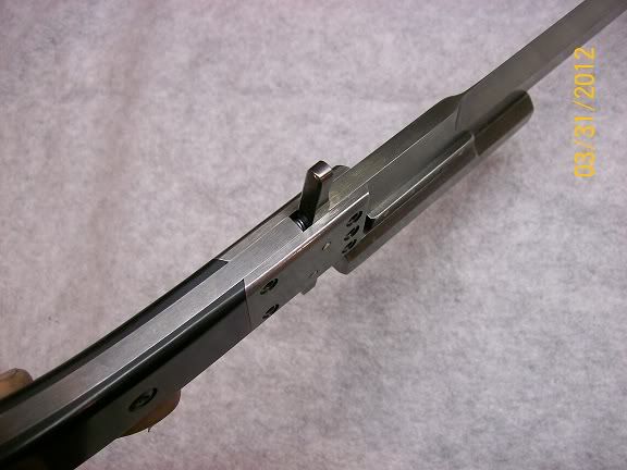

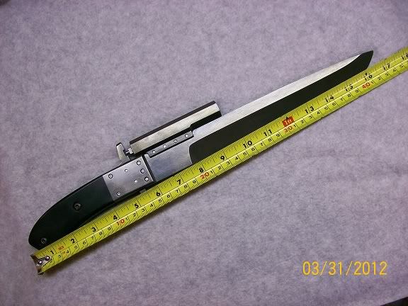

Inspired by examples from the legendary Bruce Bump, I made this in about 22hrs. 16 3/4" overall, 10 3/4" blade, 9" cutting edge. Blade is W1 tool steel, tempered to about 58Rc., handle is Black paper micarta. Barrel is a .36 calibre black powder, smooth bore, just under 4" long, bore is 3 3/8" deep. Hammer has a safety halfcock. Trigger and hammer also serves as hilt as you can see. Handle is DoveTailed into bolsters. Quite a cool piece even if I do say so myself! This is my first one of what may be many more as it was a fun project to make! $500 shipped USPS with tracking and insurance. Thanks for looking!

Just curious, could this be done like a black powder revolver? where the cylinder was actually built into part of the blade?
