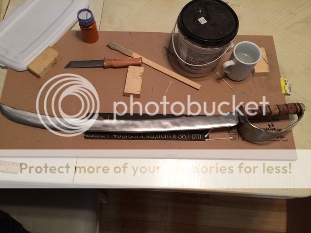

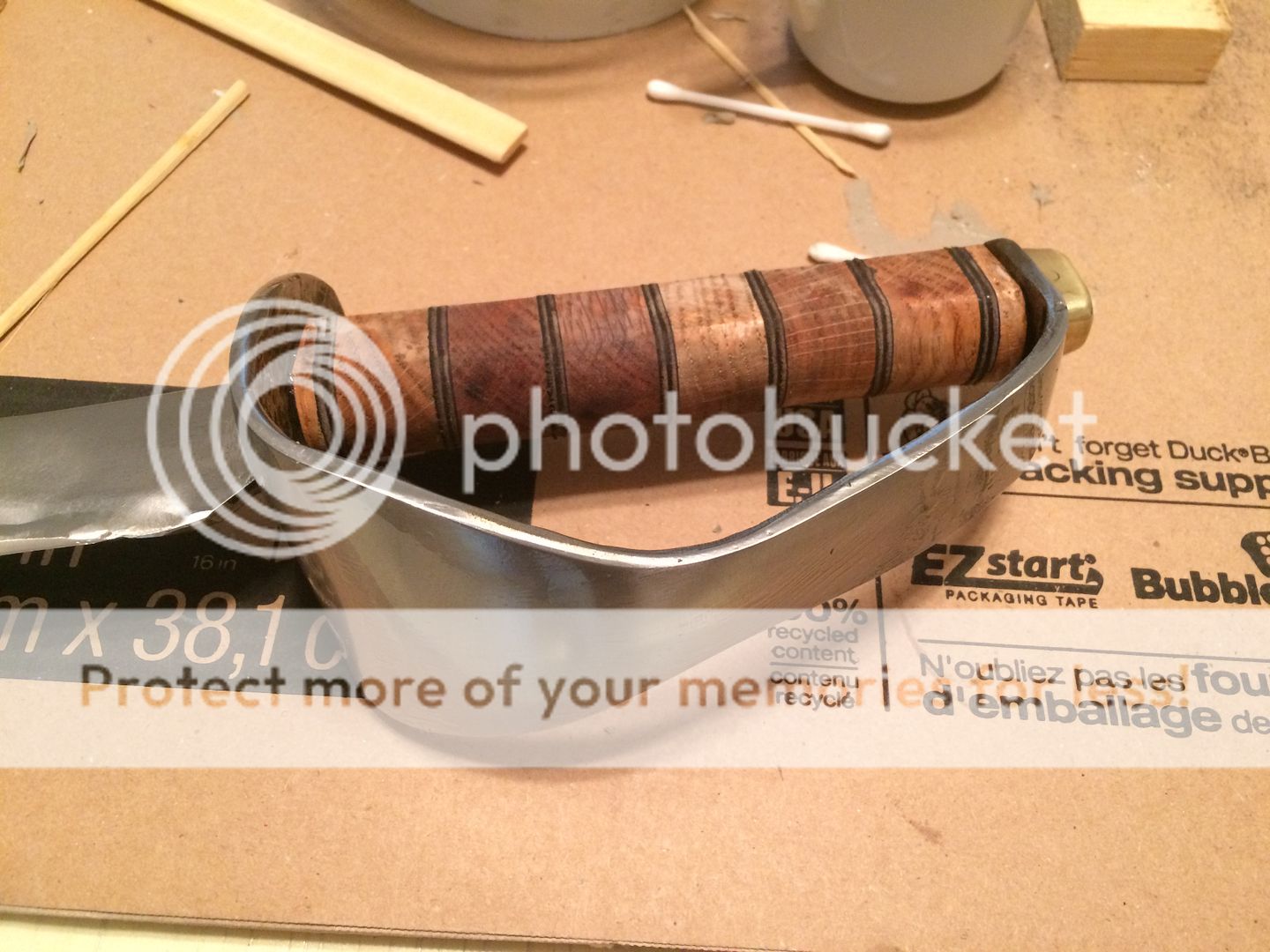

Here's the one I just made that (I believe) was the inspiration for this WIP thread. It has flaws that Stacy and I discussed in my original build thread, but it is one of my first sword attempts.
