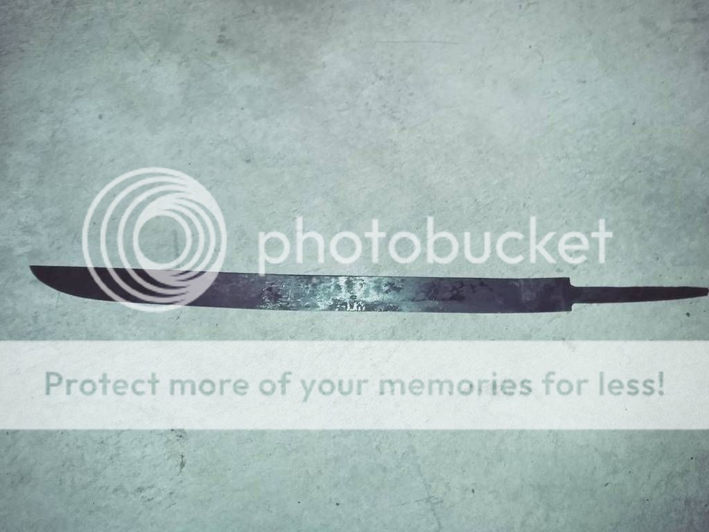

I'm getting close on my cutlass. The blade is heat treated which I have pictured below. I have since done the finish grind, and just have to do some hand finishing.

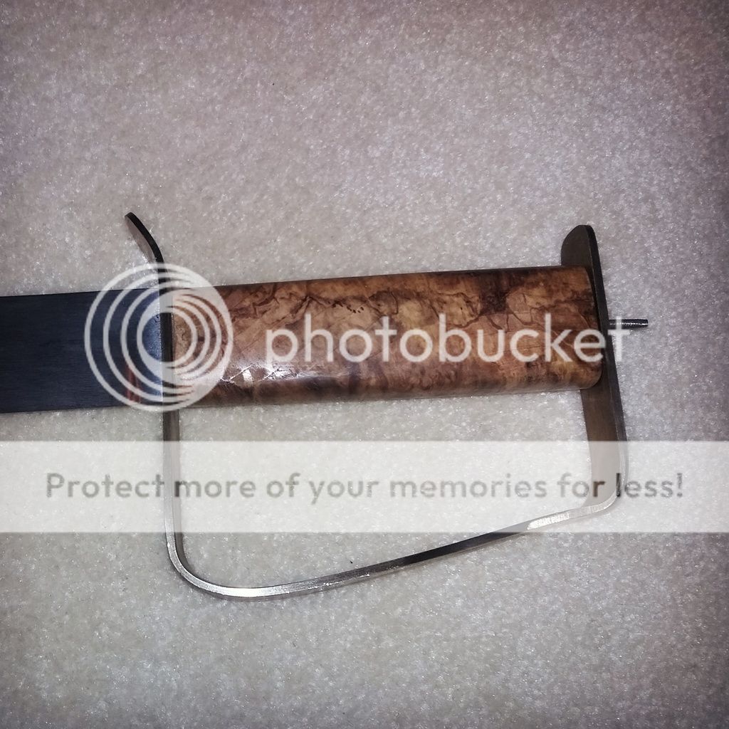

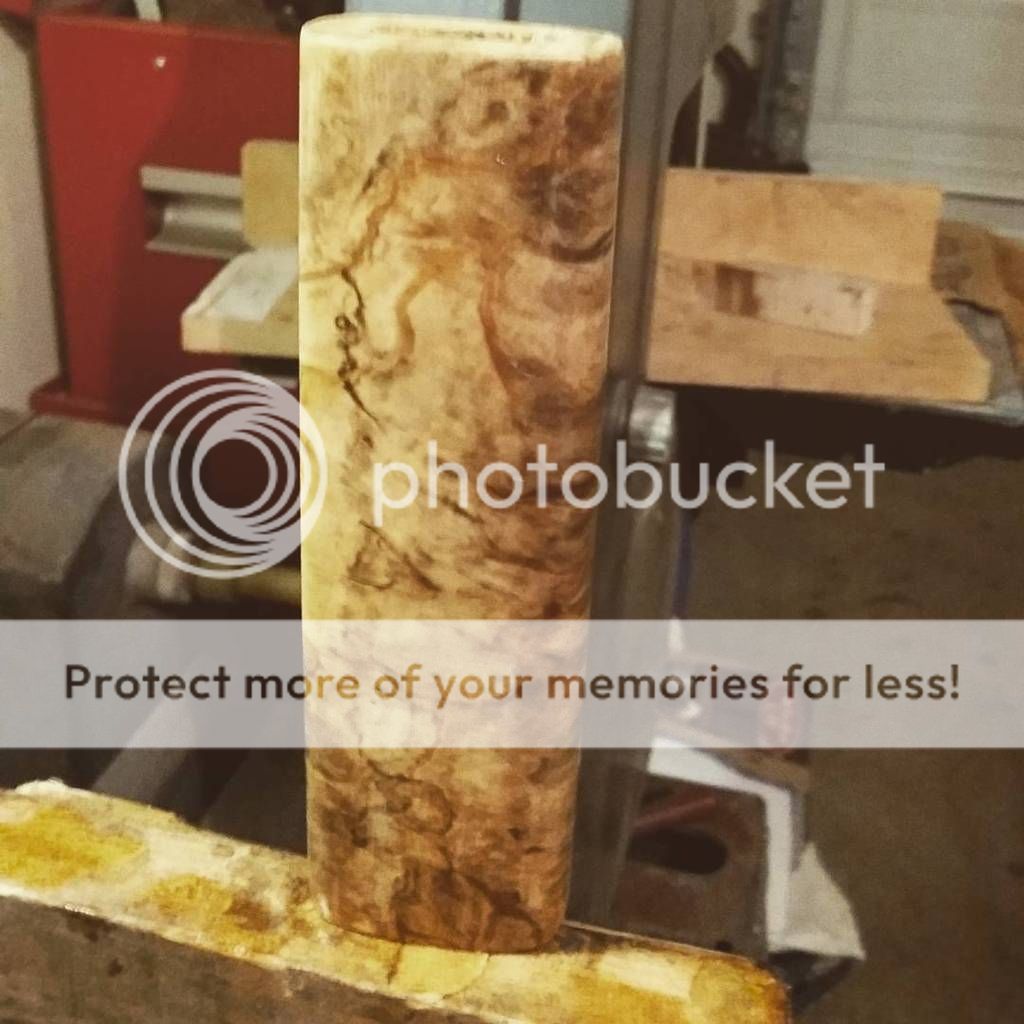

This is the handle. It's a nicely figured piece of horse chestnut. I also have the D guard shaped. I just have to put a brass plated finish on it.

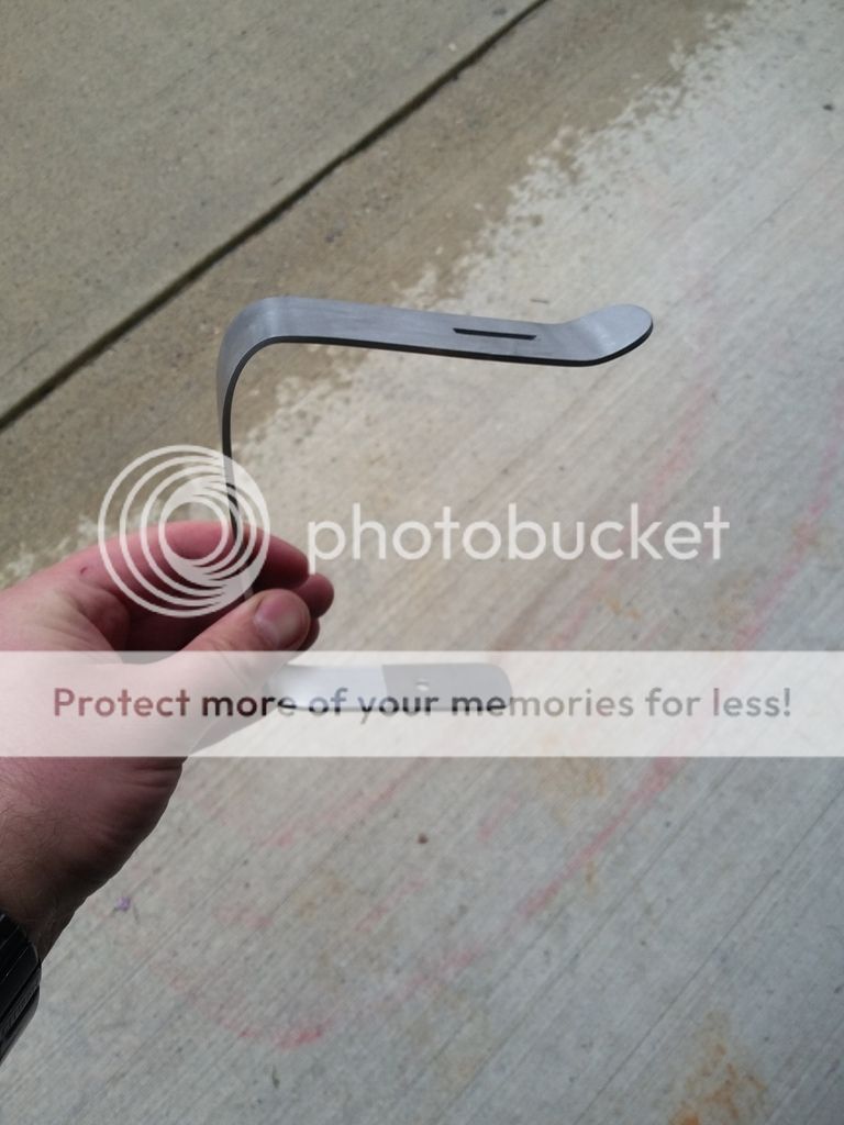

Here's the D guard all shaped and drilled. The tang is threaded and will hold everything securely in place.
Here's the sword all mocked up before it gets epoxied and secured.
A closer view of the handle during mock up.

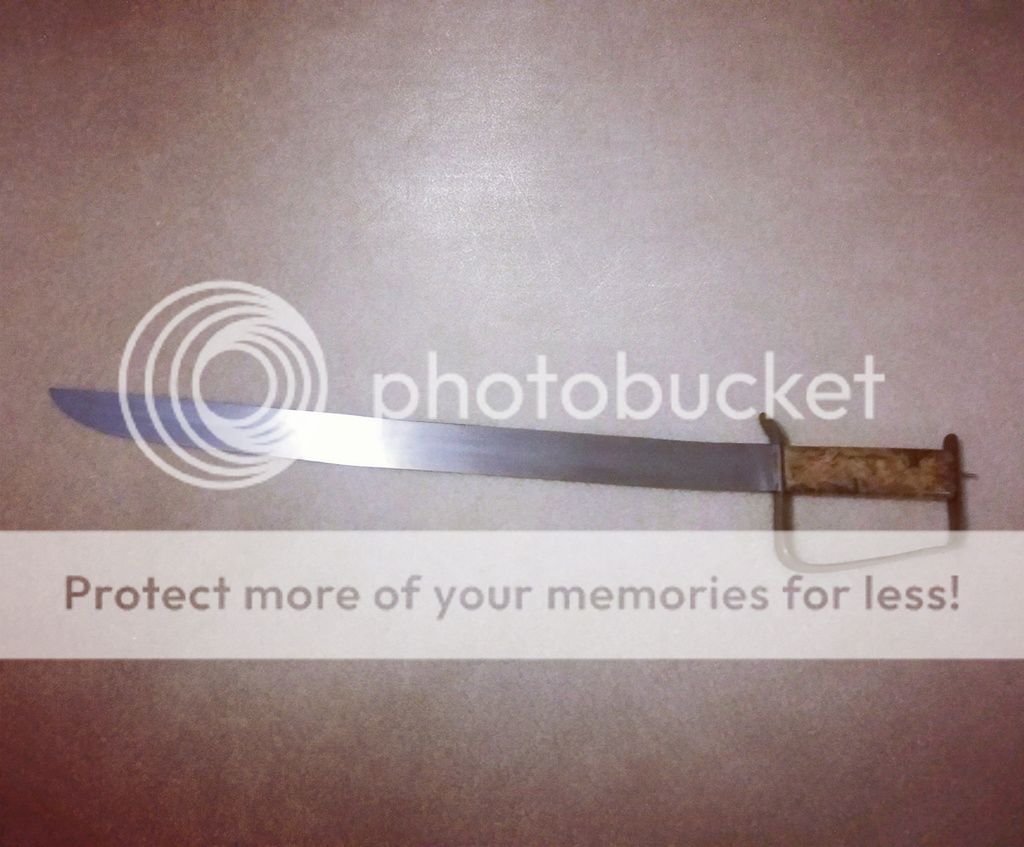

Ok here are my final pics. I had a "design change" at the pommel, so I decided to add a domed pin through the handle as well. The guard was heat colored and brass coated using a brass brush. It has an interesting patina to it.
I also made a leather scabbard, that I hardened with hot water and beeswax. I fits very securely in the scabbard.
