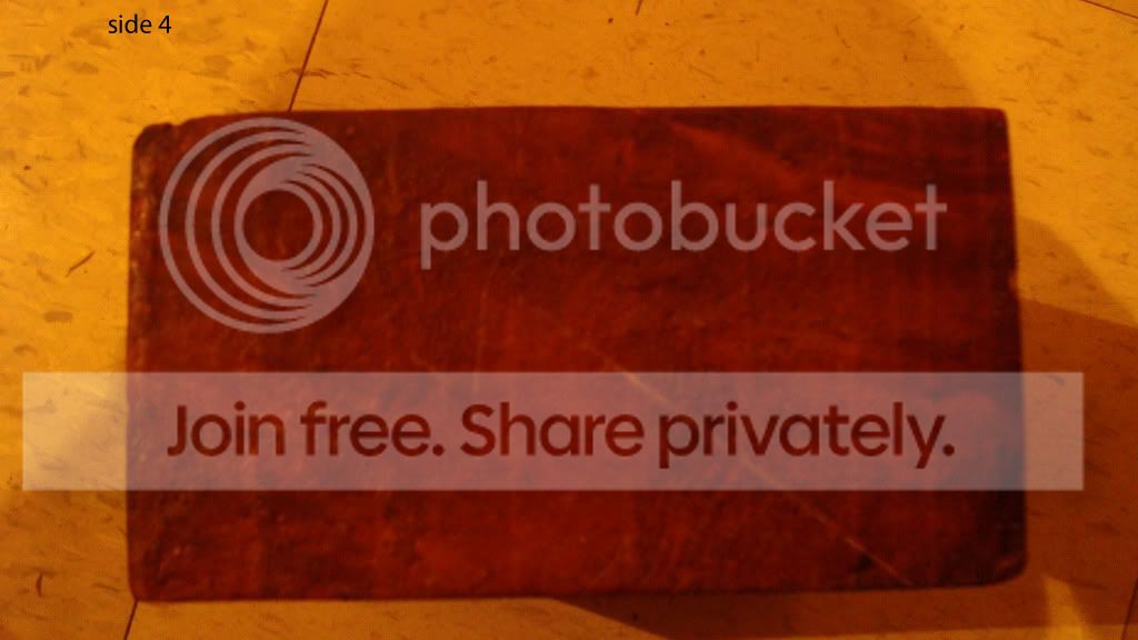

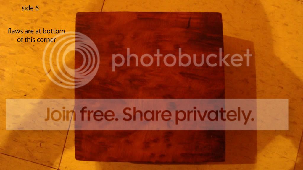

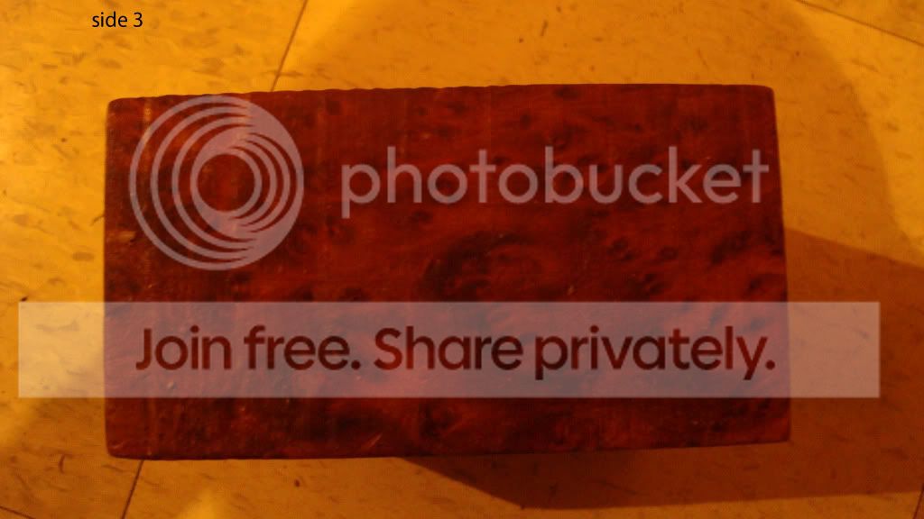

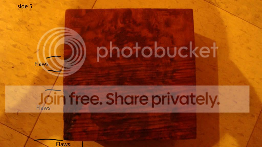

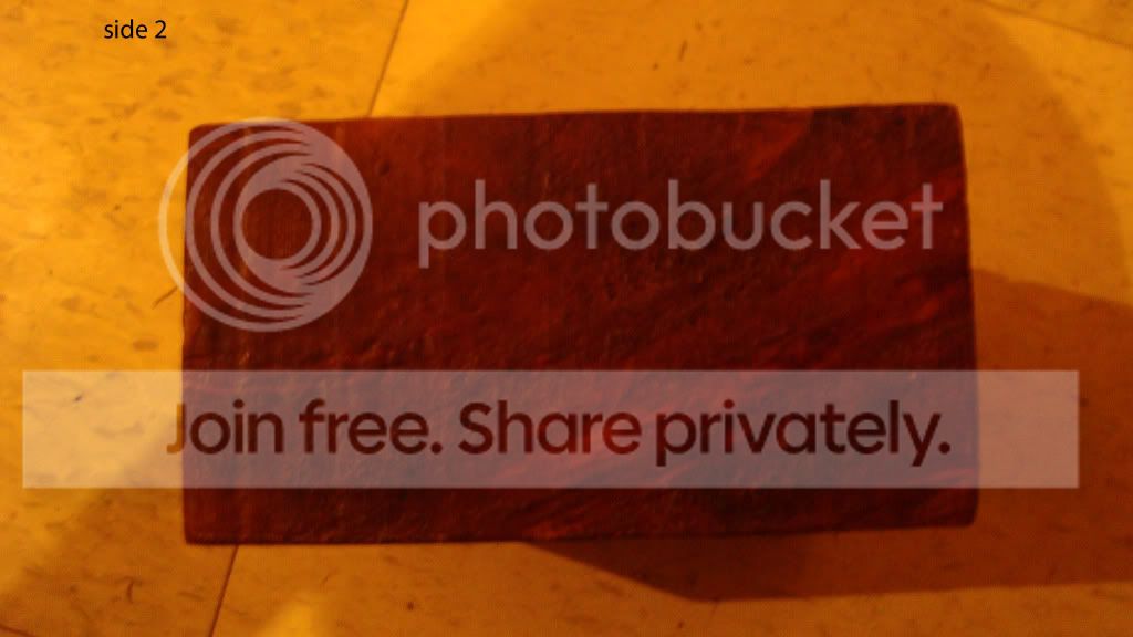

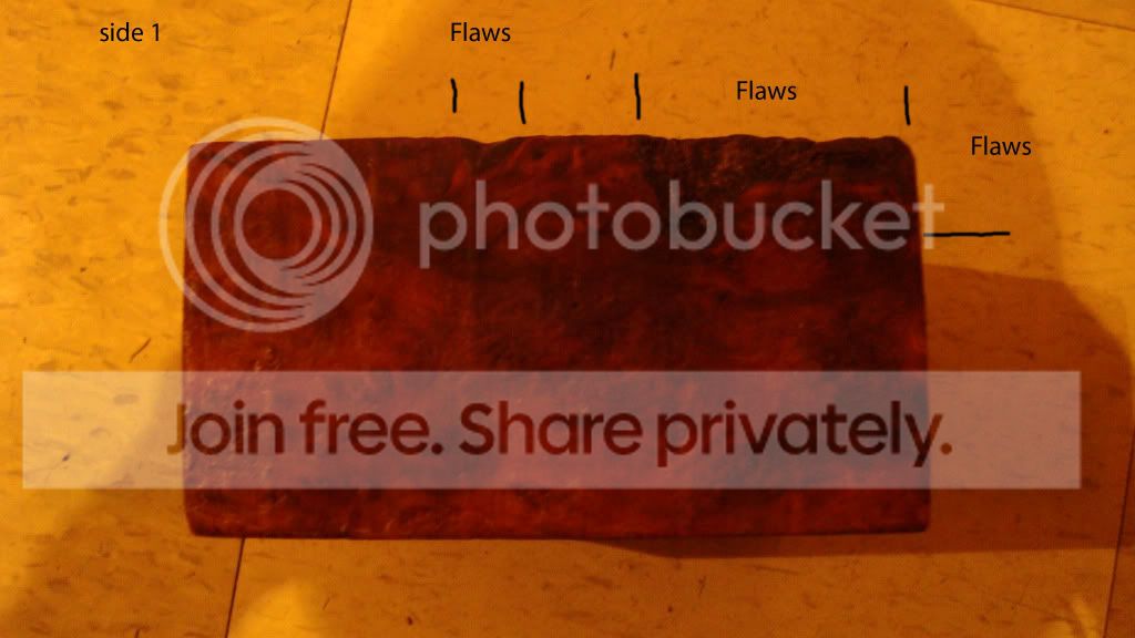

Ok I jumped on this before heading to bed here are the pics

My thoughts were to start at side 3 slicing off .5" slabs till I got about 1.5" from the other end with the flaws in it and then cut up to the flaws from side 6 till I got to the flaws. I could then cuth the 3"x6"x.5" pieces in half making 2 1.5"x6"x.5" scales.
This would all depend on what was inside the block, but I am open to suggestions on how to handle this, but I really want a slice off of side 3 I really like the look of tht pattern
Good choice keeping side three and slabbing from there.
I would personally cut off ~1" thick slabs because that's what I use on fixed blades (and it will make 4 folder scales). Leave the slabs whole. You can cut the handles out for each specific knife and minimize waste (nest the handles and use a bandsaw or coping saw). You would waste material if you used a 3"x6" block on a small fixed blade. You will also be able to position the handles on the slab to maximize appearance.
