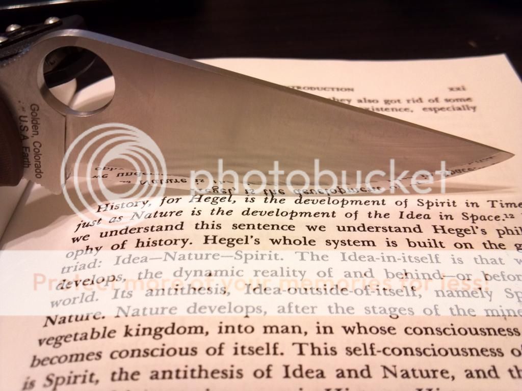

I take a lot of my knives down to 10 degrees per side (20 inclusive) bevels with a 12.5 - 15 degrees per side (25 - 30 inclusive) microbevel. They cut cardboard better than box cutters because of how thin they are behind the edge:

I bet that is stupidly sharp and an incredible cutter! How tough is the edge at that point? Is it still usable for things like lighter outdoors work?

I've whittled soft wood (I'm pretty terrible at whittling) and I didn't find any chipping or rolling afterwards. I've deboned chickens with it and it holds up fine.
Sure, it's not as tough as a 20 degree per side (40 inclusive) edge, but since it is so acute a lot less force is required to make cuts. I'd be nervous of going any lower.
I took a ZDP-189 Caly 3 to 8 degrees per side (16 inclusive) and I could roll the edge by pushing sideways on it with my fingernail. When cutting, though, I didn't have any issues--though, admittedly, I wasn't batonning with it or anything like that.
