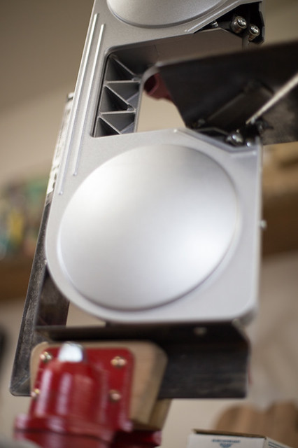

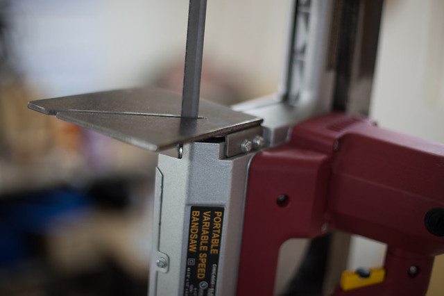

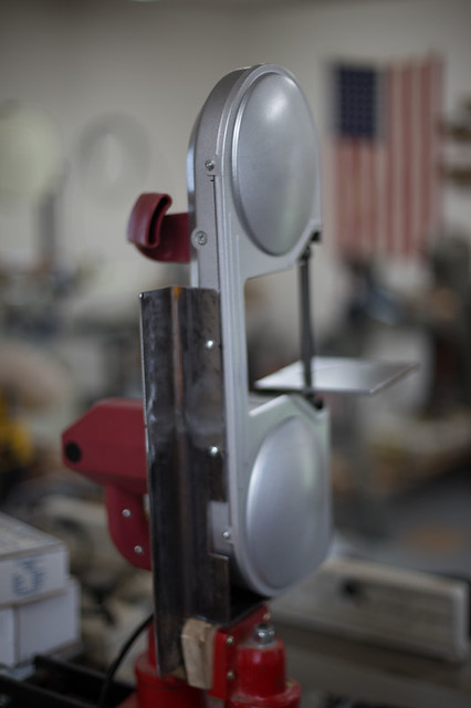

Thanks again for all the input, everyone. I bought a HF band saw on sale and welded up a metal bracket to hold it in the vise and another metal plate to give me a slightly larger working area - thought y'all (that's Texas for you all) might want to see what I rigged up.
I do all my roughing out on a portaband with a little clamp on table I made.
